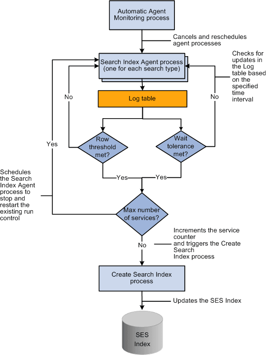

The Agent Process
Agent processes monitor data changes and determine the best time to trigger the Create Search Index program to update the search index. You enable agents for PeopleSoft Resource Management search types (RSFSR and RSRSR) on the Search Settings page. The system creates one agent for each search type that you enable on the Search Settings page.
The Search Index Agent process has no run control page. The agent creates a run control ID for the Create Search Index program when it triggers the process. The run control ID is a concatenation of the search type code and language code. If this run control ID already exists when the agent starts, the system deletes the existing run control and creates a new one by using the same run control ID and the updated run control options. The agent uses the same process instance ID as the Create Search Index program that it triggers. If the Create Search Index program fails, the agent process also fails.
Administrators use the Search Index Agent Manager page to view the status of agent processes, and start and stop agent processes. Agent processes can be in a status of:
Running (RUN)
Starting (STAR)
Stopping (STOP)
Stopped (END)
Time Out (TOUT)
The Daemon Process
The daemon process monitors the status of the agents, and cancels and reschedules any inactive processes. An inactive agent process is one that does not have an end status but has shown no activity for a period of two sleep intervals plus two minutes. The sleep interval is defined in seconds in the Sleep Interval (secs) field on the Search Settings page.
Process Flow
This diagram shows the relationship between the Automatic Agent Monitoring, Search Index Agent, and Create Search Index processes:

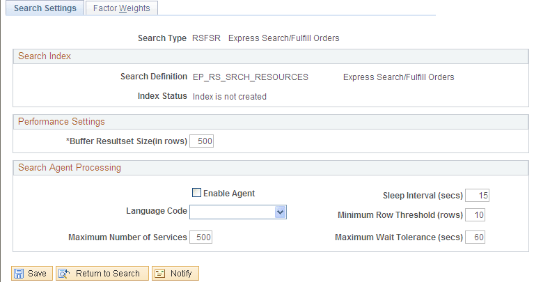

Use the Search Settings page (RS_SEARCH_CONFIG) to configure parameters for the Search Framework.
Navigation:
This example illustrates the fields and controls on the Search Setting Page. You can find definitions for the fields and controls later on this page.
Field or Control |
Description |
Search Type |
Displays the type of search that you selected on the Search Configuration search page:
Performance Settings
Field or Control |
Description |
Buffer Resultset Size (in rows) |
Enter a value that determines the size of the result set. The buffer result set size determines the number of documents that Search Framework will fetch during each search. This result set may differ from the actual result set shown on the page. The primary reason for this is because the availability calculation occurs after the search is complete, and this calculation occurs only for the items that Search Framework returns. Therefore, if you specify a large buffer result set size, you have less of a possibility of missing an item in the result set that is more available than other items in the result set that appear on the page. The disadvantage of increasing the buffer result set size is that the system will calculate availability on more items, which can adversely affect system performance. PeopleSoft Resource Management delivers default values of 500 for the forward search and 300 for the reverse search. You determine the correct balance between accuracy and performance based on the needs of your organization. |
Note: You must also set the Maximum Number of Results in the Oracle Search Framework Administration Console. It should be larger than the maximum search result set desired on the search pages and greater than the largest Buffer Result set Size in the Search Configuration component.
Search Agent Processing
Field or Control |
Description |
Enable Agent |
Select to enable the Search Index Agent process for this search type. When you select this option, a row appears on the Search Agent Index Manager page that enables you to stop and start the agent. The default value is deselected. You enable a separate agent for each search type. |
The remaining fields in the group box are required if you select the Enable Agent option.
Field or Control |
Description |
Sleep Interval (secs) |
Enter the frequency with which the Search Index Agent process checks for updates in the Resource Management Log table (RS_SRCH_LOG). |
Language Code |
All Languages: Select for the Create Search Index program to update all installed languages on each run. This option appears only if you installed multiple languages. Select a specific language for the Create Search Index program to update only one language. Only installed languages are available for selection. Warning! If you installed multiple languages and only select one language in this field for the Create Search Index program to update, the search data for all other languages will be outdated in the system until the next time that you create the full index. This is because the Resource Management Log table is cleared of all previous changes each time the Create Search Index program runs. |
Minimum Row Threshold (rows) |
Enter the minimum number of rows needed to trigger the Create Search Index program. |
Maximum Number of Services |
Enter the maximum number of times that the agent will cycle through the sleep interval before rescheduling itself and then shutting itself down. The agent increments a counter (SVC_COUNTER) by one every time that it completes an interval. When the counter is equal to the value that you specify in this field, the agent schedules itself to start again, and then ends the current process. |
Maximum Wait Tolerance (secs) |
Enter the maximum amount of time that a row of data waits before it is updated in the Search Framework collection by the Create Search Index program. |
All of the fields in the Search Agent Processing group box are disabled when the agent is in a status of Running, Stopping, or Starting. If the agent fails or is canceled, the fields remain disabled until an administrator accesses the Search Index Agent Manager page to change the run status to Time Out. The fields in this group box are available when the run status is Time Out

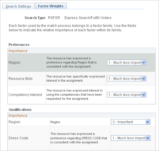

Use the Factor Weights page (RS_SRCH_FACT_WGHT) to define the relative importance of each factor within its family.
Navigation:
This example illustrates the fields and controls on the Factor Weights page. You can find definitions for the fields and controls later on this page.
Field or Control |
Description |
Preferences and Qualifications |
Enter the relative importance of each individual factor in the Resource Matching calculation of the Preference and Qualifications factor family fit scores. Available values are: 0 - Not at all important 1 - Much less important 2 - Less important 3 - Important 4 - More important 5 - Much more important |

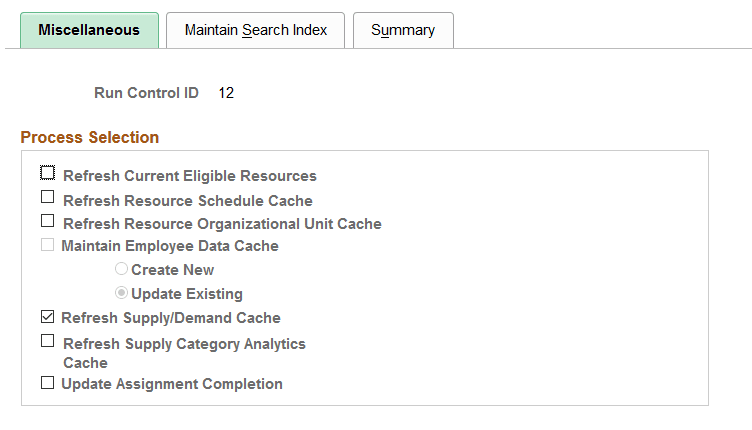

Use the Cache Administration - Miscellaneous page ( RS_CACHE_MISC) to specify processes to refresh cache tables
Navigation:
This example illustrates the fields and controls on the Cache Administration — Miscellaneous Page. You can find definitions for the fields and controls later on this page.
Field or Control |
Description |
Refresh Resource Organizational Unit Cache |
Select to update the Resource Organizational Unit Cache table (RS_WORKER_ORG) that stores organization information from the specified organization tree. The program is required when:
Run this program nightly. |
Update Assignment Calendar |
This check box is available only if the Synchronous Calendar Update check box is not selected in the Resource Management Installation page. Select this option to invoke the calendar update process (RS_APPTUPD). This creates or updates the calendar entries for all the assignments in Assigned, Pending Approval and Reserved status for which the calendar entries were not created or updated. |
Refresh Resource Schedule Cache |
Select to update the Resource Schedule Cache table (RS_DF_WRKR_DATE) that is used to track a resource's schedule. The program purges old availability date and ineligible resource data. This program runs automatically for a resource when the resource's schedule changes. Run the program manually for all resources as required. It is required when:
Note: There is an effect on resource calendars and availability if you change the Do not schedule assignments on Holidays installation option. After you change this option, you must run these two processes in this order: Holiday Load process and Cache Administration - Refresh Resource Schedule Cache. |
Refresh Current Eligible Resources |
Select to update the Eligible Resource Cache table (RS_ELGBL_WRKR) with current eligible resource information. In addition to tracking the current, eligible resources, the table stores the resource's job-related information such as job code, location, and bill rate. The program is required when:
Run this program nightly and as required. |
Maintain Employee Data Cache |
This field does not apply to PeopleSoft Resource Management. |
Refresh Supply/Demand Cache |
Select to update the cache tables for both supply and demand. The system triggers a message to update the Supply Cache table (RS_SUP_CACH) when you establish employees as resources and add them to resource pools in PeopleSoft Resource Management, and when resources are removed or inactivated. You must update the Demand Cache table (RS_DMD_CACH) when new generic resource requests are created and when new resource assignments are created in PeopleSoft Program Management. Note: Application messages automatically update the resource supply and project demand information in near real time. The application messages are delivered inactive. You must activate the message to update the cache tables at run time. The messages are RS_DMD_CACHE_SYNC and RS_SUP_CACH_SYNC. |
Refresh Supply Category Analytics Cache |
Select to update the RS_POOLRES_DATE and RS_GENRES_TMP cache tables for supply category analytics for all resources. |
Update Assignment Completion |
Select to automatically complete or cancel all resource assignments with an end date prior to the date the process is run. The system will also add the processed assignments to the resource history list. Note: All resource assignments with an Active status will be set to Complete. All resource assignments with a status of Interview, Propose, Reserve or Pending Approval will be set to Cancel. |
Save |
Click to save the run control, or select Miscellaneous, or Summary to access other Cache Administration pages. |

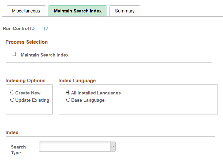

Use the Cache Administration - Maintain Search Index page (RS_SRCH_INDEX) to capture the parameters needed to create the search index files.
Navigation:
This example illustrates the fields and controls on the Cache Administration - Maintain Search Index page . You can find definitions for the fields and controls later on this page.

Maintain Search Index |
Select to create, update the search index as part of this Cache Administration run control. |
Note: Optimize Indexes feature has been removed from the Maintain Search Index page. It is now maintained centrally within the Search Framework. See the product documentation for PeopleTools: Search TechnologyAdministering PeopleSoft Search Framework, Administering Search Definitions and Search Categories.
Indexing Options
Field or Control |
Description |
Create New |
Select this option and run the process as often as you want to refresh the search index with current database information. This option deletes the existing index and creates a new one. Use this option to routinely replace the search index. |
Update Existing |
Select to update the existing index without deleting it by inserting new documents and updating documents that changed since the last time the update process ran. |
Note: This page provides one option for scheduling search index updates. Alternatively, you can enable the Search Index Agent process to monitor data changes and automatically trigger the Create Search Index program to update the search index.
Index Language
Specify whether the index should be created for all installed languages or a base language.
Field or Control |
Description |
All Installed Languages |
Select to create a collection for each installed language. |
Base Language |
Select to specify just the base language Warning! If you installed multiple languages and only select base language for the Create Search Index program to update, the search data for all other languages will be outdated in the system until the next time that you create the full index. This is because the Resource Management Log table is cleared of all previous changes each time the Create Search Index program runs. |
Index
Field or Control |
Description |
Search Type |
Enter a search type of Express Search/Fulfill Orders or Job Spy and Manage Utilization to create an index for searches in PeopleSoft Resource Management. Note: Before you can run the Cache Administration process you must first deploy the search definition corresponding to the search type selected. Use the Deploy Search Definition page to deploy the search definition to the Search server. The search definition must be deployed before building the index for the first time. Navigation - PeopleTools, Search Framework, Administration, Deploy/Delete Object. |
Save |
Click Save to save the run control, or select Miscellaneous, or Summary to access other Cache Administration pages. |

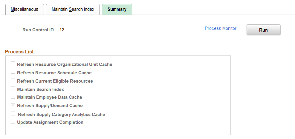

Use the Cache Administration - Summary page (RS_CACHE_SUMMARY) to confirm the list of processes that you want to run or schedule for the future.
Navigation:
This example illustrates the fields and controls on the Cache Administration – Summary page. You can find definitions for the fields and controls later on this page.
Field or Control |
Description |
Run |
Click to save the run control and proceed to the Process Scheduler Request page to run the program or schedule it to run later. |
Save |
Click to save the run control but not run the program. |

Use the Search Index Agent Manager page (FO_AGENT_MGR) to view, start, and stop agent processes.
Navigation:
This example illustrates the fields and controls on the Search Index Agent Manager page. You can find definitions for the fields and controls later on this page.
Field or Control |
Description |
Run Status |
Displays the agent run status of Error, Running, Starting, Stopping, Stopped, or Time Out. |
Process Instance |
Displays the process instance ID of the running agent process. This same process instance ID is used by the Create Search Index program that is invoked by the agent. When you click the Start button to start the agent, and the previous run status is Time Out, the agent cancels the previous process instance ID and assigns a new one. |
Last Run On |
Displays the last time that the agent triggered the Create Search Index program. |
Last Activity |
Displays the last time that the agent checked the Resource Management Log table to determine if any action was necessary. |
Start |
Click to start the agent and create a new process instance ID if the previous run status was Time Out. |
Stop |
Click to stop the agent. This button is disabled if the run status is Stop or Time Out. |
Refresh |
Click to trigger the Search Index Agent process to:
Warning! Do not manually change the run control record for the Create Search Index program while the Search Index Agent process is running. Doing so will result in inconsistent search data because the Create Index Agent process will update different data than is specified for the agent.
