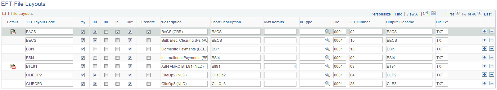

Use the EFT File Layouts page (EFT_LAYOUT) to view, modify, and add EFT layouts.
Navigation:
This example illustrates the fields and controls on the EFT File Layouts page. You can find definitions for the fields and controls later on this page.
The options next to the EFT Layout Code field determine the purpose of the EFT file, where applicable.
Field or Control |
Description |
Pay |
Select if the file layout is for payment files. |
DD |
Select if the file layout is for direct debits. |
DR |
Select if the file layout is for draft files. |
In |
Select if the file layout is for inbound files. |
Out |
Select if the file layout is for outbound files. |
Prenote |
Select if the file layout is for a prenote. |
The remaining fields are:
Field or Control |
Description |
Federal Payment Indicator |
Indicates that an EFT layout is applicable for federal payments. When a voucher is saved, the system verifies that the correct payment format is selected for the vendor/supplier type bank account. Note: This field is visible only when Enable Federal Payment is selected on the Installation Options - Payables page. Select from these options: Employee: You must associate employee vendor/supplier payment methods with a valid PPD or PPD+ EFT file layout. Delivered valid file layouts are SPSTRVL, SPSTRVLSDA, PAMTRVLSDA, SF116TRVL, and SPSIATTRVL. Supplier: You must associate all other vendor/supplier (non-employee) payment methods with a valid CCD or CTX EFT file layout. Delivered valid file layouts are SPSVNDR, SPSVNDRSDA, PAMVNDRSDA, SPSMISC, SPSMISCSDA, PAMMISCSDA, SPSIATVNDR, SPSIATMISC, SF1166VNDR, CTX, and CTX820FED. Both: For employee and vendor/supplier payments. You must associate this option with a valid PPD or PPD+ EFT file layout. Delivered valid file layouts are SPSCHK, SDPR, and SF1166SCHK. For delivered valid layouts, see Understanding U.S. Federal ACH and EFT Layouts in this topic. |
Max Remits (maximum remittances) |
Use to limit the number of invoices that are included on each payment to the specified number. |
ID Type |
Enter the type of identification number to identify the trading partners on the EFT file. You enter these different types of identification numbers when you set up business units, customers, and suppliers. |

Click Detail for the ETEBAC EFT file layout on the EFT File Layouts page.

If you do not use any of the delivered EFT layouts in your country, you can develop your own EFT layout. To do this, you must first add the new EFT layout and its options to the list of available EFT layouts using the EFT File Layouts page (EFT_LAYOUT). After you add a new EFT layout, you need to create an SQR module for the file layout that you added. The module that you create will be an SQR Copybook, which has a file extension of SQC.
The files that you require are provided on the system for modification. The FINEFTxx.SQC script, which is shipped with Payables, Receivables, Expenses, and Cash Management, is a template that you can configure to meet your current requirements. In addition, you also need to make changes to the FINEFT.SQC file. This file acts as a router that directs the Pay Cycle process to the appropriate SQC based on the current EFT file layout requirement.
The FINEFTxx.SQC template assumes that one output file is created for each bank account.
File Naming Conventions for EFT Files
The payment process uses these conventions to name the EFT output files: xxxxxnnn.ttt (for example BACS002.txt).

You define these values on the EFT File Layouts Page.
