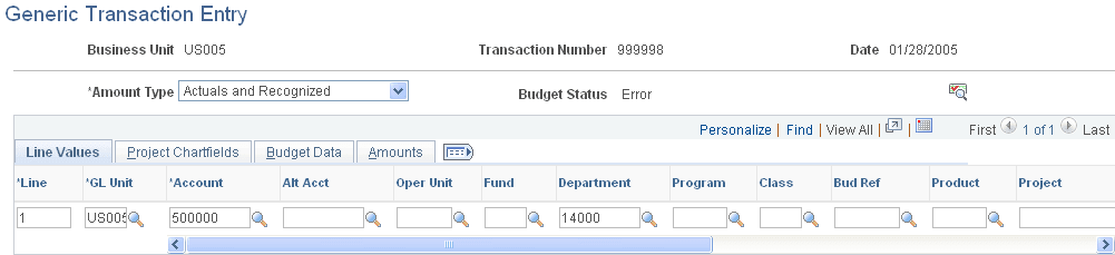

Use the Generic Transaction Entry page (KK_GEN_TRANS_ENTRY) to review and update source transactions that you have loaded from a third-party application.
You also have access to the Commitment Control page where you can initiate and override budget checking for the entire transaction.

This example illustrates the fields and controls on the Generic Transaction Entry page. You can find definitions for the fields and controls later on this page.
Field or Control |
Description |
Amount Type |
Select a Commitment Control amount type. Important! If the transaction contains a line whose account value does not belong in the ledger represented by the amount type that you selected (such as a revenue transaction line when you have selected an amount type of Encumbrance), the budget processor does not process the line and does not update the Commitment Control ledger data table for the line. |

Click the Budget Check Options button to access the Commitment Control page, where you can view details about the transaction, such as the budget checking status and the amount type for the transaction. You can also override budget checking for the transaction or run the budget processor for the transaction. |
GL Unit (general ledger unit) |
Enter the PeopleSoft General Ledger business unit. |
Rate Type |
Displays the rate type used to convert the original amount if the line amount is in a different currency from that of the business unit. |
Stat (statistics code) |
User-defined value that identifies the type of unit you are tracking. Appears only for budget definitions with statistical budgeting enabled. |
Stat Amt (statistical amount) |
Number of statistical units. |
Note: Use this page only to review and apply simple transaction updates that have been loaded through the Budget Check / Request Integration Point. This page provides minimal editing and data validation.
