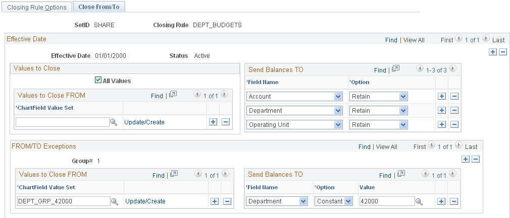

Use the Close From/To page (KK_CLOSE_DEFN2) to specify the ChartField values to be closed and the ChartFields and values to which the balances are rolled forward.
Navigation:
Commitment Control, Close Budget, Define Closing Rule, Close From/To
This example illustrates the fields and controls on the Close From/To page. You can find definitions for the fields and controls later on this page.
Note: No budget should appear in more than one ChartField value set. To avoid overlapping budgets, the ChartField value sets that you enter in the Values to Close group box should share the same ChartFields. They may have ChartFields in addition to those they share; for example, if one ChartField value set in a closing rule includes Department and Project, then another can include Department, Project, and Product. But if instead one ChartField value set includes Product and Project but not Department, the sets could overlap each other. The same is true for the ChartField value sets that you enter for each group number in the FROM/TO Exceptions scroll area.

Send Balances TO
If you set the Balance Forward Option on the Define Closing Rule - Closing Options page to roll forward balances, specify how you want the closing balances to roll forward: to budgets that share the same ChartField values as the budgets being closed or to budgets with one or more different ChartField values.
Note: Leave this and subsequent sections blank if you selected Close Out Only in the Balance Forward Option field on the Closing Rule Options page.
Field or Control |
Description |
Field Name |
Enter the ChartFields for which you want to specify roll forward options. Note: Include all key ChartFields for the budgets you are rolling forward to, or the missing ChartFields cause the budget journal posting to fail. |
Option |
Indicate whether to retain the ChartField values of budgets being closed in the target budget period or to roll the budget balances forward to a target budget with a constant ChartField value. If you select Constant, you must enter a value in the Field Name field. For example, if you are closing budget year 2001 and want all balances to roll forward to 2002 budgets with accounts, departments, and funds that are identical to those being closed, select Retain for those ChartFields in the ChartField value set. If, on the other hand, you want all balances rolled forward to budgets for, let's say, a general fund, you would retain the account and department ChartField values, select a roll forward option of Constant for fund code, and enter the fund code for the general fund. Note: Do not specify the target, or roll forward, budget periods here. Specify the target budget periods in the budget period set. |
FROM/TO Exceptions
Enter ChartField value sets for budgets whose roll forward options (as entered in Send Balances TO) are different from those of the ChartField value sets in the Values to Close From group box.
For example, on the sample Close From/To page, all ChartField values and therefore all budgets using this closing rule have their balances rolled forward to budgets with the same Account, Department, and Fund Code values, except those budgets covered in ChartField value sets DEPT_MANU_DIV, whose balances roll forward to budgets with Fund Code, F100 and DEPT_ADMIN_DIV, whose balances roll forward to Department 14000.
Field or Control |
Description |
Group# |
Each FROM and TO combination comprises a group of ChartField value sets to be closed (in the Values to Close FROM scroll area) and the specific set of ChartFields and values to which the balance are rolled forward (in the Send Balances TO scroll area). These scroll areas contain the same fields as the scroll area in the Values to Close group box and the Send Balances TO scroll area, and they function in the same way. |
