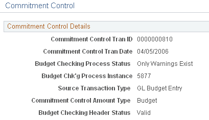

Use the Commitment Control Details page (KK_XCP_TRAN_SEC) to shows budget check details (such as process instance, errors exist, or only warnings ).
Navigation:
Click the Budget Check Details button on the Budget Journal Exceptions page to access the Commitment Control Details page.
This example illustrates the fields and controls on the Commitment Control Details page. You can find definitions for the fields and controls later on this page.
This page is accessed from the Budget Journal Exceptions page. It displays the details of the budget journal associated with the budget line exception.

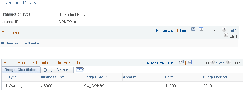

Access the Exception Details page (click the magnifying glass with the plus sign for a particular line on the Budget Journal Line Exceptions page).
This example illustrates the fields and controls on the Exceptions Details page.
Accessed from the Budget Journal Line Exceptions page, this page displays the exceptions associated with a particular journal line and the associated exceptions with the budget ChartFields and any budget overrides applied.
