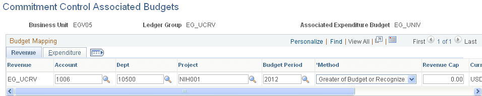

This example illustrates the fields and controls on the Commitment Control Associated Budgets page - Revenue tab. You can find definitions for the fields and controls later on this page.
Note: Because each pair of associated revenue and expenditure budgets appears on the same line, use the expanded (as opposed to the tabbed) Budget Mapping grid to ensure that you map the proper revenue budget to the correct expenditure budget.

Revenue tab |
A column exists for each of the revenue ledger group's key ChartFields. Enter the ChartField values and budget period that designate the revenue budget that increases the available budget balance for the associated expenditure budget. You can enter the same revenue budget more than once if you want it to increase the available budget balance for more than one expenditure budget. |
Method |
Select whether the revenue is to be made available for spending when it is Budgeted, Collected, or Recognized. You can also select one the following values:
Note: You can use the same revenue ChartField combination to fund multiple expenditures and the revenue method can be different for each association. The only requirement is that the sum of the revenue percentages cannot exceed 100 percent for any given revenue ChartField combination. |

Revenue Cap |
The maximum amount of the revenue budget that is available for spending. |
Percentage |
The percentage of the revenue budget that is available for spending. You can enter a percentage and a cap to indicate that a percentage of the revenue budget is available, but only up to the cap. If no amount is entered as a cap, the system assumes that the ceiling is 0.00, which implies no revenue funds are available for that expenditure budget. The page validates that the total percentage across all rows for a single revenue budget does not exceed 100. |
