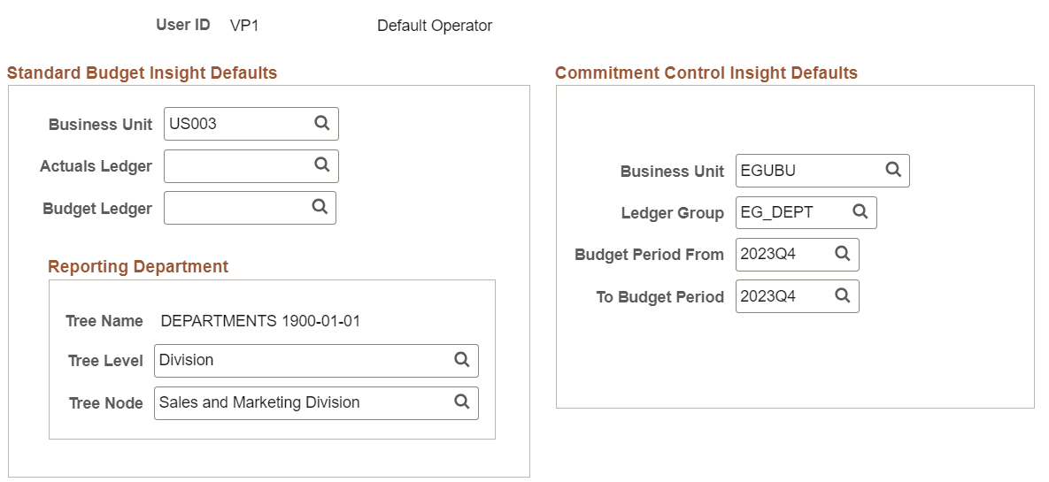

Use the Insights Preferences page (GL_K_USER_DEFAILTS) to configure user defaults that are used when accessing dashboards for Commitment Control.
Navigation:
. Select the Insights Preferences link.
This example illustrates the Insights Preferences page.
This page displays the filters used when accessing a General Ledger and Commitment Control Insights dashboard from a tile. Enter a default value for the user. The default value is used when the user accesses the Insights dashboard from a tile. The user can change the values for the session in the dashboard page.

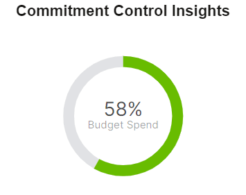

PeopleSoft Commitment Control has the Commitment Control Insights tile associated with Insights dashboards.
For additional information about how to add a tile to a PeopleSoft Fluid Home page, see Adding Homepages and Tiles and PeopleTools: Application User’s Guide, “Working With PeopleSoft Fluid User Interface”, Working with Fluid Homepages and Dashboards, Managing Tiles on Fluid Homepages and Dashboards.
This example illustrates the Commitment Control Insights tile.
