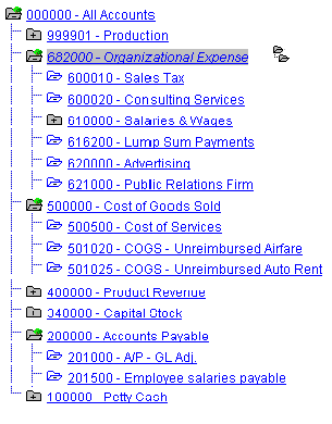

The following is an excerpt from the BUD_ACCOUNT ChartField tree for this example:
Accounts ChartField Tree Excerpt

Your security rule would apply to the budgets whose ChartField values appear in italics in the table.
