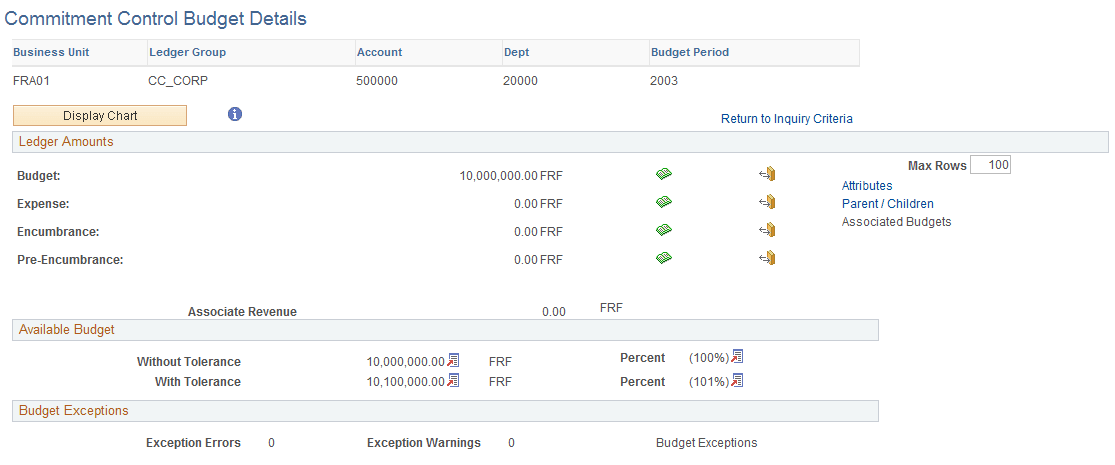

Use the Commitment Control Budget Details page (KK_INQ_BDT_STATUS) to specify budget detail search criteria and select a row to view specific budget detail for a control budget.
Navigation:
You can also access the Commitment Control Budget Details page (Click the Show Budget Details button for a ledger row on the Budgets Overview - Inquiry Results page or the Individual Budgets page).
This example illustrates the fields and controls on the Commitment control Budget Details page. You can find definitions for the fields and controls later on this page.

Ledger Amounts
Field or Control |
Description |
Click Drill to Ledger to access the Ledger page (KK_DRL_LDGR_SEC.) By clicking Drill to Ledger for any of the other ledger amounts, such as expense, encumbrance, or pre-encumbrance, on the Commitment Control Budget Details page, you can access their related Ledger page. |
Click Drill to Activity Log on the Commitment Control Budget Details page to display the budget activity lines on the Activity Log page. These lines consist of the budget ChartFields and amounts for each budget activity. |
Click the View Related Links button on the particular source entry drill down page (such as, voucher, PO, or requisition) to access the actual source entry page such as the Maintain Requisitions - Requisition page or the source inquiry page such as the Requisition Inquiry page. Note: The activity log page also enables you to inquire on and drill to budget transaction activity. |
Attributes |
Click to open the Budget Detail Attributes page, where you can view the budget status, Commitment Control option, begin and end dates, and budget tolerance for the control budget. |
Parent/Children |
Click to open the Parent & Children Budgets page, where you can view ledger information for the child and parent budgets of this budget. This link is unavailable if the budget has no parent or child budgets defined for it. |
Associated Budgets |
Click to open the Associated Revenue Budgets page or the Associated Expense Budget page, where you can view the ChartField values and budget amounts for associated revenue or expense budgets. This link is unavailable if there are no revenue or expense budgets associated with this budget. |
Max Rows (maximum rows) |
Enter the number of lines that you prefer to see when you drill down to the ledger or the activity logs. The default value is 100 lines. You can resolve possible issues with processing time outs by observing the system-issued messages and adjusting the maximum rows correspondingly. |
Available Budget
This group box indicates the amount of the budget that is still available, including associated revenue. The ledger group definition specifies which ledgers affect spending or the available budget.
Field or Control |
Description |
Without Tolerance |
The total amount available, excluding the tolerance percentage. For example, if the total budget is 1000 and you have committed or expended 900, the amount available would be 100. When you click the View Related Links button, the calculation method used for this figure displays. Percent displays the percentage of the budget available. When you click the View Related Links button, the calculation method used for this percentage displays. |
With Tolerance |
The total amount available including the tolerance percentage. For example, if the total budget is 1000, you have committed or expended 1010, and the tolerance percentage is 10 percent, the amount available would be 90. |
View the formula used for the system calculation of the Without Tolerance field and With Tolerance field amounts and their percentages. |
Forecasts |
Click this link to open the Budget Forecast Amounts page, where you can view forecast amounts for the budget. This link is available only for current budgets. |
Budget Exceptions
This group box lists the number of errors and warnings that exist for the budget. Click the Budget Exceptions link to open the Budget Exceptions page, where you can view and override exceptions.
Click Drill to Ledger on the Commitment Control Budget Details page to access the Ledger page.
ClickDrill to Activity Log on the Commitment Control Budget Details page to access the Activity Log page.
Click the Associated Budgets link to access associated revenue amounts on the Commitment Control Budget Details page.
Click the Attributes link on the Commitment Control Budget Details page to access the Attributes page.
