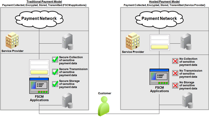

This diagram illustrates a side-by-side comparison of the traditional payment model in FSCM applications and the hosted payment model in which a third-party service provider stores and processes payments.
The following table provides a side-by-side comparison of data storage in the traditional model versus hosted model:
In the traditional credit card model, the following are stored locally: |
In the hosted implementation, the PeopleSoft Order to Cash system stores the following: |
First and last name of the card holder |
Credit Card type |
Credit card type |
Credit card number (encrypted) |
Last four digits of the credit card number |
Expiration month and year |
Payment processor name |
Credit card address |
Phone number |
Email address |
Profile ID |

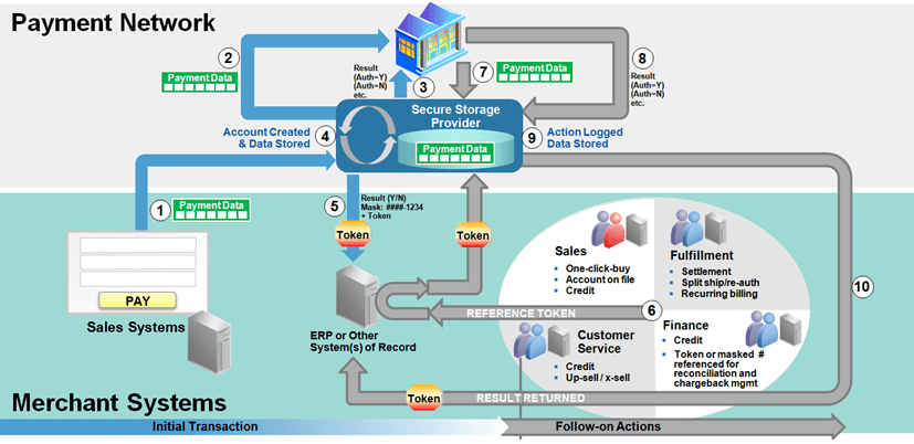

PeopleSoft FSCM provides a framework in the Order to Cash modules (Order Management, Billing, eBill Payment, and Accounts Receivable) to facilitate the collection and processing of payment information by third-party credit card hosts. Businesses with an Order to Cash system can convert from a traditional credit card model (local storage of credit card data) to a hosted model, where a third party hosts or stores credit card data.
This diagram illustrates the pathway of a payment beginning in a merchant system such as PeopleSoft Order to Cash and processed through a third-party payment network. Payment results are referenced by the appearance of tokens between the merchant system and the payment network.

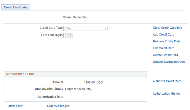

Using Credit Card Action Links in the Hosted Model
In general, the action links appear on the right side of a page that contains credit card data.
This example illustrates the fields and controls on the Credit Card Data page in a system with hosted credit card processing.
This example illustrates the fields and controls on the Payment Confirmation: Enter Credit Card Info page in a hosted credit card implementation.
Field or Control |
Description |
Clear Credit Card Info |
Click this link to clear the data existing in fields that appear on the page. This action does not affect stored credit card data. |
Use Primary Card |
Click this link to populate the Credit Card Information fields with card type and last four digits using the primary credit card as designated in this contact’s profile for a customer. |
Select Credit Card |
Click this link to open the Credit Card Selection page, which lists credit cards associated with this customer contact. This link is available if the contact has at least one saved temporary credit card profile. |
Add Credit Card |
Click this link to add data for a new credit card. This link transfers you to the third-party supplier set up for payment storage and processing in the hosted model. You enter credit card information on the hosted page, which is pre-populated with the customer contact’s billing information. |
Review Profile Data |
Click this link to send a request to the hosted site to retrieve profile data and then display it on the PeopleSoft page. Retrieved profile data is display-only. This link is available when the credit card type and last four digits appear on the page. |
Edit Credit Card |
Click this link to transfer to the hosted Website, where the customer contact can edit the card information. This link is available when the credit card type and last four digits appear on the page. |
Delete Credit Card |
Click this link to delete a credit card profile associated with this customer contact. If the profile is not used in any pending transaction, a background request deletes the profile in the hosted site. This link is available when the credit card type and last four digits appear on the page. |
Update Expiration Dates |
Click this link to update expiration month and year without transferring to the hosted site. When you enter the new expiration date, a background process updates the hosted site. This link is available when the credit card type and last four digits appear on the page. |

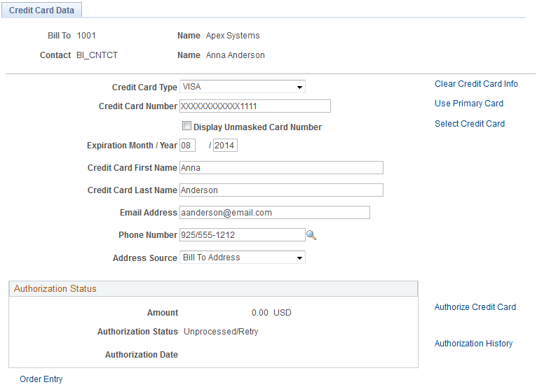

Using Credit Card Action Links in the Traditional Model
This example illustrates the fields and controls on the Credit Card Data page in Order Management, using the traditional credit card model. You can find definitions for the fields and controls later on this page.
Field or Control |
Description |
Click this link to clear the data existing in fields showing on the page. This action does not affect stored credit card data. |
Use Primary Card |
Click this link to populate the Credit Card Information fields with data using the primary credit card as designated in this contact’s profile for a customer. |
Click this link to open the Credit Card Selection page, which lists credit cards associated with this customer contact. This link is available if the contact has at least one saved permanent credit card stored in the system. |
Authorize Credit Card |
Click this link to authorize payment on this credit card. |
Authorization History |
Click this link to review the authorization history for this credit card. |
