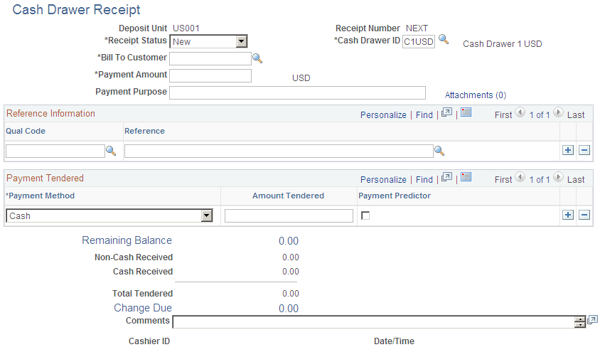

Use the Cash Drawer Receipt page (CDR_RECEIPT) to create a receipt for payment from a customer.
Navigation:
This example illustrates the fields and controls on the Cash Drawer Receipt page. You can find definitions for the fields and controls later on this page.
Note: You can view only those receipts that are in a status of New, Hold, or Canceled.
Field or Control |
Description |
Deposit Unit |
View the Accounts Receivable business unit that was entered by the cashier on the Add page. |
Receipt No (receipt number) |
View a unique value that is automatically generated at save time. This number is unique within business units. |
Receipt Status |
Select from these options: New: The default status of a receipt once it is created. When the receipt is in a New status, all fields on the receipt are editable. The cashier can update this status to Hold. Printed: The status of a printed receipt. You can edit these fields on a receipt when it is in Printed status: Payment Method, Comments, Cash Drawer, and Check Number. Reconciled: Once the cash drawer that is associated with the receipt has been reconciled, the status is automatically updated from Printed to Reconciled. At this time, you cannot update the receipt information. Canceled: If a receipt was entered by mistake, you can mark it as Cancelled. Canceled receipts are not included in the Cash Drawer reconciliation process. A cashier can update a receipt in Canceled status to a status of New or Hold. The ability to cancel a receipt is controlled by feature function security. See .Understanding Feature Function Security Hold: If you must temporarily exclude a receipt from the cash drawer reconciliation process, then save the receipt with a Hold status. You can then print the receipt if necessary. However, after printing, the status will remain in a Hold status instead of automatically getting set to Printed. The Hold status enables the cashier to handle the payment method "unknown" scenario for cash on delivery (COD) scenarios in which a receipt must be provided to the customer on delivery of goods. Cashiers can update a Hold status to a status of New, Printed, or Canceled. |
Cash Drawer BU (cash drawer business unit) |
View the business unit of the cash drawer. This value appears automatically from Order Management user preferences. |
Drawer BU Type (drawer business unit type) |
View the business unit type of the cash drawer: OM (Order Management) or AR (Accounts Receivable). |
Cash Drawer ID |
View the value selected by the cashier. The list of valid drawers is determined by the Cash Drawer by User setup and displayed from the defaults specified on the PeopleSoft Order Management User Preferences page. |
Bill To Customer |
View the ID of the customer who made the payment. |
Currency |
View the currency defined by default for the cash drawer definition. This is a read-only field. |
Payment Amount |
View the total amount that is received from the customer. This amount is entered by the cashier. It might be the total amount of a sale, including taxes. |
Payment Purpose |
Describe the purpose of the receipt or reason for collecting the payment. For example, you might describe an item or service sold as Payment in advance of an invoice. |
Payment Method |
View the method entered by the cashier: Cash, Check, Credit Card, or Debit Card. |
Amount Tendered |
View the amount of money received by the customer for each payment method, as entered by the cashier. |
Payment Predictor |
Select this check box to use Payment Predictor for this payment method. |
Non-cash Received |
View the sum of the Amount Tendered column for all noncash payments. This is a system-generated amount. |
Cash Received |
View the amount of cash received. If a row is in the grid for cash, then the value in this field is equal to the amount tendered of the row. This is a system-generated amount. |
Total Tendered |
View the sum of the noncash received + cash received (or a sum of amount tendered of all rows in the grid). This is a system-generated amount. |
Remaining Balance |
View how much more is due by the customer if multiple payment methods are entered into the grid. Once you enter all payment methods and amounts, the value in the Remaining Balance field is 0. This is a system-generated amount. |
Change Due |
View the amount of change due, which is calculated by subtracting the payment amount from the total tendered. This is a system-generated amount. |
Comments |
View the comments that the cashier entered. This is a free-form 256-character field. |
Cashier ID |
View the user ID of the cashier. |
Date/Time |
View the current date and time. |

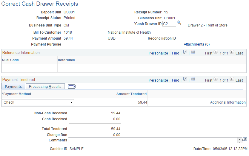

Use the Correct Cash Drawer Receipts page (CDR_RECEIPT_INQ) to correct certain fields of a cash drawer receipt.
You can edit receipts using this component, however, fewer fields are available for correction on receipts that are in a Printed status.
Navigation:
This example illustrates the fields and controls on the Correct Cash Drawer Receipts page.
Once a receipt is printed, you can edit only these fields: Payment Method, Cash Drawer ID, Check Number, and Comments. To edit the check number, click the Additional Information link on the Payment Tendered - Payments tab.
However, the system does not allow some payment method changes. The system enforces the payment method changes that are acceptable.

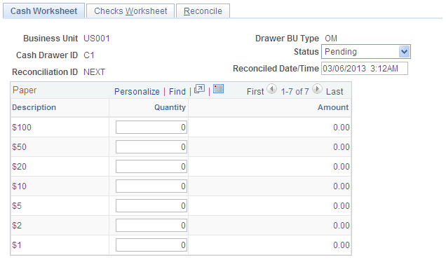

Use the Cash Worksheet page (CDR_RECON_CASH) to enter the actual cash counted from the drawer.
This page is optional; you can bypass it to enter the actual cash count on the Reconcile tab.
Navigation:
This example illustrates the fields and controls on the Cash Worksheet page (1 of 2). You can find definitions for the fields and controls later on this page.
This example illustrates the fields and controls on the Cash Worksheet page (2 of 2). You can find definitions for the fields and controls later on this page.
You should reconcile cash drawers periodically to compare the system-entered receipts against the physical money in a cash drawer. The reconciliation process compares actual cash and checks for a given drawer. It does not include any card transaction for comparison to actual totals. You should reconcile card transactions as a separate business process.
Initiate a cash drawer reconciliation by creating an entry in the Reconcile Cash Drawer component. The system sets the reconciliation date and time to the current date and time. However, you can edit this default date and time. The reconciliation date and time controls which receipts are included for reconciliation. Any receipts with a timestamp after this date and time are not included in the reconciliation process. Receipts dated before are included for reconciliation. A reconciliation can have a Pending, Reconciled, or Canceled status. When a reconciliation is first created, it will have a Pending status, which indicates that the reconciliation is considered a work in progress. You can save it while the drawer is in the process of getting reconciled or while discrepancies are researched. Only one pending reconciliation can exist for a given drawer at any time. After reconciliation, the status of the drawer is set to Reconciled.
Note: The Cash Worksheet page is built dynamically based on the currency defined for the drawer and based on the denominations defined for the currency. The Reconciliation Date/Time field controls which receipts are reconciled.

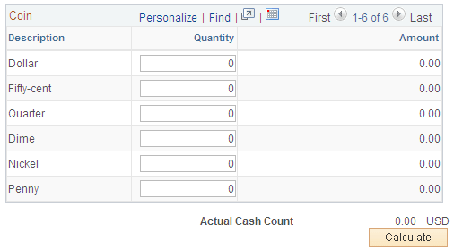

Cash Worksheet
The cashier can complete the Cash Worksheet to help calculate currency totals by denomination and actual cash count. Alternatively, the cashier can skip the Cash Worksheet page and enter the actual cash count on the Reconcile page.
Field or Control |
Description |
Quantity |
Enter a count for each of the paper bills and coins identified in the grid. |
Actual Cash Count |
Click the Calculate button to view the summed amount of the monies identified in the grid. The actual cash count computed on the Cash Worksheet is automatically carried over to the Actual Cash Count field on the Reconcile page. |
