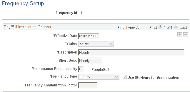

Use the Frequency Setup page (RS_CM_FREQNCY_TBL) to define payroll frequencies.
Navigation:
This example illustrates the fields and controls on the Frequency Setup page. You can find definitions for the fields and controls later on this page.
Note: If you are integrating with PeopleSoft Pay/Bill Management, you establish the frequency information in PeopleSoft HCM, and send it to Financials via application messaging. If this is your situation and you are a system administrator, PeopleSoft recommends that you do not make this page accessible to general users.
Field or Control |
Description |
Maintenance Responsibility |
Select a maintenance responsibility:
Frequency Type |
Select a frequency type, such as: Annual, Hourly, or Daily. |
Use StdHours for Annualization (use standard hours for annualization) |
Select to have the system use job standard hours for annualization instead of the frequency annualization factor. The system sets the frequency annualization factor to 0. After you select this check box and save the page, the Frequency Annualization Factor field becomes unavailable. Note: You can use only hourly frequencies that use standard hours for annualization for compensation and pay frequency in PeopleSoft HCM, PeopleSoft Payroll for North America, and PeopleSoft Global Payroll. The Use StdHours for Annualization check box becomes available after you save the page but only if you select the Hourly frequency type. |
Frequency Annualization Factor |
Enter the number of frequency periods to occur in one year. For example, a Daily compensation frequency is 260 because there are 260 workdays in the year. You can also define a frequency. For example, a frequency ID you name W53 would have a Weekly frequency type and a frequency annualization factor of 53. Warning! If you change the effective status, frequency type, or annualization factor of an existing frequency, you receive a warning message saying that previous calculations using this frequency are not synchronous with the new values of the frequency. |

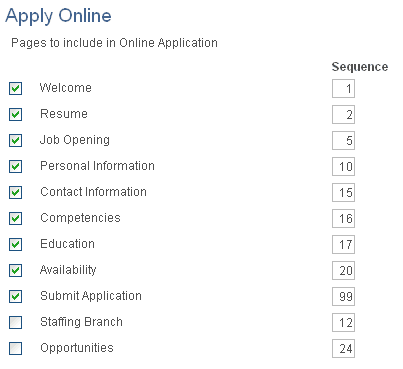

Use the Apply Online page (FO_ESS_OPTIONS) to determine the sequence of pages in the Apply Online component
This example illustrates the fields and controls on the Apply Online Page. You can find definitions for the fields and controls later on this page.
You must select the check boxes for the Welcome Page and the Submit Application page, and these must be ordered first and last, respectively.
Select the check box next to the other pages that you want to include (or deselect those you do not want to include) and indicate the order in which you want them to appear by entering a number that is greater than 1 and less than 99 in the corresponding Sequence column field.
