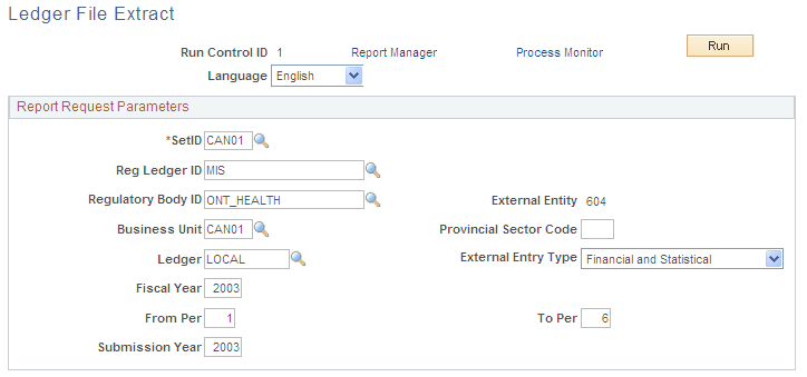

Use the Generate Reg Led File (generate regulatory ledger file) page (RUN_REGLEDFILE) to Create a flat file based on the specifications of the Ontario Ministry of Health, Ontario, Canada and post it to the report repository.
Navigation:
This example illustrates the fields and controls on the Generate Reg Led File page. You can find definitions for the fields and controls later on this page.
The information that you enter on this page is similar to the information that you enter on the Build Reg Ledger page except for the Submission Year field, in which you enter the year as labeled by the regulatory body and included in the regulatory ledger file.
Note: This process is specific to the Canadian healthcare customers. Customers requiring other types of regulatory reporting could use this process as the basis for creating a customized regulatory ledger file generation process that produces the exact file specifications for the non-Canadian healthcare regulatory body.

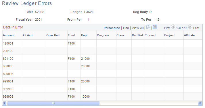

Use the Translation Error page (REG_LEDGER_DATAERR) to list the ledger rows that were not translated into external ChartFields.
This helps identify the problem in order to refine the translation setup.
Navigation:
This example illustrates the fields and controls on the Translation Error page. You can find definitions for the fields and controls later on this page.
This page lists the internal ChartFields and amounts that did not translate amounts to the external ChartFields. The Trans Error Cd column displays the reason why a row could not be translated and indicates what must be changed in the translation setup data to translate the row successfully.

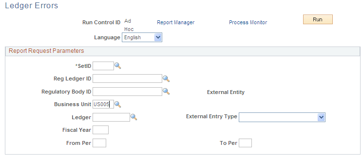

Use the Data Error Report page (RUN_REGLEDERR) to run a BI Publisher report of the Regulatory Ledger Error Inquiry to aid in the correction of translation setup problems.
The BI Publisher report does not require manual changes to support ChartField configuration
Navigation:
This example illustrates the fields and controls on the Data Error Report page. You can find definitions for the fields and controls later on this page.
Note: This page generates the Data Error report (FSX5101 BI Publisher) that lists the internal ChartFields that were not translated.

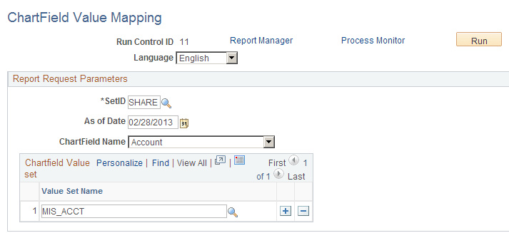

Use the Regulatory Ledger Reports - Chartfield Value Mapping page (RUN_REGLEDCFRPT) to identifies potential problems with the ChartField value mapping definitions on these reports.
Navigation:
This example illustrates the fields and controls on the Regulatory Ledger Reports - Chartfield Value Mapping page. You can find definitions for the fields and controls later on this page.
These reports are useful for finding errors in the ChartField value mapping that you used to map internal ChartField values to target ChartField values for your regulatory reports. The report lists:
ChartField values that are linked to more than one target ChartField value.
ChartField values that are not linked to a target ChartField value.
Enter one or more value set names to limit the information that is included in the report.
Note: This generates the FIN5102.SQR report, which enables you to identify problems for a specific ChartField value set or a range of ChartField value sets.
