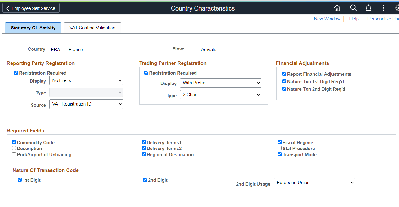

Use the Country Characteristics - Statutory GL Activity page (IST_COUNTRY_TBL) to select the information that individual countries require for Intrastat reports.
Navigation:
This example illustrates the fields and controls on the Country Characteristics - Statutory GL Activity page.
Reporting Party Registration
Field or Control |
Description |
Registration Required |
Indicates that you, as an Intrastat declarant, are required to include your VAT registration ID on Intrastat reporting forms. |
Display |
Indicates if you are required to include a country code prefix for the VAT ID. Options are Prefix and No Prefix. |
Type |
Select a type of country code prefix. |
Source |
The VAT registration ID values include: VAT: The VAT registration number. Local: A local tax ID that some countries use. |
Trading Partner Registration
Field or Control |
Description |
Select to indicate that you must provide your trading partner's VAT registration ID. The partner VAT number is printed on these report: ISTX0050, ISTX0100, and ISTX0200 |
Display |
Select With Prefix if you are required to include a country prefix for the trading partner's VAT ID. This field is only available when the Registration Required check box is selected. |
Type |
Select the prefix type. This field is only available when the Display field has a value. |
Financial Adjustments
Field or Control |
Description |
Report Financial Adjustments |
Indicates that you must report financial adjustments, such as debit and credit notes |
Nature Txn 1st Digit Req'd (nature of transaction first digit required) |
Indicates that reporting rules require that you identify the nature of the transaction for financial adjustments. |
Nature Txn 2nd Digit Req'd (nature of transaction second digit required) |
Indicates that you require the additional detail that is provided by a second set of nature-of-transaction values. |
Required Fields
Select the information to include on the Intrastat report forms. You cannot select both Fiscal Regime and Stat Procedure (statistical procedure). Several of the field labels in the Required Fields group box change depending on the flow that you selected.
Nature of Transaction Code
Field or Control |
Description |
1st Digit |
Indicates that you must provide a nature of transaction code on Intrastat reports for the selected country and flow. |
2nd Digit |
Click this check box to indicate that you require the additional detail that is provided by a second set of nature-of-transaction values. |
2nd Digit Usage |
Select the delivered European Union, or United Kingdom 2nd digit usage identifier. You can also select from this prompt an appropriate usage identifier for a user defined set of 2nd digits if you have previously defined that set for another EU country. When you select a 2nd digit usage identifier option, its value determines which set of 2nd digit values the system uses. |
When you complete this setup, the Nature of Transaction Code values are available for use on the Intrastat-applicable transaction. When entering a transaction, you are prompted for the first and second digits of the Nature of Transaction Code on the Line Detail page. The list of values that are available for the 2nd digit is dependent on the usage identifier that you specify for the Intrastat reporting country, the value that you specify for the first digit, and the set of 2nd digit values that are associated with that 1st digit for that usage identifier

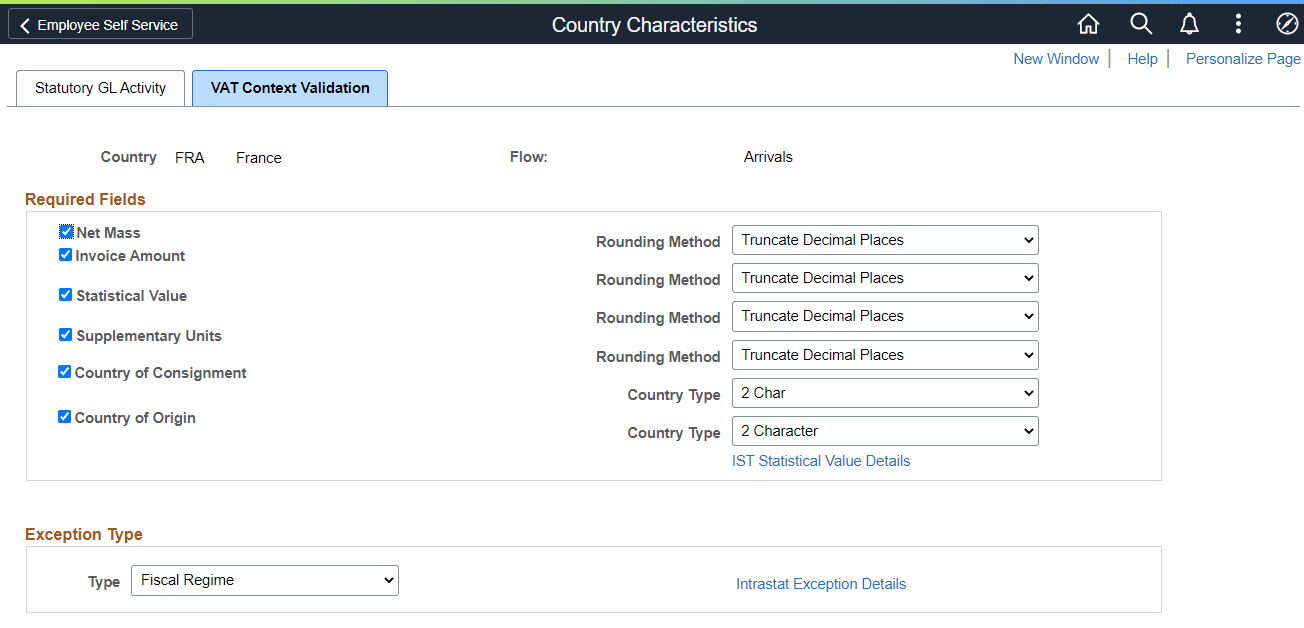

Use the Country Characteristics - VAT Context Validation page (IST_COUNTRY_TBL2) to select additional data, and specify the format of the information for the Intrastat form.
Navigation:
This example illustrates the fields and controls on the Country Characteristics - VAT Context Validation page.
Required Fields
Field or Control |
Description |
Rounding Method (Applicable to Net Mass, Invoice Amount, Statistical Value, and Supplementary Units) |
Determines the format for the corresponding fields. The following results are available: Normal: Rounds up or down to the nearest whole unit. For example, quantities less than 500 grams round down, and those between 500 and 999 grams round up. Truncate: Rounds down to the nearest whole unit. Up: Rounds up to the nearest whole unit. |
Country Type (Applicable to Country of Destination or Consignment, and Country of Origin) |
Determines the format for the corresponding country codes. The following values are available: 2 Char — prints the 2 character country code 3 Char — prints the 3 character country code 3 Numeric — prints the 3 digit numeric country code |
Invoice Amount |
The invoice amount for the goods shipped or received. |
Statistical Value |
This may be the same as the invoice amount, but the value generally differs. Within PeopleSoft applications, user-defined statistical value calculation factors are applied to the invoice amount to calculate the reported statistical value. Refer to each country's Intrastat Reporting requirements documents to establish how the statistical value is determined and to guide the setup of the calculation factors. |
Supplementary Units |
Indicates that you must use supplementary units for the selected country and flow to report transactions that involve commodity codes that include supplementary units. |
Country of Destination or Consignment (depending on the flow selected) |
Represents a trading partner's country. |
Country of Origin |
For arrivals, the country in which the goods were created or assembled. |
IST Statistical Value Details |
Click to access a page where you define the calculation factors that the system applies to the invoice amount to determine the statistical value for reporting. |
Exception Type
For some EU member states, entries for certain categories of transactions, such as financial adjustments or reconciliation entries, may not require all the information that Intrastat transactions normally require. Each member state has its own mechanism for identifying these exception transactions. France, for example, uses fiscal regimes, while the U.K. uses the second digit of the nature of transaction code.
Field or Control |
Description |
Type |
Specify the type of information that is used to identify exception transactions. |
Intrastat Exception Details |
Click to access a page where you define the information that is required for specific exceptions. |
Note: You cannot select Nature of Txn 2nd Digit, Fiscal Regime, or Statistical Procedure as an exception type unless they are selected in the Required Fields group box on the Intrastat Characteristics - Option a page.
