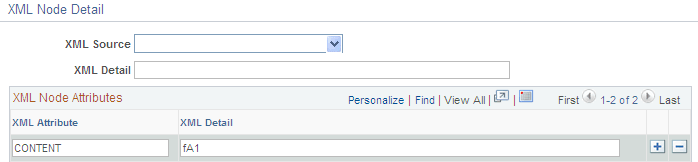

XML Node Detail Page |
VAT_XML_NODE_SEC |
(AUS) View or update metadata details for the e-BAS report. |

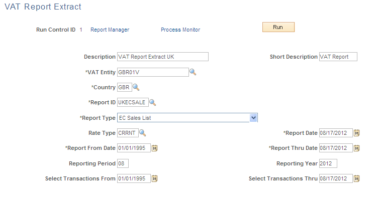

VAT_RPT_RQST |
Generate the VAT Report Extract process (VAT1001) to extract specific VAT transactions to the VAT reporting tables in preparation for printing VAT reports. |

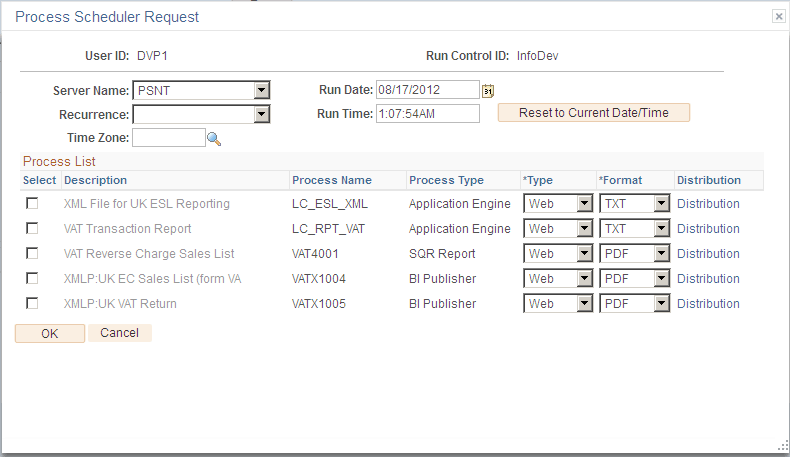

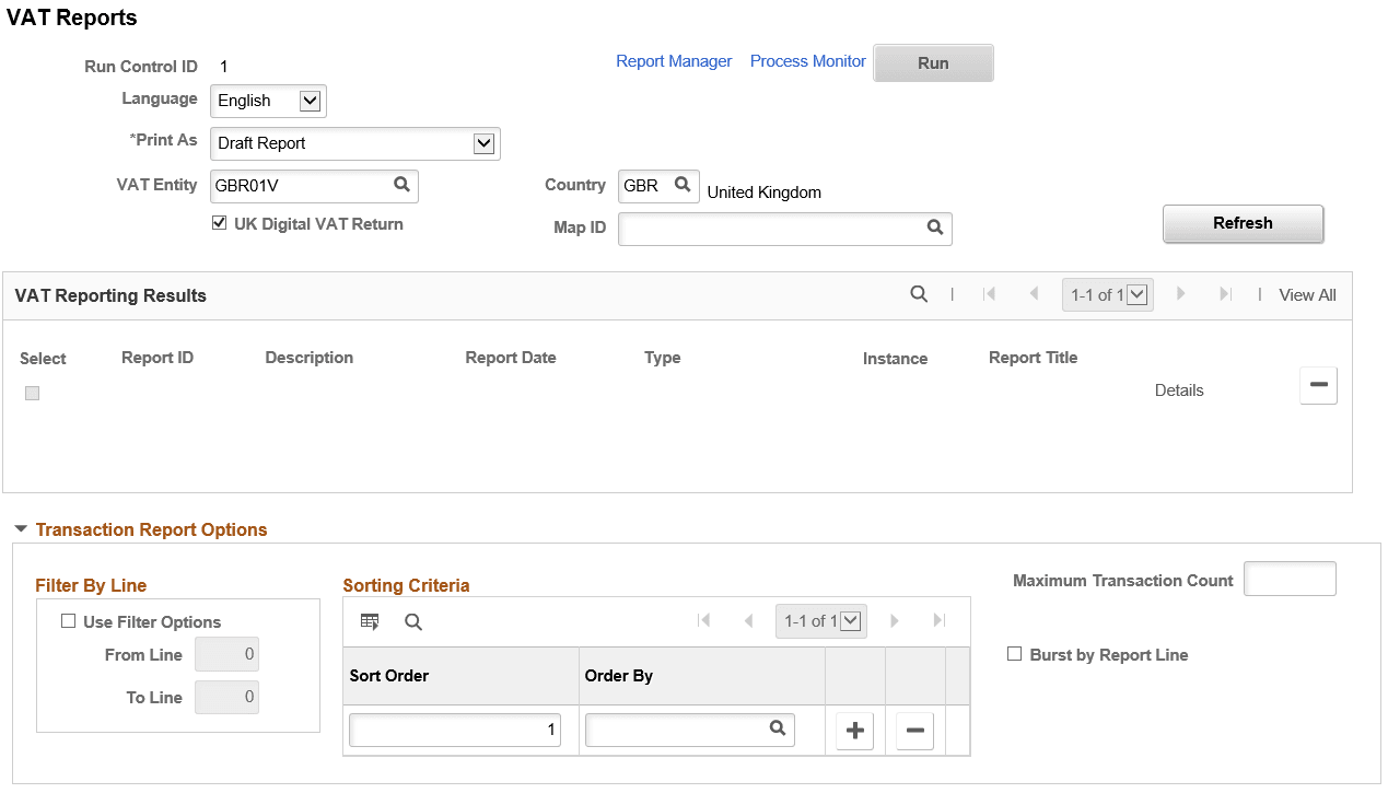

VAT_RPT_INST1 |
Generate reports to use in producing and reconciling your VAT return, including the VAT Transaction report for line item detail. |

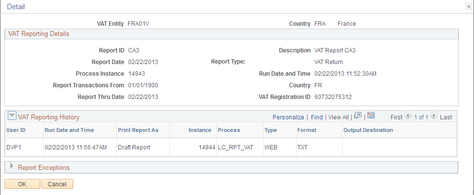

VAT_RPT_INST_DTL |
View information about a report instance, including the run parameters and reporting history. |

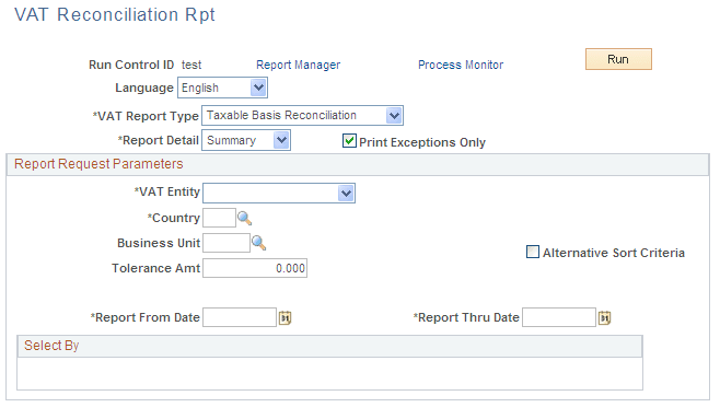

RUN_VAT2000 |
Generate the VAT Reconciliation report (VAT2000) to help in the reconciliation of your VAT accounts and for tax auditing purposes. |

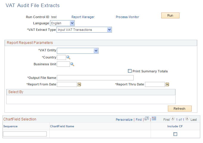

Create VAT audit file extracts containing VAT transaction information to use for tax auditing purposes. |

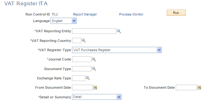

VAT_REGISTER_RQST |
(ITA) Generate Italian sales and purchases VAT registers. Available as a VATX0910 BI Publisher report. |

Run the VAT Report Extract process that applies your VAT report definitions to the VAT transaction data in the VAT reporting tables.
This process selects transactions from the VAT transaction table and stores VAT transaction information in the VAT reporting tables. You run the Report Extract for a specific VAT entity and country, indicating the type of report you want to produce as well as various date selection criteria. Each time you run the Report Extract process, a report instance is created. The transactions in the VAT transaction table that were selected by the Report Extract process are all linked to this report instance.

When you print a return report, you select the report instance for the report that you want to produce. You have three print options:
Term |
Definition |
Draft |
This option enables you to print your return report for purposes of review without finalizing it. At this point, you can still delete the report instance and start over. |
Final |
Once you print a return report as final, you can no longer delete the report instance. For VAT return or EC sales list reports, the VAT transactions cannot be selected again to appear in a report with that specific report type. |
Reprint |
This option enables you to reprint a return report that has previously been printed as final. |

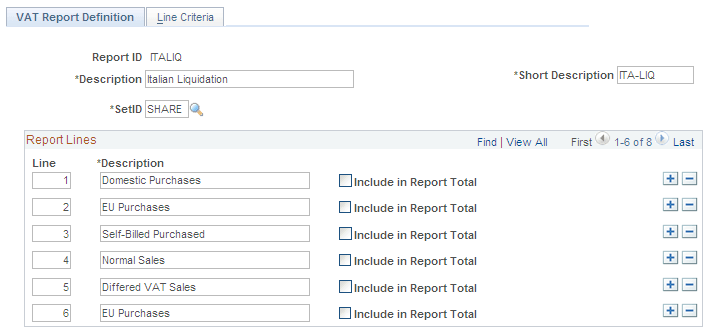

Use the VAT Report Definition page (VAT_RPT_ID1) to create or update a VAT report definition by defining the lines to be included in the VAT report.
Navigation:
This example illustrates the fields and controls on the VAT Report Definition page. You can find definitions for the fields and controls later on this page.
Enter a description, short description, and SetID.
Field or Control |
Description |
Line and Description |
Enter the number of each report line you add and a description for the line. |
Include in Report Total |
Select if you want the transaction to be included in the calculations. |
Note: For the predelivered VAT Returns defined by PeopleSoft applications, note that the line number on the report definition corresponds to the line numbers or box numbers on the appropriate layouts. Depending on the layout for each country, those numbers are not necessarily sequential, and the numbers do not necessarily start with 1. Before you change the report definition, print a sample report to get an understanding of line numbers and box numbers, if applicable, and the information required on each line of the VAT Return.

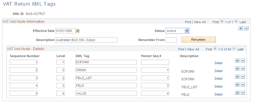

Use the VAT Return XML Tags page (VAT_XML_NODE_ENTRY) to (AUS) Maintain XML metadata for the electronic Business Activity Statement (e-BAS).
If the Australian Tax Office (ATO) changes the e-BAS, use this page to update the format.
Navigation:
This example illustrates the fields and controls on the VAT Return XML Tags page. You can find definitions for the fields and controls later on this page.
Enter an effective date and status.
Maintaining XML Metadata

Description |
Enter a description for the e-BAS (electronic Business Activity Statement) XML definition, for example, the version of the e-BAS from the ATO (Australian Tax Office) that you are currently using. |
Renumber From |
If you add rows, use this field to specify the sequence number of the row where you want to insert the new row and the system renumbers all of the subsequent rows when you click the Renumber button. |
Renumber |
Click to renumber of the rows. |
Sequence Number |
Identifies each node detail and determines the row sequence in the file. The sequence numbers must be contiguous. |
Level |
Enter to determine the hierarchy (indentation) of the row sequence. |
XML Tag |
Enter the XML tag descriptor for the type of XML data: field, value, edit state, field list, origin, or ECI (electronic commerce interface). |
Parent Seq # (parent sequence number) |
Enter the parent to the level you select. |
Detail |
Click to access the XML Note Detail page to view XML metadata details. |
Viewing or Updating Metadata Details
Use the XML Node Detail page (VAT_XML_NODE_SEC) to (AUS) View or update metadata details for the e-BAS report.
Navigation:
Click the Detail button on the VAT Return XML Tags page.
This example illustrates the fields and controls on the XML Node Detail page. You can find definitions for the fields and controls later on this page.
Field or Control |
Description |
XML Source |
Select the appropriate XML source from the following options: None: No value specified. Array: Cells G1 to G20 of the BAS (Business Activity Statement). Constant: Constant value specified. Field Val (field value): Permits specification of a field from the VAT_RPT_INST1 table. Runtime: Value defined on the Electronic Return run request page on which you define parameters for generating the e-BAS flat file. This page is described later in this section. |
XML Detail |
Enter a description for the XML source you are defining. For example, if you select Array as the XML source, use the XML detail to describe the placement of the source in the cells. |
XML Attribute and XML Detail |
Enter the XML attribute according to the XML source you select. For example, if you select Field Val as the XML source, enter the XML ID that describes the type of cell. Enter the XML detail according to the XML source you select. Again, for example, if you select Field Val as the XML source, enter the field number of the report. |
Use the VAT Report Extract (process) page (VAT_RPT_RQST) to generate the VAT Report Extract process (VAT1001) to extract specific VAT transactions to the VAT reporting tables in preparation for printing VAT reports.
Navigation:
This example illustrates the fields and controls on the VAT Report Extract page. You can find definitions for the fields and controls later on this page.
Set up your run requests for extracting data in preparation for printing your VAT report.
Enter a description and short description.
Field or Control |
Description |
VAT Entity and Country |
Select the entity and country for which you want to extract VAT transaction data. |
Report ID |
Enter the name of the report for which you are running the report extract. |
Report Type |
Select the type of report. Valid values are: Other: Select to produce any type of report other than a VAT Return or EC Sales List. Use to select the same VAT transactions repeatedly. Return: Select to report the VAT transactions in the specified date range on a VAT Return. You can make this selection only one time. If you have already selected Return for the transactions in the specified range, the process will not pick up these transactions again. Sales List: Select to report the VAT transactions in the specified date range on an EC Sales List report. You can make this selection only one time. If you've already selected Sales List for the transactions in the specified range, the process will not pick up these transactions again. |
Rate Type |
Specify the currency exchange rate type that the system should use to convert VAT amounts into the reporting currency. |
Report Date |
Enter the date that you generate the report. |
Report From Date and Report Thru Date (report through date) |
Enter the date range to print on the report as the date range of the return you are submitting. |
Reporting Period and Reporting Year |
Enter the period and year associated with the date range above to print on the report as the reporting period of the return you are submitting. |
Select Transactions From and Select Transactions Thru (select transactions through) |
Enter the date range to determine the transactions selected for the report. You can use these fields to extend the transaction selection beyond the date range for the tax return. For example, if you had missed some transactions from a previous quarter, you can include the missed transactions in the current quarter's figures by including the previous quarter in the date range that you define. Only the missed transactions are added to the current quarter's figures. |
You are now ready to generate the extract process.

Use the VAT Reports page (VAT_RPT_INST1) to generate reports to use in producing and reconciling your VAT return, including the VAT Transaction report for line item detail.
Navigation:
This example illustrates the fields and controls on the VAT Reports page. You can find definitions for the fields and controls later on this page.
Field or Control |
Description |
Print As |
Select from the following values: Draft: You can reprint the report as many times as necessary. Final: Print a final report. Reprint: If you have printed a report as final, you can reprint the report as many times as needed. |
Specify a VAT entity and country for the report. The system retrieves only those report instances generated for this entity and country combination. |
UK Digital VAT Return |
Select to generate UK VAT digital XML file for electronic transmission. Note: UK Digital VAT Return check box is available only for VAT entities that have a registration in VAT Reporting country GBR. |
Map ID |
Select a Map ID to generate UK VAT Digital XML file. Map ID field is displayed only when you select the UK Digital VAT Return check box. For more information on map definitions, see Defining the Data Source and Target |
Refresh |
Click to retrieve the report instances created by the VAT Report Extract process for the specified entity and country combination. The report instances appear in the VAT Reporting Results group box. |
VAT Reporting Results |
Displays the report ID, a description of the report, the report date, the report type, and the instance for each report extract that has been generated for this VAT entity and country combination. |
Select |
Click this check box for the report instance for which you want to print the VAT report. |
Details |
Click to access the Detail page to view details for a report instance. |
Note: For VAT returns and EC sales lists, any given VAT transaction can be selected only once for a report. However, before you print these types of reports as final reports, you can delete the report instance, enabling you to select the VAT transactions again for that report type. For other types of reports, this restriction does not apply.
Transaction Report Options
After completing the VAT Transaction Report Setup page, you can specify additional options for producing the VAT Transaction Report that shows line item details for the VAT return. You can generate the transaction report at the same time or before or after you generate the VAT report using the same run control page (VAT_RPT_INST1) that you use to generate the VAT report.
As with the VAT return, a report ID and process instance must be selected in the VAT Reporting Results grid to launch the VAT transaction report.
Note: The same set of data can be selected to provide both the transaction report and the VAT return report in the same run; however, the VAT transaction report options apply only to the VAT transaction report. While the VAT transaction report may or may not be generated at the same time as the VAT report, the transaction report must be generated after the VAT extract.
Field or Control |
Description |
Use Filter Options |
Click this check box, and the From Line and To Line fields become available with associated lookup for the line values. |
From Line and To Line |
Select line values to generate the report for one or a range of VAT report definition lines. Use the search function to retrieve valid line numbers based on the report ID present in the VAT reporting results scroll area. If multiple reports are present in that grid, the prompt can retrieve values from all the VAT report definitions. No edit is performed to ensure that the from and to values are for the same report. Ensure that the from line number is less than or equal to the to line number; otherwise, an error message is issued. If the specified report lines do not exist for the report definition, the report retrieves nothing. If both fields are empty, the system treats this as an entry of zero and returns only lines with a line number of 0. If you do not want to use the filter option, deselect the Use Filter Options check box. If the from field is not specified but the to line is specified, lines are considered to be designated from the beginning. If the to line field is not specified but the from line is specified, values are considered as all lines until the end. By default, if the To Line field is empty, it is populated with the from line value when the from value is changed. |
Sorting Criteria |
Enter criteria to sort detailed transactions within a VAT report line. You can specify up to three sorting criteria for the report detail section. The same field value cannot be used more than once in the grid and no more than three rows can be present in the grid at save time. The main report section is by VAT report line definition. These lines are printed in the sequential order as determined by the report definition. Sorting criteria applies to the transactions listed for each report line. |
Sort Order |
Enter a number used to determine the order in which the sort criteria fields are applied. |
Order By |
Enter the name of the fields to be used as sorting criteria. The same field value cannot be used more than once in the grid and no more than three rows can be present in the grid at save time. If no rows are present in the grid, no user-defined sorting criteria are used. Because database field names are used, be aware that fields such as CUST_ID and VENDOR_ID show up in the same third-party field in the report output. Because a transaction points only to either a supplier or customer, you might want to use both fields in conjunction. Also, some transactions do not involve a third party, and the sort criteria will be ineffective for such transactions. Note: The main report section is by VAT report line definition. These lines are printed in sequential order as determined by the report definition. Sorting criteria applies to the transactions listed for each report line. |
Maximum Transaction Count |
Use this field to split the output data to accommodate the Microsoft Excel format limit of 64,000 lines per spreadsheet. If the selected output type is Excel and the number of rows entered in this field is reached, the default output format is used instead. However, if the default output format is Excel, then pdf is used. This enables the system to work around the Excel limit. If the field is left blank, it is ignored by the process. Note: Because report output includes headers and totals, these rows must also be taken into consideration in the 64,000 limit. For example, if 63,500 transaction rows are found in the table, the overall number of rows might likely exceed the 64,000 lines due to rows required by the headers and totals. |
Burst by Report Line |
Click to split up the report output by report line. This selection enables you to produce multiple smaller output files rather than a single huge output file. Bursting by report line is especially advantageous when the output type is xls. When bursting is used, the maximum transaction count is checked by report line for the output file and not by report. Additionally, if Excel has been specified as the output format and Burst by Report Line is used, the default output format or pdf will be used only if any given report line exceeds the specified maximum number of transaction lines. |
Viewing Report Instance Details
Use the VAT Reports - Detail page (VAT_RPT_INST_DTL) to view information about a report instance, including the run parameters and reporting history.
Navigation:
Click the Details link on the VAT Reports page.
This example illustrates the fields and controls on the VAT Reports - Detail page. You can find definitions for the fields and controls later on this page.
Field or Control |
Description |
Report ID and Description |
ID and a description of the report definition used for the report extract. |
Report Date and Report Type |
Date of the report extract and type of report extract run. |
Process Instance |
Process instance for the report extract assigned by the system. The VAT transactions are linked to this process instance. |
Run Date and Time |
Date and time on which the report extract was generated. |
Report Transactions From and Report Thru Date (report through date) |
Date range of the transactions selected for the report extract. |
Country |
Country for which the report extract was generated. |
VAT Registration ID |
Associated VAT registration ID for the country that will print on the report. |
VAT Reporting History |
Lists the printing history. |
Transactions Not Selected |
Lists the transactions that are not included in the report and why. Use this section to associate transactions not selected with the report instances to prevent those transactions from being treated as exceptions for future reports. The transactions may include transactions that exist in the VAT transaction table for the date range entered on the extract page but that do not meet the criteria specified by the VAT report definition. The transactions are not necessarily in error. For example, transactions indicated as outside of the scope of VAT may exist in the VAT transaction table, but printing them on a VAT return may not be required. Note: You can prevent transactions that are not required on a VAT return from being specified as exceptions in the first place by creating an additional line on your VAT report definition to pick up these additional transactions. In this way, the transactions do not show up as exceptions, but they also do not appear on the report. Within the Report Exceptions group box is the Select All button, which enables you to select the Associate with VAT Report check box on all the lines within the Transactions Not Selected group box. You can select the Associate with VAT Report check box to link the transaction to the report instance, and prevent the transaction from being selected during future runs on the VAT Report Extract. This prevents the transaction from appearing on future reports as an exception. |
No Exchange Rates Available |
Lists the missing exchange rates needed to calculate the VAT amounts that appear. |
Note: The Transactions Not Selected and No Exchange Rates Available fields appear only if exceptions exist.
If a transaction has not been selected in error or if no exchange rate exists, you must correct the problem that caused the error, delete the report instance, and rerun the VAT report extract. This action enables all the previously selected transactions plus the transactions flagged as exceptions to be selected for the report.
Once you have reviewed the instance details and are satisfied that you have selected the correct instance, you are now ready to generate the VAT report.
Running the Reports Listed on the Process Scheduler Request Page
The reports that appear on the Process Scheduler Request page vary based on the VAT Entity for which the report is being run and the reports that have been linked to that VAT Entity. A couple of examples for a UK VAT Entity are:
VAT Transaction Report (LC_RPT_VAT)
XML file for UK ESL reporting (LC_ESL_XML )
XMLP: UK VAT Return (VATX1005)
This example illustrates the fields and controls on the VAT Entity — Process Scheduler Request page. You can find definitions for the fields and controls later on this page.
Note: If you are generating the XML File for UK ESL Reporting, you must manually modify the file prior to submission to HM Revenue and Customs:
When initially created, the first two lines in the file appear as follows:
<?xml version="1.0" ?>
-<Submission>
Modify the first line by using single quotes and adding the encoding notation as shown below in italics.
Modify the second line by adding the type attribute to the file definition tag as shown below in italics.
<?xml version=’1.0’ encoding=’UTF-8'’?>
- <Submission type='HMRC_VAT_ESL_BULK_SUBMISSION_FILE'>
Use the VAT Reconciliation Rpt page (RUN_VAT2000) to generate the VAT Reconciliation report (VAT2000) to help in the reconciliation of your VAT accounts and for tax auditing purposes.
Navigation:
This example illustrates the fields and controls on the VAT Reconciliation Rpt page. You can find definitions for the fields and controls later on this page.
Field or Control |
Description |
VAT Report Type |
Select from the following values: Account Balance Reconciliation: For a specified range of VAT-applicable accounts and dates, allows comparison of the amount of expected VAT to the amount of VAT that was actually posted for VAT transactions that have been recorded in PeopleSoft Payables, Receivables, Billing, Asset Management, Expenses, Treasury, and General Ledger. This report also allows the total amount of posted VAT reported for each VAT account to be compared to the GL balance for that VAT account. Account/VAT Account Recon (Account/VAT Account Reconciliation): For a specified range of accounts and dates, lists the taxable basis amounts as well as corresponding VAT amounts calculated from VAT transactions that have been posted by PeopleSoft Payables, Receivables, Billing, Asset Management, Expenses, Treasury, and General Ledger. Taxable Basis Reconciliation: Verifies that the VAT Basis amounts stored on the VAT Transaction table, multiplied by the appropriate VAT percentage, is equal to the actual VAT amount also stored on the same table. VAT Transaction Reconciliation: Provides an overview of VAT transactions generated by PeopleSoft Payables, Receivables, Billing, Asset Management, Expenses, Treasury, and General Ledger applications and verifies that those transactions have been reported on a VAT Return report. Zero VAT Justification: Illustrates why no VAT was collected or paid. |
Report Detail |
If you are generating the Taxable Basis Reconciliation, the VAT Transaction Reconciliation report, or the Account Balance Reconciliation report, select whether you want to view the report as Summary or Detail. If you select Detail, the report prints one line for each VAT transaction. If you select Summary, VAT information is printed on an aggregated level. Note: The Zero VAT Justification and Account/VAT Account Recon reports are always detail reports. |
Print Exceptions Only |
For the Taxable Basis Reconciliation report, the VAT Transaction Reconciliation report, or the Account Balance Reconciliation report, select to display discrepancies. This table lists the content for each of these reports if printed as an exception: |
Report |
Content of the Report |
Taxable Basis Reconciliation report |
Transactions for which the posted VAT amount and the calculated VAT amount (calculated as VAT basis amount multiplied by the VAT percentage) differ. |
VAT Transaction Reconciliation report |
Transactions that have not yet been printed on a final VAT return report. |
Summary option for the Account Balance Reconciliation report |
Accounts for which the general ledger balance does not match the total taxable basis amount. |
Detail option for the Account Balance Reconciliation report |
Detail lines for accounts with a difference between the GL balance and total taxable basis amount, as well as all detail transactions for which the accounting date falls into a fiscal period that is different from the VAT declaration date. |
Field or Control |
Description |
Select the VAT entity and country combination for which you want to generate the reconciliation report. |
Business Unit |
If applicable, you can also generate this report for a specific business unit. |
Alternative Sort Criteria |
If you are generating either the Taxable Basis Reconciliation report or the Zero VAT Justification report, select to sort by discrepancies in descending order. For the Taxable Basis Reconciliation report, transactions are sorted by the difference amount calculated as the posted VAT amount minus calculated VAT amount. For the Zero VAT Justification report, transactions are sorted by VAT basis amount. |
Tolerance Amt (tolerance amount) |
If you are generating the VAT Transaction Reconciliation report, you can enter a tolerance amount. VAT transactions are printed only when the posted VAT amount and the calculated VAT amount (calculated as VAT basis amount multiplied by the VAT percentage) differ by more than the amount entered. |
Specify the date range for the transactions to include in the report. |
Select By |
Use this group box to enter a range of ChartFields to include if you are generating either the Account Balance Reconciliation report or Account/VAT Account Recon report. |
You are now ready to generate the VAT reconciliation report.
Use the VAT Audit File Extracts page (RUN_VAT2000_EXT) to create VAT audit file extracts containing VAT transaction information to use for tax auditing purposes.
Navigation:
This example illustrates the fields and controls on the VAT Audit File Extracts page. You can find definitions for the fields and controls later on this page.
Select the VAT extract type from the following types:
VAT Extract Type |
Description |
AP, GL, Expenses, Treasury |
Extracts PeopleSoft Payables, General Ledger, Expenses and Treasury VAT data from the Payables, General Ledger, Expenses, and Treasury tables. |
Asset Mgmt Transactions |
Extracts asset retirement VAT data from the Asset Management tables. |
Billing Transactions |
Extracts Billing VAT data from the Billing tables. |
General Ledger Journals |
Extracts General Ledger journal data from the General Ledger tables. |
Input VAT Transactions |
Extracts VAT Input transactions from the VAT transaction table for Payables, Treasury, and Expenses, and both VAT Input and Output transactions for General Ledger. It also retrieves information from the corresponding source tables. For example, for Payables transactions it retrieves the related voucher and supplier information. |
Output VAT Transactions |
Extracts VAT Output transactions from the VAT transaction table for Asset Management, Receivables, and Billing. It also retrieves information from the corresponding source tables. For example, for Billing transactions it retrieves the related sales invoice and customer information. |
Receivables Transactions |
Extracts Receivables VAT data from the Receivables tables. |
Field or Control |
Description |
Select the VAT entity and country combination for which you want to generate the audit extract report. |
Business Unit |
Output File Name |
Enter the path and file name for the extract file. |
Print Summary Totals |
Select to summarizes the data content of the extract files in the report. |
Specify the date range for selecting transactions for this report. |
Refresh |
Click to populate the ChartField Selection group box with a listing of ChartFields. |
Include CF (include ChartField) |
Select to include the listed ChartField in the report. |
You are now ready to generate the VAT audit report.

Use the VAT Register ITA page (VAT_REGISTER_RQST) to (ITA) Generate Italian sales and purchases VAT registers.
Navigation:
This example illustrates the fields and controls on the VAT Register ITA page. You can find definitions for the fields and controls later on this page.
Field or Control |
Description |
VAT Reporting Entity and VAT Reporting Country |
Select the VAT entity and country combination for which you want to generate the report. |
VAT Register Type |
Select either VAT Purchases Register or VAT Sales Register. |
Journal Code |
Select the journal code. |
Document Type |
Use to select the document type to use for the selected journal code. This field is optional. |
Exchange Rate Type |
Select the type of exchange rate that you want the system to use to convert VAT amounts into the reporting currency. |
From Document Date and To Document Date |
Use to specify the date range for the documents to be included. |
Detail or Summary |
Select whether to run a Detail or Summary report. |
