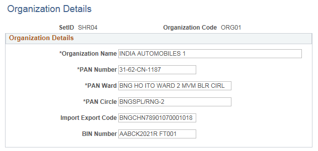

ORG_RGSTN_DTL_GST |
Define GST data at the organizational level. |

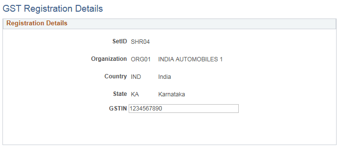

STX_RGSTN_DTL_GST |
Define GSTIN registration data at the organizational level. |

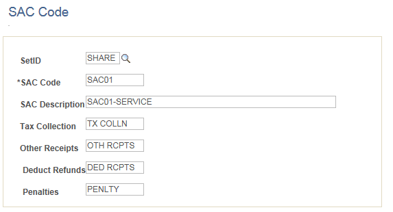

SAC_CODE |
Enter the SAC code for the given service. |

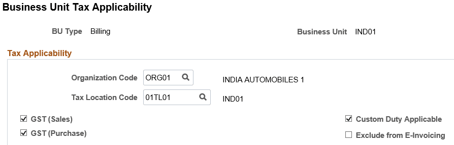

ORG_BU_TAX_APPL |
Assign a business unit to an organization and tax location code, and specify the business unit's GST and customs duty applicability. |
Use the Organization Details page (ORG_RGSTN_DTL_GST) to define GST data at the organizational level.
Navigation:
This example illustrates the fields and controls on the Organization Details Page. You can find definitions for the fields and controls later on this page.
Field or Control |
Description |
PAN Number (permanent account number) |
Enter the number that is assigned by the income tax authority to identify the organization's tax returns. This number is usually a 10-digit alphanumeric code. Oracle allows you to enter a 20-digit alphanumeric value. |
Use the Registration Details page (STX_RGSTN_DTL_GST) to define GSTIN data at the organizational level.
Navigation:
This example illustrates the fields and controls on the Registration Details Page. You can find definitions for the fields and controls later on this page.
Field or Control |
Description |
GSTIN |
Enter the GSTIN number for the taxable entity |

Use the SAC Code page (HSN_CODE) to assign a SAC code for a given service.
Navigation:
This example illustrates the fields and controls on the SAC Code Page. You can find definitions for the fields and controls later on this page.
Field or Control |
Description |
SAC Code |
Enter the SAC code for the given service. SAC codes must be 4, 5, or 6 numbers in length and valid as per government specifications. |
Use the Business Unit Tax Applicability page (ORG_BU_TAX_APPL) to assign a business unit to an organization and tax location code, and specify the business unit's GST and customs duty applicability.
Navigation:
This example illustrates the fields and controls on the Business Unit Tax Applicability page.
Field or Control |
Description |
GST (Sales) |
Select this check box to enable GST for the Order to Cash cycle. |
GST (Purchase) |
Select this check box to enable GST for the Procure to Pay cycle. |
Exclude from E-Invoicing |
Select to indicate that PeopleSoft Billing excludes specific Billing business units from the E-Invoicing process. The Billing business unit displayed on the page is excluded from E-Invoicing requirements. |
