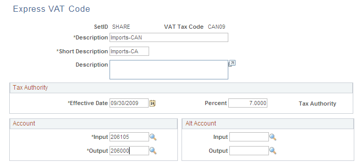

Use the Express VAT Code page (EX_TAX_CD_VAT) to quickly set up a VAT code by entering the required tax rate and having the system automatically create the associated VAT authority.
Navigation:
This example illustrates the fields and controls on the Express VAT Code. You can find definitions for the fields and controls later on this page.
For the VAT code you are adding, enter the VAT code, a description, and a short description.
Note: If you have PeopleSoft Billing, the short description prints on the bills.
Field or Control |
Description |
Effective Date |
Enter the effective date for the tax percentage. |
Percent |
Enter the tax rate as a percentage. |
Tax Authority |
When you save this page, the system automatically assigns a tax authority and populates this field. |
Input and Output |
Enter the default account for input and output tax in the Account group box. You can also enter a default account for input and output tax in the Alt Account (alternate account) group box. |
Note: After you create a VAT code using this page, use the VAT authority and VAT code setup pages to complete setup of VAT authority and tax code and to make any adjustments. For example, for Canada, you can set rebate rates for each public service body.

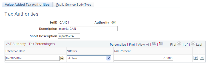

Use the Value Added Tax Authorities page (TAX_AUTHORITY_VAT) to create VAT authority tax percentages by effective date.
Create one VAT authority for each different tax rate.
Navigation:
This example illustrates the fields and controls on the Value Added Tax Authorities page. You can find definitions for the fields and controls later on this page.
Enter a description and a short description.
Enter the effective date, status, and tax percent.
You can add multiple rows to this page enabling you to enter new values if tax rates change.
Note: Create a different tax authority for each VAT rate used in a country.

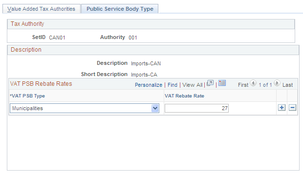

Establishing Public Service Body Type Rebates (CAN)
For Canadian public service organizations, access the Public Service Body Type page (Set Up Financials/Supply Chain, Common Definitions, VAT and Intrastat, Value Added Tax, VAT Authority, Value Added Tax Authorities, Public Service Body Type).
This example illustrates the fields and controls on the Public Service Body Type page. You can find definitions for the fields and controls later on this page.
Field or Control |
Description |
VAT PSB Type (VAT public service body type) |
Select the appropriate public service body type. Valid values are Charitable, Colleges, Hospital, Municipal, Non-Profit, School, and University. |
VAT Rebate Rate |
Enter the percentage set by Canadian law for rebates on input (nonrecoverable) VAT. |
Note: You must create at least one VAT use type using the VAT Use Type component for each public service body type that you create.

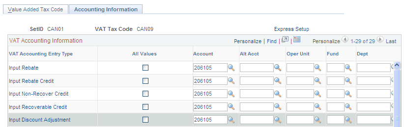

Use the Accounting Information page (TAX_ACCTG_VAT) to specify accounts and ChartFields used when recording VAT for a VAT code.
Navigation:
This example illustrates the fields and controls on the Value Added Tax Code - Accounting Information page. You can find definitions for the fields and controls later on this page.
Field or Control |
Description |
Express Setup |
Click to access the VAT Accounting Express Setup page to quickly set up default values for input and output VAT ChartFields. The system applies these defaults to all the applicable VAT accounting entry types. |
VAT Accounting Entry Type |
Lists all the VAT accounting entries that apply to the PeopleSoft applications that you installed. For example, if your installation includes only sales-related applications (such as PeopleSoft Order Management, Billing, and Receivables), you see only accounting entry types that are related to output VAT on sales. Clicking any of the VAT accounting entry types listed opens the VAT Accounting Exceptions page on which you can define specific ChartFields for VAT transaction type exceptions. Note: You can specify a single set of ChartFields for a VAT code using the Accounting Information or Express Setup page, and the system uses those values for all VAT transaction types used with that VAT code. However, if a certain type of transaction must be reported separately, then it is easier to reconcile the VAT reports to the general ledger if these transactions are posted to separate ChartFields. |
All Values |
Select to display all values when you click account. Otherwise, the system displays only those accounts that have been flagged in PeopleSoft General Ledger as VAT accounts. |
Account |
You must provide values for all the account ChartFields listed. You cannot save the page without recording an account number for each available field. If a particular account type is not applicable in your environment based on the applications installed, complete the Account field with a dummy value. |
Alt Act (alternate account), Oper Unit (operating unit), Fund, Dept (department), Program, Class, Bud Ref (budget reference), Product, Project, Affiliate, Fund Affil (fund affiliate), and Oper Unit Affil (operating unit affiliate) |
Complete these optional ChartFields as needed. |

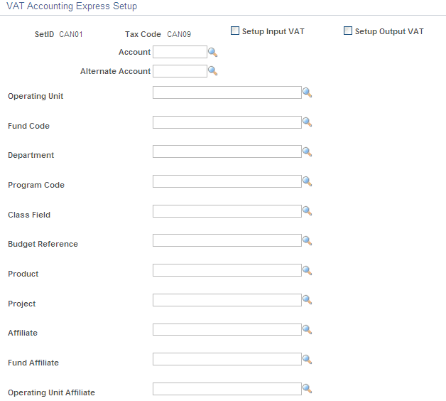

Use the VAT Accounting Express Setup page (TAX_BUACT_EXPRESS) to specify a set of input and output VAT ChartFields as the default for a VAT code and general ledger business unit.
Navigation:
Click the Express Setup link on the VAT Accounts by Business Unit page.
This example illustrates the fields and controls on the VAT Accounting Express Setup page. You can find definitions for the fields and controls later on this page.
Field or Control |
Description |
Setup Input VAT |
Select to specify the ChartField information to be used for recording input VAT. |
Setup Output VAT |
Select to specify the ChartField information to be used for recording output VAT. |
Specify the appropriate ChartField values. Click OK to return to the Accounting Information page.

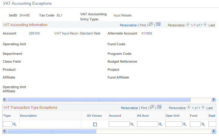

Use the VAT Accounting Exceptions page (TAX_ACCTG_VAT_DTL) to define ChartFields for specific VAT transaction type exceptions.
Navigation:
Click a VAT accounting entry type on the Accounting Information page or on the VAT Accounts by Business Unit page.
This example illustrates the fields and controls on the VAT Accounting Exceptions page. You can find definitions for the fields and controls later on this page.
Field or Control |
Description |
Type |
The VAT transaction type for which you want to define an exception. |
All Values |
If you do not select this check box, you see only those accounts that have been flagged in PeopleSoft General Ledger as VAT accounts. Select the check box if you want to view all account values. |
Enter the ChartField information that you want to modify for the account type.
Click OK to save your changes and return to the Accounting Information page.

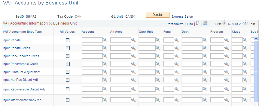

Use the VAT Accounts by Business Unit page (TAX_BUACT_VAT) to set up VAT accounts by VAT code and general ledger business unit.
Navigation:
This example illustrates the fields and controls on the VAT Accounts by Business Unit page. You can find definitions for the fields and controls later on this page.
Field or Control |
Description |
Delete |
Click to delete all entries for this combination of general ledger business unit and VAT code. For example, if you entered a set of defaults for a general ledger business unit and later decided this was not necessary, you would access this page for the general ledger business unit and use the Delete button to delete all entries. |
Express Setup |
Lists all the VAT accounting entries that apply to the PeopleSoft applications that you installed. For example, if your installation includes only sales-related applications (such as PeopleSoft Order Management, Billing, and Receivables), you see only accounting entry types that are related to output VAT on sales. Clicking any of the VAT accounting entry types listed opens the VAT Accounting Exceptions page, on which you can define specific ChartFields for VAT transaction type exceptions. Note: You can specify a single set of ChartFields for a VAT code using the Accounting Information or Express Setup page, and the system uses those values for all VAT transaction types used with that VAT code. However, if a certain type of transaction must be reported separately, then reconciling the VAT reports to the general ledger is easier if these transactions are posted to separate ChartFields. |
All Values |
Account |
Populate these optional ChartFields as needed. |
