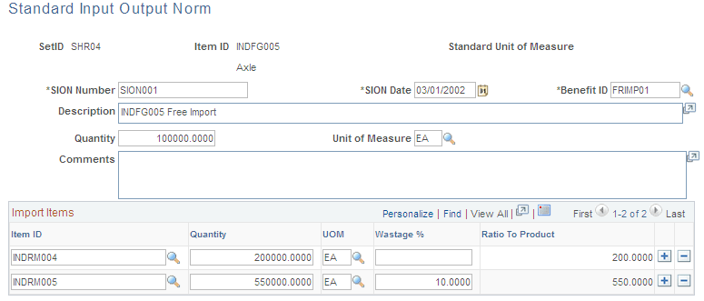

Use the Standard Input Output Norm page (CSD_ITEM_SION) to use to collect information to create reports for claiming customs duty exemptions and customs duty drawback benefits.
For an export item, define the quantity of input items, including wastage, that are needed to produce this export item.
Navigation:
This example illustrates the fields and controls on the Standard Input Output Norm page. You can find definitions for the fields and controls later on this page.
This page collects information to create reports claiming customs duty exemptions and customs duty drawback benefits. Benefit schemes that specify an export obligation require validation of the imported items that are used in the manufacture of the export items. This applies to items that are imported by means of the benefit type of Drawback or Free on the Benefit Scheme page. To claim the benefits, the importer has to submit the proof of consumption of the imported inputs that are used to manufacture the exported output items. The customs authorities use the SION as the basis for determining the inputs that are considered for the benefit. SIONs are available from the customs authorities for the majority of export items. Each SION is identified with a unique SION number and SION date.
Field or Control |
Description |
SION Number |
Enter the SION identification number that is given to you by customs authorities. |
SION Date |
Enter the SION date that is given to you by customs authorities. The current date is used as the default. |
Benefit ID |
Enter the benefit scheme that is associated with this item's SION. |
Quantity (quantity) |
Enter the quantity of the export item that is produced in the manufacture process. |
Import Items
Field or Control |
Description |
Item ID |
Enter the item ID of the imported item that is used in the manufacture of this export item. |
Quantity |
Enter the quantity for this import item that is consumed in the manufacturing process. |
UOM (unit of measure) |
Define the unit of measure for this input item's Quantity field. |
Wastage % (wastage percentage) |
Enter the percentage of the input quantity that is lost during the manufacturing process. |
Ratio to Product |
The system calculates the percentage of the input item quantity that is part of the output product quantity. The system sets the input and output quantities to the same unit of measure by converting either the input or output quantities. Then, the system divides the input quantity by the output quantity and multiples the result by 100 to compute the percentage. |
