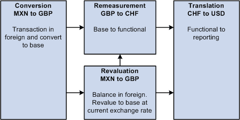

In this example and as shown in this graphic, a London based subsidiary of a Swiss company records a purchase made in Mexican pesos. The Swiss company is owned by a United States corporation.
Multicurrency calculations
The following correlates the terminology and the currencies:
Term |
Definition |
Foreign currency |
MXN (Mexican Peso) |
Base currency |
GBP (British pounds) |
Functional currency |
CHF (Swiss francs) |
Reporting currency |
USD (United States dollars) |
