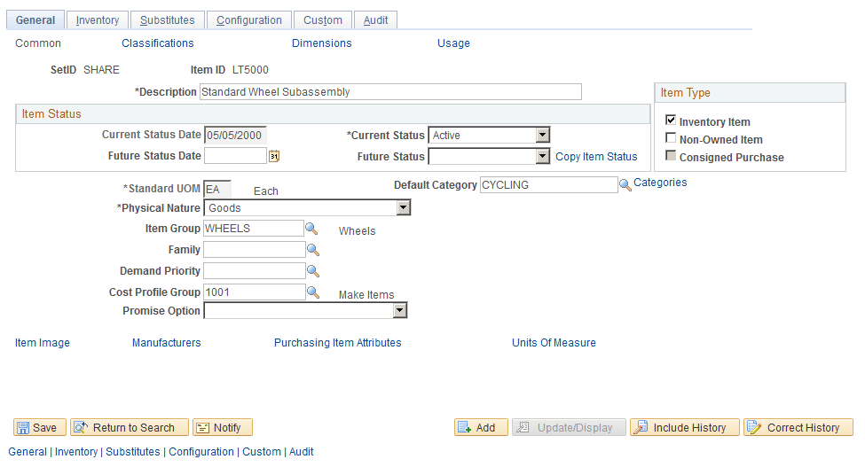

Use the Define Item - General: Common page (INV_ITEMS_DEFIN1) to define or change general item information at the SetID level, including the inventory item type.
Select the Inventory Item check box to change this item ID to an inventory item type. Deselect the Inventory Item check box to change this item ID to a non-inventory item type.
Navigation:
This example illustrates the fields and controls on the The Define Item - General: Common page. You can find definitions for the fields and controls later on this page.
Use this page to change the item type for one item ID at a time.
Field or Control |
Description |
Inventory Item |
Select this check box to change this item ID to an inventory item type (a value of Y in the INVENTORY_ITEM field in the MASTER_ITEM_TBL record). Deselect this check box to change this item ID to a non-inventory item type (a value of N). |
Non-Owned Item |
A non-inventory item cannot be non-owned. |
Consigned Purchase |
A non-inventory item cannot be consigned. |
Once you have changed the item type from inventory to non-inventory and clicked the Save button:

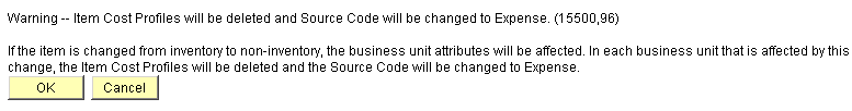

A warning message is displayed if there are cost profiles that exist for any business unit that is using this particular SetID. If you click the OK button to continue past this warning, then the cost profiles are deleted, the cost element is set to blank on the BU_ITEMS_INV record, and the source code is changed to expense.

Warning message issued concerning cost profiles and source code
This example illustrates the fields and controls on the Warning message issued concerning cost profiles and source code. You can find definitions for the fields and controls later on this page.

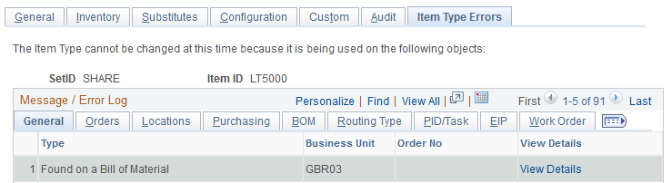

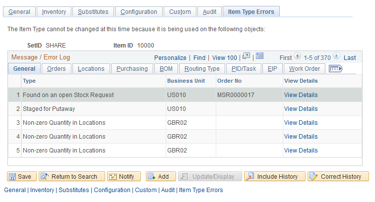

General
Select the General tab of the Item Type Errors page.
This example illustrates the fields and controls on the The General tab of the Item Type Errors page. You can find definitions for the fields and controls later on this page.
Field or Control |
Description |
Type |
Describes the problem with the item ID that prevents the change in inventory item type. |
Business Unit |
Displays the inventory business unit. |
Order No |
Displays the order number within the inventory business unit. This could be a sales order or materials stock request. |
View Details |
Click to access the Cancel/Hold Stock Requests page for material stock requests or the Order Entry Form for sales orders. These pages enable you to cancel the order. It the item is currently or scheduled to be a substitute for another inventory item at the business unit level, then you cannot change it to be a non-inventory item. Click the link to access the Define Business Unit Item component for the item using the substitute where you can remove your item from the substitute list. |

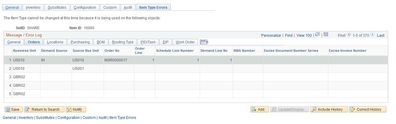

Orders
Select the Orders tab of the Item Type Errors page.
This example illustrates the fields and controls on the The Orders tab of the Item Type Errors page. You can find definitions for the fields and controls later on this page.
Each order that is inserted into the demand table (IN_DEMAND) is identified by eight fields that make up its demand key: inventory business unit, demand source, source business unit, order number, order line, schedule line number, demand line number and item ID. This tab displays seven of these fields. The item ID is defined at the Define Items component level.
Field or Control |
Description |
Business Unit |
Demand Source |
Displays the PeopleSoft application that originally created the order; including:
Source Bus Unit |
Displays the business unit that created the order. |
RMA Number |
For return materials authorization (RMA) transactions, this column displays the unique identification number for this RMA. Click the link to access the RMA Form page. |
Excise Document Number Series |
For shipping excise invoices, this column displays the excise document number series used to create a unique excise invoice number for this transaction. |
Excise Invoice Number |
Displays the excise invoice number assigned to this shipping excise invoice. India tax processing treats inventory items differently than non-inventory items, so you cannot change the item type if it is currently being processed through the India tax process. Click the link to access the Shipping Excise Invoice page. |

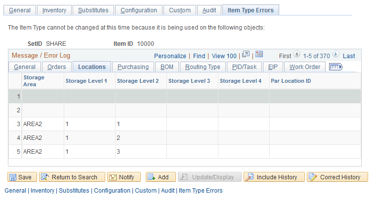

Locations
Select the Locations tab of the Item Type Errors page.
This example illustrates the fields and controls on the The Locations tab of the Item Type Errors page. You can find definitions for the fields and controls later on this page.
This tab displays the material storage locations (MSL) within the inventory business unit that still contain stock of this item ID. All the MSLs must be adjusted to zero quantity. The MSL must not contain a positive quantity or a negative quantity (if you have enabled the negative inventory feature). Click the link to access the Adjustments page where you can create an adhoc adjustment to bring the quantity to zero in each MSL.
Field or Control |
Description |
Par Location ID |
Displays the par location using the item ID. The item cannot be changed from an inventory item to a non-inventory item if it is currently defined as a stock item on the par definition (CART_TEMPL_INV) table. Click the link to access the Par Location Definition component. |

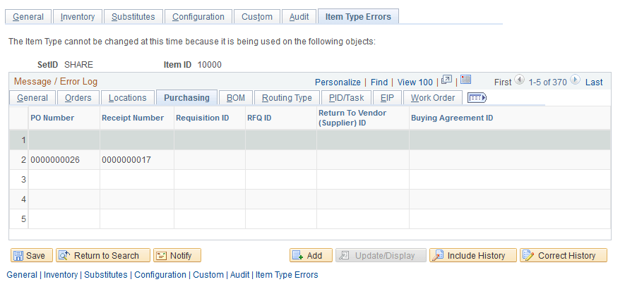

Purchasing
Select the Purchasing tab of the Item Type Errors page.
This example illustrates the fields and controls on the The Purchasing tab of the Item Type Errors page. You can find definitions for the fields and controls later on this page.
From PeopleSoft Purchasing, this tab displays any purchase orders, receipts, requisitions, RFQ (request for quotes), return to vendor transactions, or buying agreements that contain the item ID you want to change.

PO Number |
Click the link to access the Maintain Purchase Order - Purchase Order page. |
Receipt Number |
Click the link to access the Maintain Receipts - Receiving page. |
Requisition ID |
Click the link to access the Maintain Requisitions - Requisition page. |
RFQ ID |
Click the link to access the Request Quotes page. |
Return To Vendor ID |
Click the link to access the RTV page where you can cancel the RTV. |

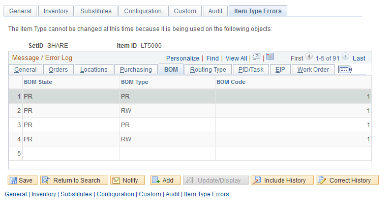

BOM
Select the BOM tab of the Item Type Errors page.
This example illustrates the fields and controls on the The BOM tab of the Item Type Errors page. You can find definitions for the fields and controls later on this page.
From PeopleSoft Manufacturing, this tab displays bill of materials (BOM) information that contains the item ID you want to change. The item type cannot be changed if the item ID is on a BOM.

BOM State |
Displays the nature of BOM. Values are:
BOM Type |
Displays the type of BOM. Values are:
BOM Code |
Displays the BOM priority code used to manufacture the item. Click the link to access the Delete BOMs page. |

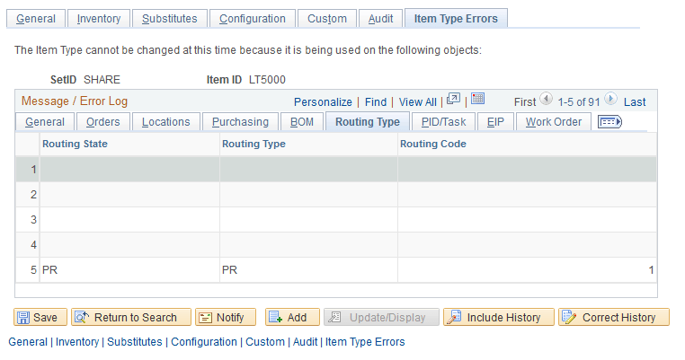

Routing Type
Select the Routing Type tab of the Item Type Errors page.
This example illustrates the fields and controls on the The Routing Type tab of the Item Type Errors page. You can find definitions for the fields and controls later on this page.
From PeopleSoft Manufacturing, this tab displays routing information that contains the item ID you want to change.
Field or Control |
Description |
Routing State |
Displays the nature of routing. Values are:
Routing Type |
Displays the type of routing. Options are:
Routing Code |
Displays the unique numeric identifier of the routing. Click the link to access the Define Routings page. |

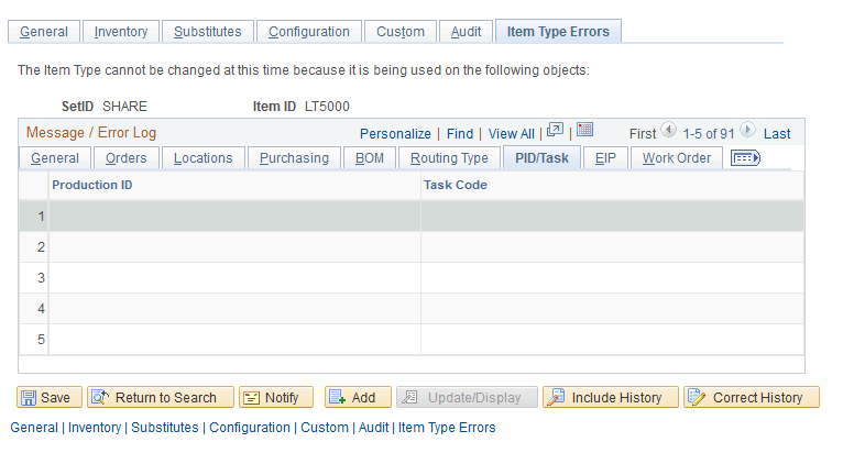

PID/Task
Select the PID/Task tab of the Item Type Errors page.
This example illustrates the fields and controls on the The PID/Task tab of the Item Type Errors page. You can find definitions for the fields and controls later on this page.
From PeopleSoft Manufacturing, this tab displays production IDs (PIDs) that contains the item ID you want to change.
Field or Control |
Description |
Production ID |
Click the link to access the Update Operation List component for this production ID where you can delete operations using this item ID. |
Task Code |
Displays a unique identifier for the specified task. Click the link to access the Define Task - Definition page. |

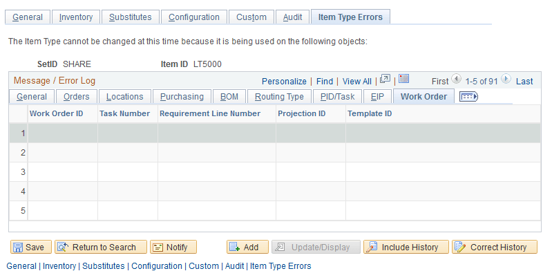

Work Order
Select the Work Order tab of the Item Type Errors page.
This example illustrates the fields and controls on the The Work Order tab of the Item Type Errors page. You can find definitions for the fields and controls later on this page.
From PeopleSoft Maintenance Management, this tab displays work order information that contains the item ID you want to change. The inventory item type cannot be changed if there are open tasks that contain this item (both requirements and scheduled).

Work Order ID |
Displays the unique number identifying the work order. Click the link to access the Work Order page where you can alter the task lines containing this item ID. |
Task Number |
Identifies the task associated with the work order ID. |
Requirement Line Number |
Displays the line number of the inventory parts requirement for a work order. |
Projection ID |
Displays the unique number used to identify the preventive maintenance projection using this item ID. |
Template ID |
Displays the identification number for the work order template. |
