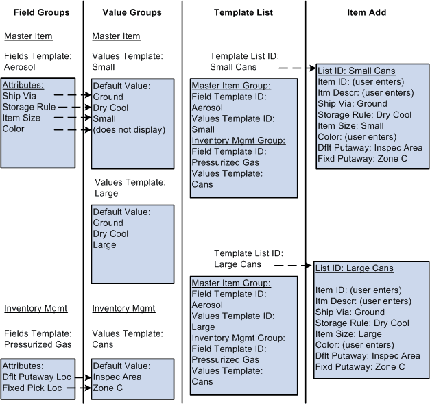

Example of a Configurable Item Template
In this topic, an example is used to illustrate how the configurable item templates are used. Let's assume that in your work environment you frequently stock and sell spray paint in many colors. You frequently add aerosol spray paint cans as new items to the system and want the end-users to efficiently and correctly add the new items. You want to make sure that aerosol cans are stored in a cool, dry warehouse location and that they are shipped by ground transportation. You carry two sizes of cans, large and small. The paint color varies for each new item added, so you want the user to see the color field and populate it. You set up configurable item templates to prevent user-error and to efficiently add items both individually and in batch.
The following diagram illustrates how to setup configurable item templates. In this example, two template lists are set up; one for small aerosol spray cans and one for large aerosol spray cans. First, the field group templates are defined to include attributes important to the type of item to be added. Next, the value group templates are added to identify the default values that are used for aerosol cans. In the third step the template lists are created by combining different item templates for field groups and value groups. In the final column, you can see how the Item Add component would use the template list ID to efficiently add a new item in the aerosol can group.
Example of Configurable Item Templates
The setup steps are:
Define the field group templates. Field group templates are used to define the item attributes that are important to the order-entry of a new aerosol can. Item template field groups are divided into categories, in this case, master item and inventory management.
The item master field group enables us to define the fields important for aerosol cans including shipping method (Ship Via), storage rule, item size, and item color. The master item field group template named Aerosol is created with these fields defined. Of course, other fields would also be defined here to create a complete item. Notice that the Color field is defined in the field group template but not in the corresponding value group templates. End-users have to populate the Color field when the item is added but do not use a default value. This is accomplished by defining the rules for the field on the field group template as follows: Required check box is selected, Modifiable check box is selected, and Display on Template check box is deselected.
The inventory management field group enables us to define how pressurized gas is handled within the warehouse. The fields for default putaway location and fixed picking location must have default values. This insures that the spray cans are placed and retrieved from the correct material storage locations within the PeopleSoft Inventory business unit. Note that the name of the inventory management field group template is Pressurized Gas as it applied to all pressurized gas and could be reused when defining helium containers or other types of pressurized gas.
Define the value group templates. Three value group templates are set up.
A master item value group template named Small contains the default values for small aerosol cans and was built using the item master field group template named Aerosol.
A master item value group template named Large contains the default values for large aerosol cans and was also built using the item master field group template named Aerosol. Note that the default values differ between large and small cans so there are two different value group templates that refer to the same field group template. This design efficiently uses a common field group template with different default settings. In addition, you can reduce the template setup by using the copy function to copy field group templates and value group templates.
An inventory management value group template named Cans contains the material storage locations for the default putaway location and the fixed picking location. These are the areas of the warehouse where pressurized gas is stored. This value group template was built using the field group template named Pressurized Gas.
Define the item template lists. Two template lists are defined, one for small spray paint cans and one for large spray paint cans. Notice that different master item value group templates are used to reflect the different defaults for large versus small. Also notice that the same inventory management field group template and inventory management value group template are used for both template lists. You can reuse field group templates and value group templates for different combinations of template lists.

In the preceding illustration, the last column demonstrates how the Item Add component can be used to add new items using the template list ID for small cans and for large cans. Notice that the SetID, item ID, and item description are entered by the user. In addition, the templates are designed so that the user must also enter the item color.
