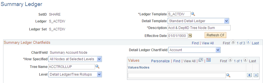

Use the Summary Ledger page (LEDGER_SUMMARY1) to specify the ledger template that defines the records and fields for the summary ledger and specify the ChartFields to summarize (after defining a summary ledger table that stores the summary balances).
Navigation:
This example illustrates the fields and controls on the Summary Ledger page. You can find definitions for the fields and controls later on this page.
Note: Summary ledgers support summarization of ADB (average daily balance) target ledgers. However, summarizing daily ledgers is not supported.
Note: You can define Summary Ledgers across Commitment Control Ledgers using the associated detail template. Incremental updates though are not supported for Summary Ledgers.
Field or Control |
Description |
Ledger Template |
Select the summary ledger template. |
Detail Template |
Select the template that contains the detail ledgers that you are summarizing. |
Refresh CF |
Click this button to reset the summary ledger ChartFields. |
Detail Ledger ChartField |
Identify the detail ledger ChartField that you want to summarize. Note: Be sure to define Currency Code as one of the fields to summarize as well as Statistics Code if you want to summarize statistics. |
How Specified |
Select from the following values: All Detail Values: Retain detail ChartField values in that ChartField. All Nodes at a Level: Summarizes every node at a selected tree level. Children at a Level: Includes all tree nodes at a given tree level that are children of the specified tree nodes. In this case, you select the parent node names in the Values scroll area. Detail - Selected Parents: and Selected Tree Nodes: Enter the tree to use (in Tree Name.) You can then select tree nodes (in Values/Nodes) that contain the detail values that you want to include in the summary ledger on the tree. The ledger includes all detail values summarized by that node. If you select a tree that uses levels, the system displays an optional Level edit box, enabling you to limit prompting in this field to selected levels. Selected Detail Values: Select certain detail values (such as USA and Canada Sales departments, or all P&L accounts) in the Values/Nodes field. |
Note: The field length for the summary ledger ChartFields is a critical factor in defining a summary ledger. It is dependent on whether you specify the summary ledger ChartFields by using detail values or tree nodes.

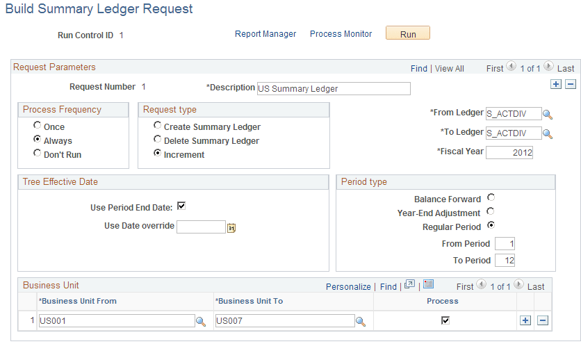

Use the Build Summary Ledger Request page (SUMMARY_REQUEST) to either creates a new summary ledger or performs the incremental update process.
Navigation:
This example illustrates the fields and controls on the Build Summary Ledger Request page. You can find definitions for the fields and controls later on this page.
General Ledger uses the information that you entered on the Define Summary Ledger - Definition page and on the Ledger Set for Summary Ledgers - Ledger Set page to update summary ledger balances. After you define all of your requests, run the background process each time that you want to generate or update a summary ledger. Each time the system processes a summary request, it erases the results of any earlier summary request of the same period.
The Build Summary Ledger Request page enables you to specify one or more business units for summary ledger processing. This facilitates processing and improves performance, whether you process your business units by group or by individual business unit.

Request Type
These options determine what you want the background process to do with the summary ledger.
Field or Control |
Description |
Create |
Select to first delete any existing summary ledger and then create a new summary ledger. |
Delete |
Select to delete an existing summary ledger. |
Increment |
Select to update the summary ledgers incrementally with changes made since the summary ledger was last created or updated. The process checks the status table for an appropriate entry in which to apply the increment. If an entry is found, the process performs the increment action and updates the status row. If no row is found, the Create process runs and inserts a status row. Note: To use the Increment option, select Enable Incremental Sum Ledgers option on the Ledgers For A Unit - Journal Post Options page for the detail ledger group. |
Tree Effective Date
These fields determine the use of the effective date.
Field or Control |
Description |
Use Period End Date |
Select to have the system use the version of the tree that is effective as of the end date of each period summarized. |
Use Date override |
Select any past or future date. You typically run summary ledgers for a single period as part of your monthly closing, but you can also use this field to select a range of periods. The periods are determined by the summary or detail calendar associated with this ledger. If you select a range of ledgers and not all of the ledgers contain the requested periods, only the valid combinations run. On the message log, the system identifies the successful completion or an error for each combination that you select. For example, suppose that you select a range of ledgers where the first two use a monthly calendar and the third is based on a quarterly calendar. If you select period 6, the first two summary ledgers run successfully, and the system indicates that an error occurred while processing the third ledger because there is no period 6 in a quarterly calendar. Refer to the Ledgers For A Unit page or to the summary ledger set to verify which calendar the system uses for each summary ledger. |
Business Unit
Identify the business units or range of business units for which to process the summary ledger.
Field or Control |
Description |
Business Unit From and Business Unit To |
Select a business unit or range of business units for summary ledger processing for a given request. |
Process |
Select the business units or groups of business units for summary ledger processing. Those business units or range of business units that are not selected will not be processed. |
Period Type
You identify the period and whether its period is a balance forward period or a year end adjustment period.
Field or Control |
Description |
Balance Forward |
Select after each annual close to prepare for the new year's processing. General Ledger uses Period 0 to store balance-forward amounts. Summarize the beginning balances loaded during the implementation process so that they are available for summary reporting. |
Year-End Adjustment |
Select to summarize any adjustments that you entered. You typically summarize the year end adjustments before you run an annual close. If you select this option, you can specify the adjustment periods to include. Adjustment periods are not combined. |

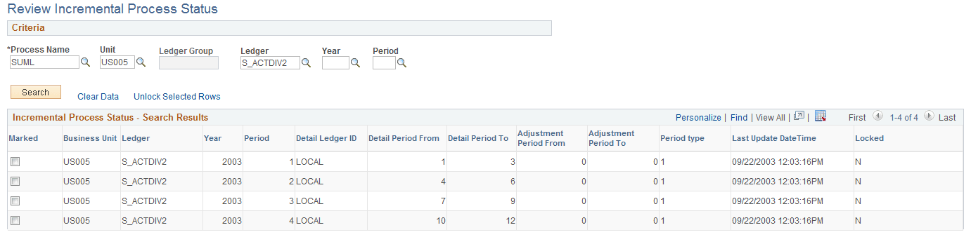

Use the Review Incremental Process Status page (SLED_STAT_INQ) to view the status of an incremental process.
Navigation:
This example illustrates the fields and controls on the Review Incremental Process Status page.
Use this page to view incremental ledger status and search results for the criteria you select.
Field or Control |
Description |
Process Name |
Select an incremental process to review. Options are: GLCLOSE (Closing), MCURR (Multi-Currency), and SUML (Summary Ledger) |
Clear Data |
Click this link to clear and archive incremental record data for the selected rows. |
Unlock Selected Rows |
Click this link to unlock selected rows. |
Marked |
Select this check box to indicate which rows you want to clear or unlock. |
Locked |
Displays Y or N to indicate whether the record is locked and being used by an incremental process. |
