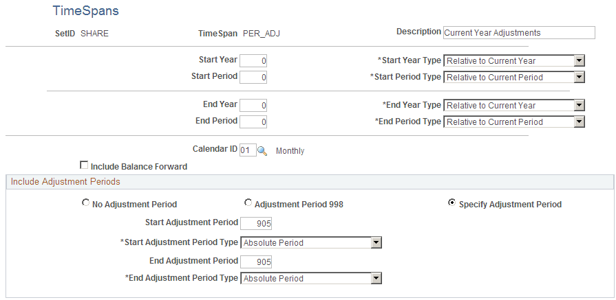

In this example, the adjustment period is set up for the absolute period of 905.

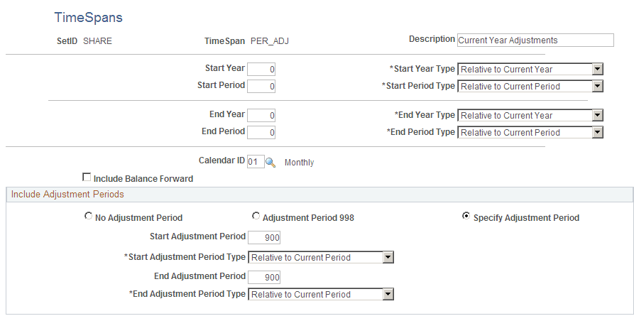

In the following example, the adjustment periods are defined relative to the current regular period:
This example illustrates the fields and controls on the TimeSpans page (adjustment period determined relative to current period). You can find definitions for the fields and controls later on this page.
The adjustment period is the Start Adjustment Period/End Adjustment Period value that is specified, plus the current regular period. For example, suppose that you are processing allocations in March, then the current period is 03 (monthly calendar) and the adjustment period is 903.
The advantage of defining the adjustment period as relative to the current period is that you need not maintain the adjustment period value in the time span.

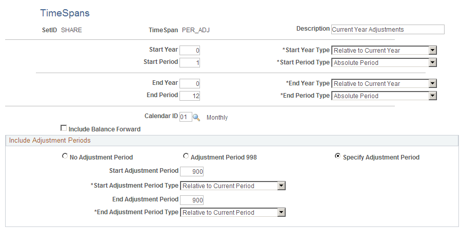

Use relative adjustment periods to allocate to multiple adjustment periods. In this example, the TimeSpans page is defined for allocations to create adjusting journal entries for adjustment periods 901 through 912:
