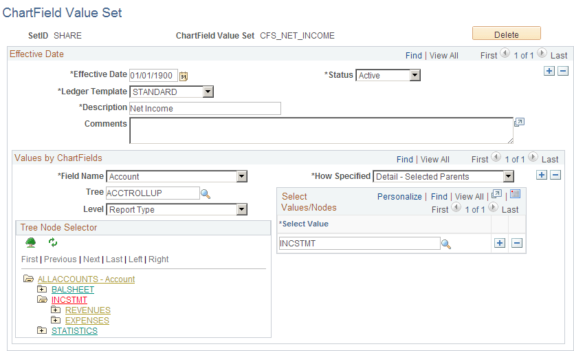

Use the ChartField Value Set page (CF_VALUE_SET) to define sets of ChartField values to be used for such things as closing, commitment control budget close, equitization, and consolidation processing.
Navigation:
This example illustrates the fields and controls on the ChartField Value Set page. You can find definitions for the fields and controls later on this page.
Field or Control |
Description |
Ledger Template |
Identifies which ChartFields appear in the Field Name drop down list box. |
Summary Ledger |
If the Ledger Template that you selected is for a summary ledger, enter the summary ledger ID. This identifies which ChartField values are available for selection in the Select Values/Nodes group box. |
Description |
Enter a short description of the ChartField value set to display on pages and in drop-down list boxes where display space is limited. In the following field, enter a longer description to identify the ChartField value set on reports, pages, prompt lists, or online inquiries. Include any comments or information regarding its use. |
In the Values by ChartFields group box, identify the values to be included in this value set.
Field or Control |
Description |
Field Name |
Available ChartFields are based on the ledger template that you entered. Select the ChartField that you want to include in this value set. |
How Specified |
Values are:
Select Values/Nodes |
The system prompts you to enter accounts or tree nodes depending on the How Specified option that you selected. Click the Add button to add each account or node value. |
Click the Tree View button to access the tree referenced when using Selected Parents in How Specified. |
To the right of the How Specified field, click the Add button to add additional ChartFields to the value set; then complete the fields to select values to include for the ChartField as described. |
