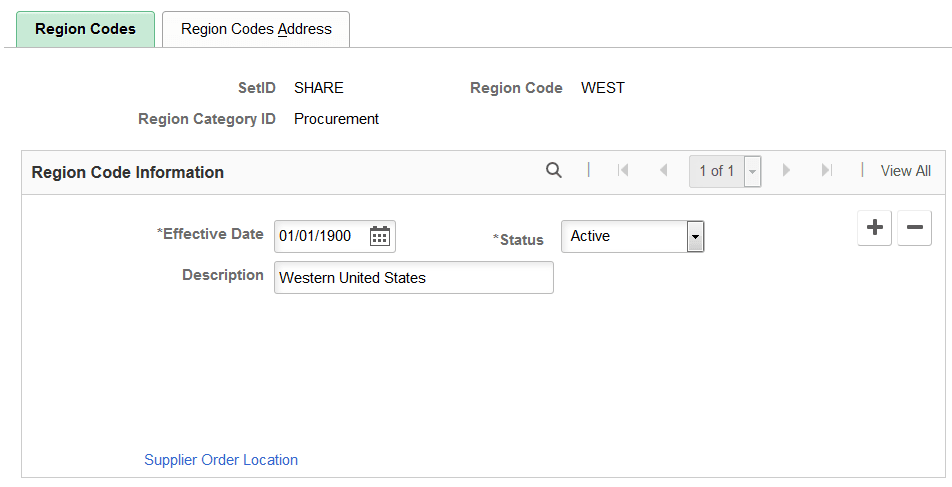

This example illustrates the fields and controls on the Region Codes page.
Regions can be physical entities or geographical areas. When a region represents a physical entity, the region code has the same characteristics as a business, that is, address and language.
When you create a new region code, the system prompts you for a region category ID. The Region Category ID determines which fields display on the Region Codes page. PeopleSoft provides the following Region Category ID values:

Use the Procurement value for regular procurement regions. If you want to set up alternative region types for the region codes, use the Region Types page.

Supplier Order Location |
Click this link to access the Procurement Region Supplier Order Location, where you can select an appropriate supplier SetID, supplier ID, and supplier location for a specific region. This link appears when you select Procurement for Region Category ID. |

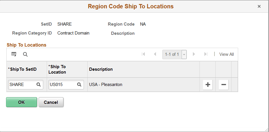

Ship To Location |
Click this link to access the Region Code Ship To Locations page, where you can identify multiple Ship To locations within a designated contract domain. This information helps control access and pricing on contracts by business unit, contract domain, and ShipTo. This link appears when you select Contract Domain Region Category ID. |

Use the Region Code Ship To Locations page (REGION_SHIPTO) to identify multiple Ship To locations within a designated contract domain.
Navigation:
Click the Ship to Location link on the Region Codes page.
This example illustrates the fields and controls on the Region Code Ship To Locations page.
Add a line for each Ship To location you wish to include with the contract domain. Include the Ship To SetID and Ship To Location for each line.
