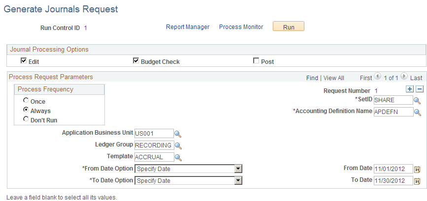

Use the Generate Journals Request page (JRNL_GEN_REQUEST) to initiate Journal Generator processing.
Navigation:
This example illustrates the fields and controls on the Generate Journals Request page. You can find definitions for the fields and controls later on this page.
Journal Processing Options Group Box
Field or Control |
Description |
Edit |
Select this check box to run the Journal Edit process. No prerequisites are required. |
Budget Check |
Select this check box to run the Budget Check process. You must run the Journal Edit process before running this budget check. |
Post |
Select this check box to run the Post process. You must run edit and budget check before posting. |
Note: If you select none of these check boxes, no additional processes are run.
Process Request Parameters
Field or Control |
Description |
Request Number |
To identify the process request, the system assigns this unique number to each run. You can create multiple requests. Use the scroll arrows to view requests already set up for the current user ID and run control ID. |
SetID |
This is required to extract the accounting entry definition for the request. |
Accounting Definition Name |
Identify which accounting entry definition the system should use when it creates the journal header and lines. |
Application Business Unit |
Journal Generator:
The application business unit can be other than the general ledger business unit. The prompt for this field depends on the system source of the accounting definition name. For example, if the system source of the accounting definition is JrnlGen-AP, Journal Generator uses the Payables business unit table. If the system source is JGen-Other, no prompt table is available. |
Ledger Group |
Journal Generator creates journal entries for the specified General Ledger ledger group. |
Template |
Journal Generator creates journal entries for the specified journal generator template. The SetID of the prompt values is derived from the SetID entered earlier on the page. |
From Date Option |
Select a value to further define which accounting entries Journal Generator extracts with this request. Journal Generator compares these dates to the accounting dates associated with each accounting entry. Select from the following values: Specify Date: Uses the date specified to identify the period. Current Date: Uses the date on which Journal Generator is run. Begin Date - From Period: Uses the beginning date of the from period in the ledger. Begin Date - To Period: Uses the beginning date of the to period in the ledger. No From Date: Uses all open dates of the ledger before the chosen to date. This means that the system processes all dates up to the date in the To Date field. Process Date: Date specified on the business unit journal process date option. It can be a specified date defined on the business unit, or it can be the current date. |
From Date |
Enter a to date if Specify Date is selected in the From Date Option field. |
To Date Option |
Select a value to further define which accounting entries Journal Generator extracts with this request. Journal Generator compares these dates to the accounting dates associated with each accounting entry. Select from the following values: Specify Date: Uses the date specified to identify the period. Current Date: Uses the date on which Journal Generator is run. End Date - From Period: Uses the ending date of the from period in the ledger. End Date - To Period: Uses the ending date of the to period in the ledger. Process Date: Date specified on the business unit journal process date option. It can be a specified date defined on the business unit, or it can be the current date. |
To Date |
Enter a to date if Specify Date is selected in the To Date Option field. |
