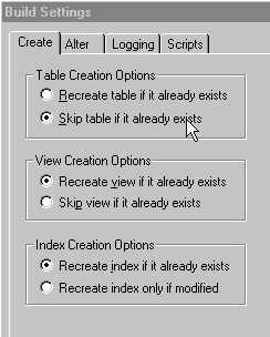

Build the objects in the project listed on the report. Verify the Build Settings by selecting the Create tab on the Build Settings page:
Verifying Build Settings: Create tab

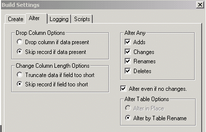

Select the Alter tab to verify build settings:
Verifying Build Settings: Alter tab
Acknowledge any warning messages by clicking OK.
