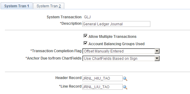

Use the System Transaction Page 1 page (IU_SYS_TRAN) for customizing interunit and intraunit transactions. Do not make changes to this page unless you are customizing this process.
Any change you make to this page is a customization of the system. Access to this page is for information only or in the rare event that you intend to implement a customization to your system. System Transactions are predefined and delivered with the system for transactions that can generate inter and intraunit entries
Navigation:
This example illustrates the fields and controls on the System Transaction Page 1. You can find definitions for the fields and controls later on this page.
Note: Do not make changes to any of the system transactions pages unless you intend to implement a customization.
Field or Control |
Description |
Allow Multiple Transactions |
As delivered, this check box is selected for and is applicable only to General Ledger. It enables you to define additional Transaction Codes and associate or map them to the delivered System Transaction for the General Ledger product. |
Account Balancing Groups Used |
As delivered, this check box is selected for and is applicable only to General Ledger. It indicates to the processor that the accounting entries on the input record could include accounts with attributes other than the default values. |
Transaction Completion Flag |
This option determines how the processor calculates the base currency amounts on the interunit balancing entries for the anchor business unit when the corresponding nonanchor business unit has a different base currency. If the option is set to Offset Manually Entered, then the processor calculates the base currency amount by converting the foreign currency amount using the exchange rate retrieved from the market rates table. If the option is set to Offset System Generated, the processor assumes that the original entries were functionally balanced. It then calculates the base currency amount for the balancing entries for the anchor unit using an allocation of the total base currency amounts on all of the original entries for the anchor unit. |
Anchor Due To/Due From ChartFields |
There are three possible values:
Header Record and Line Record |
The names are for prompting only. The actual record and line names are passed to the inter and intraunit processor at run time. |

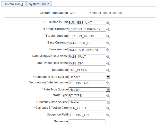

Use the System Transaction Page 2 page (IU_SYS_TRAN2) to make customizations to interunit and intraunit transaction processing. Do not make changes to this page.
Navigation:
This example illustrates the fields and controls on the System Transaction Page 2 (1 of 4). You can find definitions for the fields and controls later on this page.
Field or Control |
Description |
Sequence Field |
Name of the field on the line record that must be incremented for the new balancing entries created by the processor, if applicable. |
Sequence |
Leave this field blank if the Sequence Field is blank, or if you want the processor to continue numbering based on the last sequence number used on the original input entries for each document group. Specify a value if you want the inter and intraunit balancing entries to always begin sequencing with a fixed value. Sequence numbers assigned by the processor are typically consecutive. However, for multibook ledger group lines, it is normal to have gaps in the sequence numbers. |

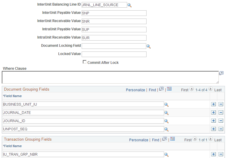

InterUnit Balancing Line ID |
The name of the field on the line record that identifies the type of entry, if applicable. |
InterUnit Payable Value |
The value to be populated in the InterUnit Balancing Line ID field for the intraunit (or InterEntity and IntraEntity) payable balancing entries generated by the processor. |
InterUnit Receivable Value |
The value to be populated in the InterUnit Balancing Line ID field for the intraunit (or InterEntity and IntraEntity) Receivable balancing entries generated by the processor. |
IntraUnit Payable Value |
The value to be populated in the InterUnit Balancing Line ID field for the intraunit payable balancing entries generated by the processor. |
IntraUnit Receivable Value |
The value to be populated in the InterUnit Balancing Line ID field for the intraunit (or InterEntity and IntraEntity) receivable balancing entries generated by the processor. |
Document Locking Field |
Name of the field that is used to logically lock the transaction while it is being processed. |
Commit After Lock |
Selected to commit the data after updating the Documenting Locking Field. |
Where Clause |
Static part of the selection criteria. The Where Clause can refer to fields on both the line record and the optional header record. All references to fields from the line record use the record alias LN_A and all fields from the header record use the record alias HDR. |
Document Grouping Fields |
The list of fields that together define a unique document, such as a general ledger Journal or an accounts payable voucher. If the optional Header Record is used, then the Document Grouping Fields must come from the Header Record. Otherwise, the fields come from the Line Record. |
Transaction Grouping Fields |
List of fields that identify unique transaction groups within a document. Transaction grouping fields are optional unless you want to use a transaction level status. You do not repeat the Document Grouping fields in this section. |

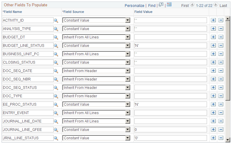

Other Fields to Populate |
List other fields on the line record that are not defined elsewhere on this page, and specify how they are to be formatted on the new inter and intraunit balancing entries created by the processor. |
Field Name |
The name of the field to be populated. Fields that are not be listed here include any field that is specified elsewhere on the System Transaction, including:
Note: Currency Effective Date can be specified in the Other Fields to Populate definition as long as it is not the same field as the Accounting Date.
Field or Control |
Description |
Field Source |
Specify how the field is to be populated. Valid values include:
Field Value |
When the Field Source is Constant Value, specify the value to be populated in the Field. |

If the calling application supports PeopleSoft MultiBook processing, then the application typically generate accounting entries for both the primary and secondary ledgers prior to calling the processor. In this case, one entry for the primary ledger and all of its corresponding secondary ledger entries are all flagged as anchor entries for each transaction group (or document group if transaction group-by fields are not used).
The following is an example from General Ledger of the type of parameters provided at run-time when calling the Central Inter/IntraUnit Processor:
Field or Control |
Description |
JRNL_HEADER |
Header record name |
JRNL_HEADER |
Header Update record name |
JRNL_LN joined with JRNL_HEADER |
Line record name |
JRNL_LN |
Line Update record name |
JRNL_LN or JRNL_LN_TMP |
Line Insert record name Uses JRNL_LN_TMP if additional manipulation is needed. For example, re-assigning Journal Line numbers before inserting to JRNL_LN. |
Additional WHERE clause for the journals. |
Dynamic selection criteria |
Process Business Unit |
Process one business unit at a time |

The following fields in the JRNL_HEADER table support calling of the interunit processor:
Field or Control |
Description |
IU_SYS_TRAN_CD |
InterUnit System Transaction Code, for example GLJ. |
IU_TRAN_CD |
InterUnit Transaction Code, for example JOURNAL and EXPALLOC. |
The following fields on the JRNL_LN table must be populated properly before calling the Iinter and intraunit processor:
Field or Control |
Description |
IU_ANCHOR_FLG |
Indicates which journal line contains the Anchor Business Unit value or anchor ChartField value. |
IU_TRAN_GRP_NBR |
Groups a set of journal lines as a set of intraunit transactions. |
