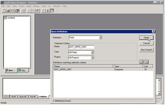

Create a work field for each new ChartField for which you want to secure using ChartField Security. These work fields are used as placeholders for the prompt edit tables that are dynamically assigned at runtime by the online processes.
To create a new work field for the new ChartField, clone an existing work field using Application Designer - Open Definition:
This example illustrates the fields and controls on the Application Designer - Open Definition (Field). You can find definitions for the fields and controls later on this page.
Field or Control |
Description |
Definition |
Select Field to open a field that you can clone for your new work field. |
Name |
As your selection criteria for the field, enter a prefix of EDIT_ to retrieve a list of work fields from which to select. |
Open |
Click this button to retrieve a list of fields from which to select. Open an existing field, such as EDIT_OPER_UNIT, by double-clicking. |
Click the Save icon and save as EDIT_<new ChartField name>. For example, if the new ChartField name is CFQ, then save the new work field as EDIT_CFQ. The work field must start with "EDIT_". It is not imperative, however, to include the new ChartField name in the work field name. Choose a concise and meaningful suffix. Do not change any of the field attributes, such as Field Type, Field Length, or Field Labels.

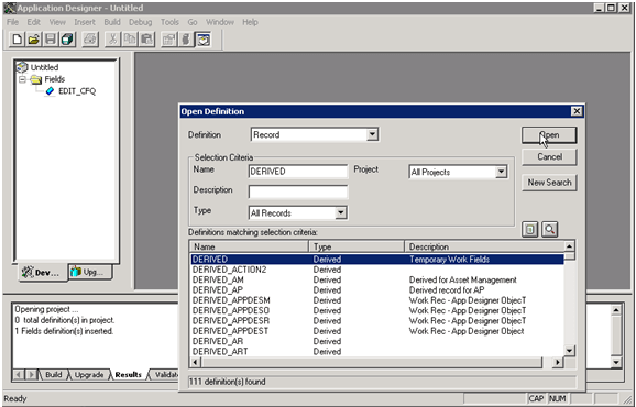

Add the new work field that you created for a customized ChartField to the work record, DERIVED, using PeopleTools Application Designer. This is a common work record that is used by the Financials and Supply Chain Management online pages.
To add the new work field to the DERIVED work record, access the record using PeopleTools Application Designer - Open Definition:
This example illustrates the fields and controls on the Application Designer - Open Definition (Record). You can find definitions for the fields and controls later on this page.
Field or Control |
Description |
Definition |
Select Record to retrieve the work record, DERIVED. |
Name |
As your selection criteria for the field, enter the record name, DERIVED and click the Open button to retrieve the record. |
Double-click the DERIVED record from the search result grid to open the record. Add the new work field or fields that you created in the first step. The field position within the record definition is not important. Save the record.

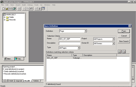

Add the new work field that you created for a customized ChartField to the ChartField Security SEC_CF_SBP sub page and the INV_SEC_CF_SBR secondary page using PeopleTools Application Designer. These pages are used by the online pages that support ChartField Security.
To add the new work field to the sub page and secondary page, access each within PeopleTools Application Designer - Open Definition:
This example illustrates the fields and controls on the Application Designer - Open Definition (Page). You can find definitions for the fields and controls later on this page.
Field or Control |
Description |
Definition |
Select Page to retrieve the sub page or secondary page. |
Name |
As your selection criteria, enter the page name, SEC_CF_SBP or INV_SEC_CF_SBR and click the Open button to retrieve the page. |
Double-click the page from the search result grid to open it. Expand the page to fill the window so that you can add the work field. Perform the following steps on each page to add the new work field:
From the Application Designer menu at top, select Insert, Edit Box.
Add the edit box to each page (SEC_CF_SBP) and (INV_SEC_CF_SBR).
Double-click the edit box to open the Edit Box Properties window and select the following values:
Record Name - DERIVED
Field Name - <new work field>
From the Label tab, select None for the Type.
From the Use tab, select the Display Only and Invisible check boxes.
Save the pages.

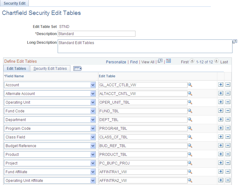

Use the ChartField Security Edit Tables page to add the new ChartField prompt edit views to the Chartfield Security Edit Tables component.
Navigation:
These views are used by the prompt edit list in the transaction online pages that support ChartField Security.
This example illustrates the fields and controls on the ChartField Security Edit Tables - Edit Tables. You can find definitions for the fields and controls later on this page.
Select the new ChartField, associated edit table and security edit tables from this component (SEC_EDIT_TBLS). Modify both delivered Edit Table Sets for Standard (STND) and GL Business Unit (BUGL).
Edit Tables
Field or Control |
Description |
Field Name |
Select the new ChartField from the prompt list. |
Edit Table |
Select the ChartField table from the prompt list. |
Select the ChartField Security views for the user, role and permission list. These views are created by the ChartField Configuration process.
