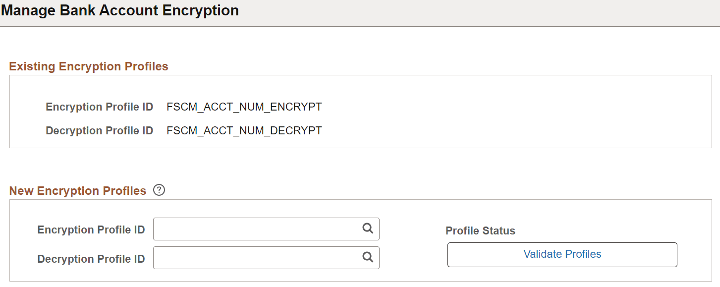

Use the Manage Bank Account Encryption page to re-encrypt the bank account numbers stored in the database with a new profile ID.
Navigation:
This example illustrates the fields and controls on the Manage Bank Account Encryption page
The Manage Bank Account Encryption page is editable only when the existing Bank Account Encryption process is run.
The existing encryption and decryption profile ID's are populated automatically. Enter the new encryption and decryption profile ID's. Validate the profiles and run the process similar to the Bank Account Number Encryption page.
When running this process, make sure that other processes are not running as this process updates many tables and data could be compromised.
