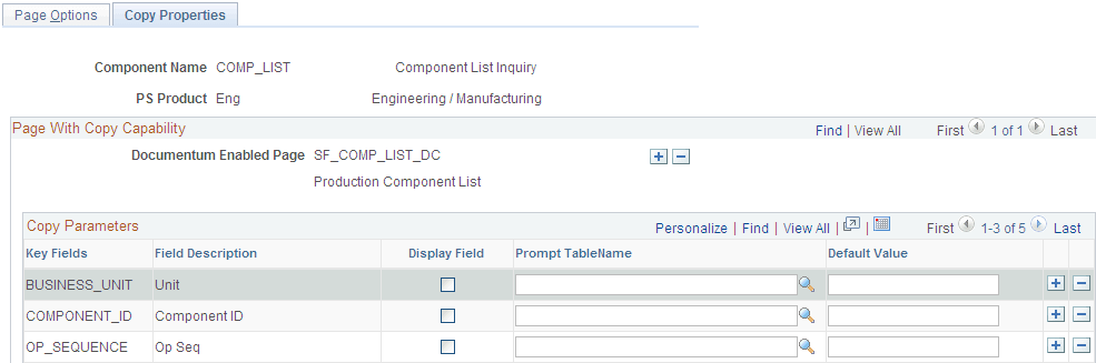

Use the Copy Properties page (DC_PNL3_OPT) to control the prompting behavior for key fields related to Documentum-enabled pages.
Navigation:
This example illustrates the fields and controls on the Documentum Page Options - Copy Properties page. You can find definitions for the fields and controls later on this page.
The selections on this page determine what you see when you click the Copy Document Associations button on a Documentum-enabled page. These copy properties are preset for you for all existing Documentum-enabled pages and need not be modified.
Field or Control |
Description |
Key Fields |
Displays key fields for the link record. |
Display Field |
Determines if a key field appears at copy time for the Documentum-enabled page. |
Prompt Table Name |
Displays the prompt table or view that the system uses to display valid values for the key field when you copy from the Documentum-enabled page. |
Default Value |
The system uses this value for display purposes at copy time. |
The combination of display field and default value gives you the flexibility to predefine copy options. For example, clearing the display field and defining a default value of PR for the key field BOM_STATE ensures that only production BOM document associations are copied.
Warning! Copy properties are preset for all existing Documentum-enabled pages and, in most cases, should not be modified. Incorrectly modifying values on this page can cause unpredictable prompting results when you copy document associations.
