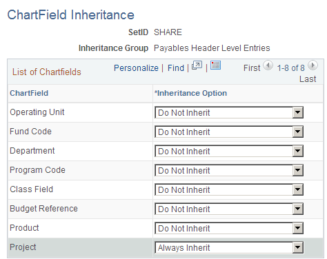

Use the ChartField Inheritance page (CF_INHERIT) to maintain the Inheritance Options for an Inheritance Group.
Navigation:
This example illustrates the fields and controls on the ChartField Inheritance page. You can find definitions for the fields and controls later on this page.

Inheritance Group |
Along with SetID, this it is a key field for the table. PeopleSoft delivers the following predefined Inheritance Groups for its various products:
ChartField |
The page is pre-populated with the fully and partially configurable ChartFields other than Account, Alternate Account and the Affiliates. Account and Alternate Account are not available for inheritance and Affiliate values are automatically supplied by the system. |
Inheritance Option |
The following ChartField Inheritance options apply to all Inheritance Groups:
Some Inheritance Groups have edits that restrict which inheritance options are valid for each ChartField, often based on whether or not the ChartField is balanced. Refer to the next section for details. |
