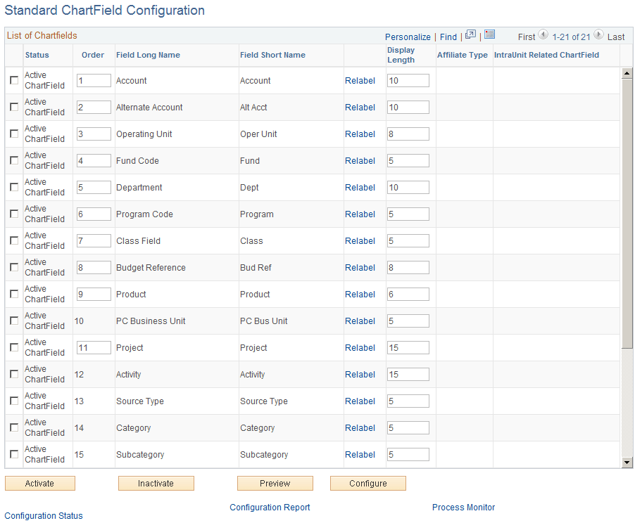

Use the Standard ChartField Configuration page (STANDARD_CF_TMPLT) to perform Standard ChartField Configuration such as changing display order, changing display length, relabeling, and activating or inactivating a ChartField.
Navigation:
Alternatively, you can select the Standard Configuration tab on the Advanced Configuration page.
This example illustrates the fields and controls on the Standard ChartField Configuration page. You can find definitions for the fields and controls later on this page.
This page initially displays the ChartFields as delivered.
