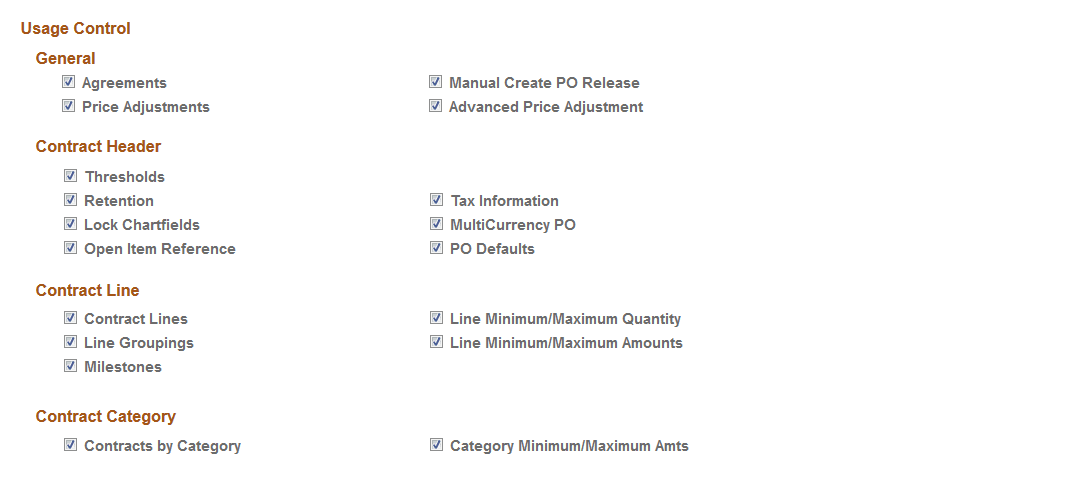

In addition, contract style enables you to simplify contract creation by managing the fields that appear on the contract. You can limit the contract fields that display on the contract using the field-control options associated with delivered structure types.
Each delivered structure type provides a unique set of field-control options and automatically excludes options not relevant to that structure type. The following is an example of field-control options available on the Contract Style page:
This is an example of field-control options available on the Contract Style page.
Note that each group box represents a section of the contract. And each group box has field-control options that correspond to specific fields on the contract. All field-control options are selected by default, but if you do not want to include a field on the contract, simply deselect the option and it will not appear when the contract style is used.

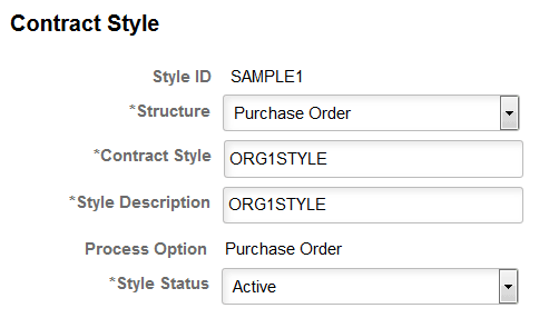

You associate a delivered structure type with a contract style and contract process option, thereby determining which fields appear on the contract whenever a new one is created. The following is an example of a structure type/contract style combination.
This is an example of the structure type/contract style combination

Style ID |
Displays the style ID you entered for the contract. This ID can accommodate up to 10 characters. |
Structure |
Select a structure type from the set of predefined structures in the system data. Values include:
Contract Style |
Enter a name for your contract style. This name can accommodate up to 30 characters. Note: The Style ID and Contract Style are interchangeable, when you are on the procurement pages. Contract Style appears as the field name, but in some cases the Style ID appears in the selected prompt search result. The Contract Style is used as the title for the fluid page and also appears on the procurement contract and supplier contracts pages. |
Style Description |
Displays the style description used for the contract. |
Process Option |
For procurement contracts this displays the process option that corresponds to the structure type. |
Style Status |
You can choose to inactivate or activate the status. This field is Active by default. Once a contract style is inactivated you will still be able to maintain contracts using this contract style but you will not be able to create new contracts or documents using this style. |

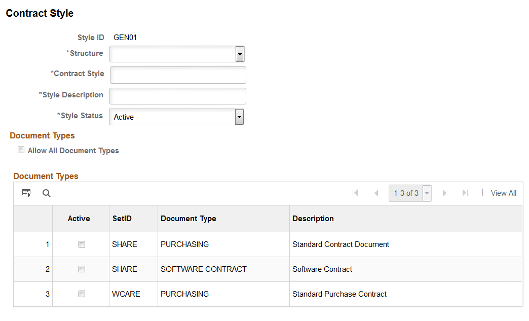

Document Types
This section appears when Supplier Contracts is installed and you are using Document Types. Select the Allow All Document Types option to enable this contract style to work with all Supplier Contract Document Types.
If you do not select the Allow All Document Types option, the system displays the available document types and you can activate the ones you want to work with this contract style. If a Document Type is activated, and then later inactivated, it will prevent any new documents from being created using that combination of contract style and Document Type. You must have at least 1 active Document Type selected if the Allow All Document Types is checked
Once a Contract Style has been used on a document, the Document Type used for that document cannot be removed from the Contract Style.
Usage Control
Use this group box to manage user access to contract fields using the available field-control options.
PeopleSoft provides the following field-control options:

These options correspond to specific fields on the contract.
Select an option to include the corresponding fields on the contract. Deselect an option to exclude the corresponding fields on the contract.
Note: The structure type determines the field-control options available to you. Some structure types do not include all field-control options.
