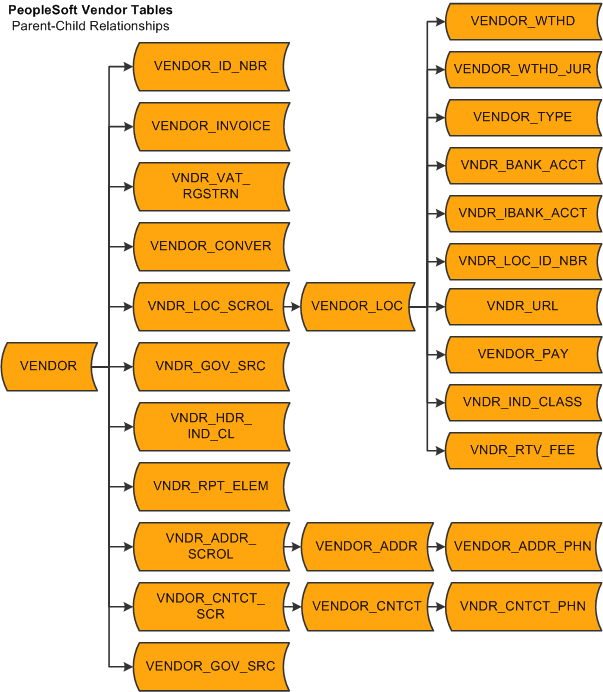

This diagram shows the organization of supplier tables in parent-child relationships:
