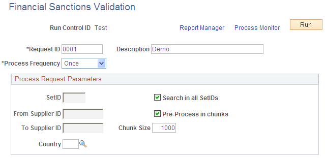

Use the Financial Sanctions Validation page (OFAC_RPT_RQST) to enter run control parameters and request a run of the Financial Sanctions Validation Application Engine process (AP_SDN_VAL).

This example illustrates the fields and controls on the Financial Sanctions Validation page. You can find definitions for the fields and controls later on this page.
PeopleSoft provides validation of your suppliers against financial sanctions lists at the supplier, voucher, and payment levels, depending on how you enable financial sanctions validation. You can also schedule a batch process, the Financial Sanctions Validation process, to validate your suppliers.
Note: If No Validation is selected on the Financial Sanctions Options page, and a file has been loaded, the system does not validate suppliers at any transaction level. Therefore, the system could pay a supplier who is a potential match to the financial sanctions list.
See Understanding Financial Sanctions Validation.
Field or Control |
Description |
SetID and Search in all SetIDs |
Enter a specific SetID or select all SetIDs for the suppliers to be validated. |
From Supplier ID to To Supplier ID |
Enter a single Supplier ID or a range of suppliers to be validated. |
Country |
Enter a country code of suppliers to be validated. |
