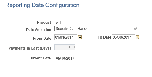

You set up the reporting date configuration and update process by:
Setting the date selection information on the Reporting Date Configuration page.
Running the Reporting Date Update Process to enable the tile preferences. Access the Reporting Date Update Process page by using the navigation:
Set Up Financials/Supply Chain, Operational Reporting, Operational Efficiency, Reporting Date Update Process.
Use the Reporting Date Configuration page (OPI_SYSCFG_PG) to enter your date selection information.
Navigation:
This example illustrates the fields and controls on the Reporting Date Configuration page.
