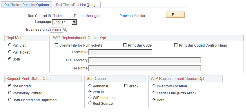

Use the Pull Ticket/Pull List Options page (RUN_FPS6500) to indicate how you want to print pull tickets and pull lists.
Navigation:
This example illustrates the fields and controls on the Pull Ticket/Pull List Options page. You can find definitions for the fields and controls later on this page.
Field or Control |
Description |
WIP Replenishment Output Opt |
Choose one of the three options for the WIP Replenishment Output Options.
Note: PeopleSoft delivers printer settings for all SQR output to a generic line printer. However, when printing bar coded information on reports on a PCL printer (HP Laser Jet), you must first define the printer type accordingly. You may do this by changing the printer type settings delivered in SETENV.SQC from LINEPRINTER to HPLASERJET. |
Format ID |
Select a Format ID for the extract file. You set up format IDs on the Data Collection Label Setup page. |
File Directory and File Name |
Enter the File Directory and File Name to which you want to save the pull ticket file extract. |
Request Print Status Option |
Select a Request Print Status Option: Not Printed, Previously Printed, or Both Printed and Unprinted. |

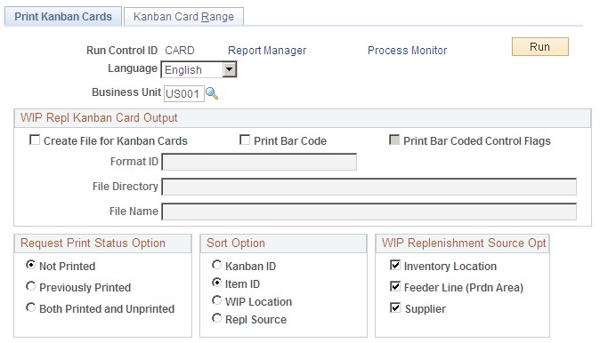

Use the Print Kanban Card page (RUN_FPS6510) to print Kanban Card labels.
Navigation:
This example illustrates the fields and controls on the Print Kanban Cards page. You can find definitions for the fields and controls later on this page.
Field or Control |
Description |
WIP Repl Kanban Card Output |
Choose one of the three options for the WIP Replenishment Kanban Card Output options.
Format ID |
Enter the File Directory and File Name to which you want to save the Kanban card file extract. |
If you print Kanban cards that haven't been previously printed, the system changes the Kanban ID status to Open from New. Cards that were previously printed display Reprint on the card.

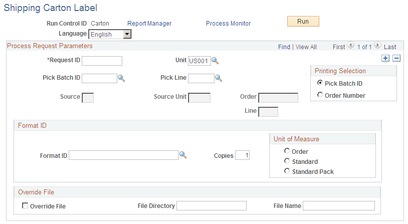

Use the Shipping Carton Label page (RUN_INS6025) to select the process request parameters for shipping carton labels.
The shipping carton labels can be automatically printed during picking.
Navigation:
This example illustrates the fields and controls on the Shipping Carton Label page. You can find definitions for the fields and controls later on this page.
If the format ID is not entered, it automatically appears first from the ship to location, then from the sold to location, or then from the Label Setup page, in that order, depending on which of these values exist.
To specify a file directory and file name for the label extraction file, select the Override File check box, and enter the file directory and file name. Deselect the Override File check box to create the extraction file in the default directory with the default file name.
To select the directory for the carton label file, use the following hierarchy:
The path you specify for the file directory takes precedence.
If you do not specify a file directory, the directory automatically appears the Pick Plan Bar Coding Options page in the Setup Fulfillment component (ORDER_FULF_SETUP).
If no directory is specified on the Pick Plan Bar Coding Options page in the Setup Fulfillment component, the directory name is the FILEPREFIX that was specified in SETENV.SQC during the initial system setup.
For information on setting the FILEPREFIX in the SETENV.SQC, refer to the installation documentation.
If no FILEPREFIX was specified during system setup, the directory name defaults to the current directory where the label program is running.
To name the file for the carton label file, use the following hierarchy:
The file name specified in the File Name field takes precedence.
If you don't specify a file name, the file name is the file prefix defined on the Pick Plan Bar Coding Options page in the Setup Fulfillment component combined with the last five digits of the process ID and the file suffix defined on the Pick Plan Bar Coding Options page.
If nothing is specified on the Pick Plan Bar Coding Options page, the last five digits of the process ID are used as the file name and the file name suffix is the FILESUFFIX that you specified in SETENV.SQC when you initially set up the system.
For information on setting the FILESUFFIX in the SETENV.SQC, refer to the installation documentation.

Use the Shipping Serial Label page (RUN_INS6035) to select the process request parameters for shipping serial labels.
If you assign a shipping serial label ID at shipping time, you can track items after they have been shipped.
