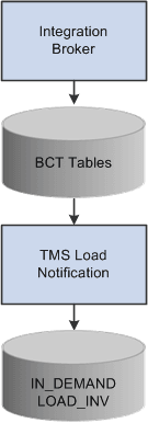

This diagram shows the process flow of data from the TMS to PeopleSoft Inventory. The PeopleSoft Integration Broker processes the incoming transaction data from the Load Notification service operation and places the data in the BCT staging tables. The TMS Load Notification process pulls the data from the BCT tables and updates the PeopleSoft Inventory tables: IN_DEMAND and LOAD_INV:

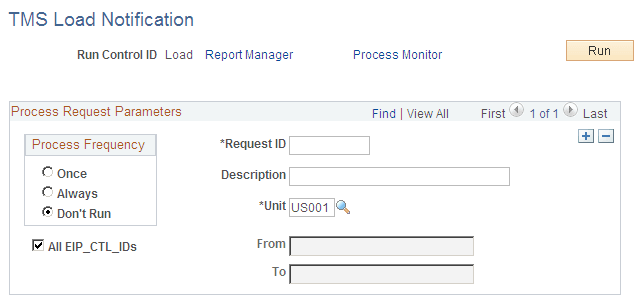

Use the TMS Load Notification page (BCT_INV_TMSLOAD) to launch the IN_TMSUPLOAD Application Engine process, which pulls the TMS transactional data from the BCT tables and updates IN_DEMAND and LOAD_INV.
Navigation:
SCM Integrations, Process Transactions, Inventory, TMS Load Notification
This example illustrates the fields and controls on the TMS Load Notification page. You can find definitions for the fields and controls later on this page.
The TMS_ LOAD_NOTIFICATION EIP pulls TMS information from the BCT tables and performs error checking.

Field or Control |
Description |
All EIP_CTL_IDs |
Select this option to process all EIP control IDs from the BCT tables. This option will process all of the transactional data that has a status of New or Reprocess. |
From and To |
Enter the specific EIP Control ID. These fields have search buttons when the All EIP_CTL_IDs option is not selected. |
