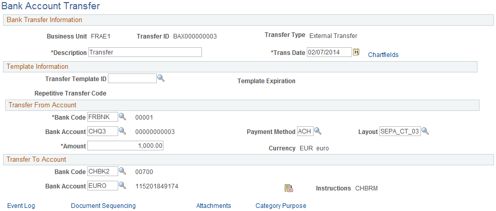

Use the Bank Account Transfer page (BAX_TRANSFER_PNL) to initiate bank transfers for internal or external bank transfers.
Navigation:
This example illustrates the fields and controls on the Bank Account Transfer page.

To create external bank account transfers:
Select the Add a New Value tab on the Bank Account Transfer search page.
Enter values in the Business Unitand Transfer ID fields, and specify a value of External Transfer in the Transfer Type field.
Click Add.
Enter a description.
Create external bank account transfers from a template or on an ad hoc basis:
Select a transfer template ID to automatically populate the external bank account transfer with information. If you create an external bank account transfer from a template, you can also click the Chartfields link to edit the bank transfer ChartFields.
Leave the Transfer Template ID field blank to create an ad hoc bank account transfer. Complete the remaining fields on the page. If you create an ad hoc external bank account transfer, you cannot modify the bank transfer ChartFields.
Click the Instructions button to review the settlement instructions. The settlement instructions define how the payment or transfer is made—the system uses the deposit instructions from the bank account that is receiving funds (the Transfer To Account bank).
Save the transfer.

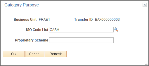

Use the Category Purpose page (CAT_PURP_BAX) to identify the high-level purpose of the payment instruction based on a set of predefined categories as per ISO 20022 external code list or a proprietary scheme name.
Available only for SEPA transactions.
Navigation:
Click the Category Purpose link on the Bank Account Transfer page for a SEPA transaction.
This example illustrates the fields and controls on the Category Purpose page.

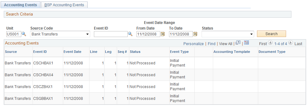

Use the Accounting Events page (TRA_EVENT_CAL) to view summary accounting event information generated from deals, facility fees, and bank transfers.
Navigation:
This example illustrates the fields and controls on the Accounting Events page. You can find definitions for the fields and controls later on this page.
Enter Bank Transfers in the Source Code field to view the scheduled accounting event.
