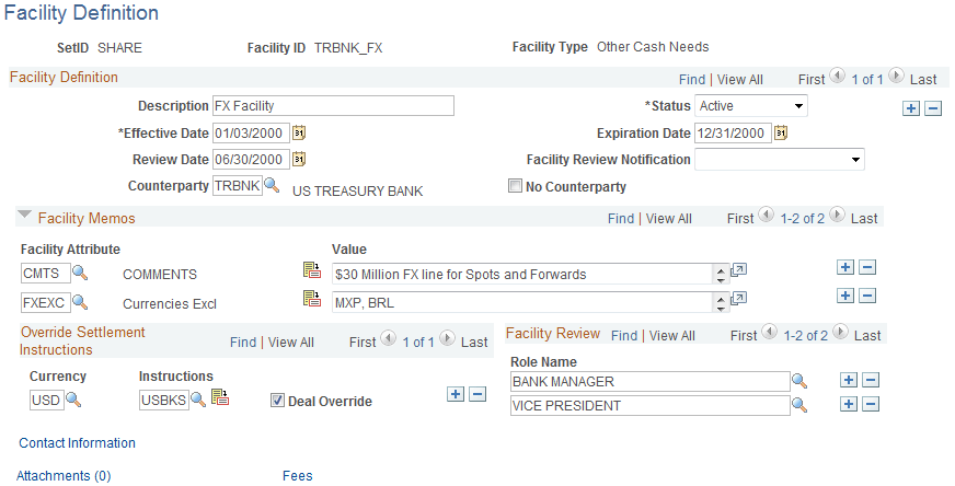

Use the Facility Definition page (FCLTY_PNL1) to define a facility.
Navigation:
This example illustrates the fields and controls on the Facility Definition page. You can find definitions for the fields and controls later on this page.
Note: Since facilities are generally associated with a particular counterparty, you may want to incorporate the counterparty code in the Facility ID field so that it's easy to distinguish between facilities.
Facility Definition
Field or Control |
Description |
Counterparty |
Select the associated counterparty. For facilities that do not have specific counterparties, such as commercial paper, select the No Counterparty check box, which disables the Counterparty field. |
Review Date |
Enter the date the facility will be up for review. This is the date that the role names specified in the Facility Review grid receive PeopleSoft Workflow notification. |
Facility Review Notification |
Choose the notification type for processing the facility review:
Note: If you add a Role Name to the Facility Review grid, and save the facility definition without choosing a facility review notification type, the system defaults to Notification Framework. |
Expiration Date |
Enter the date the facility is scheduled to expire. |
Fees |
Click this link to record fees associated with the facility. |
Facilities Contacts
Field or Control |
Description |
Contact |
Enter the ID number. The name, contact title, and phone number are automatically populated from the Financial Contacts page. |
Contact Information |
Click to view and edit the Financial Contacts page (TR_CONTACT_PNL). |
Facilities Memos
Field or Control |
Description |
Facility Attributes |
The COMMENTS attribute automatically appears; enter information about the facility in the Value field. |
Click the Expand Long icon to view the entire Value description. |
Override Settlement Instructions
Indicate how funds should be settled for transactions using this facility.
Field or Control |
Description |
Deal Override |
Select to permit these instructions to be overridden at deal entry. |
Instructions |
Specify settlement instructions, which are defined on the External Accounts - Settlements Instructions page. |
Click the View Settlement Instruction icon to view settlement instruction details on the Settlement Instructions page (STL_INSTR_SP). The Settlement Instructions page displays the international bank account number (IBAN) in addition to the local, domestic bank account number when the country has been set up to display the IBAN on the IBAN Formats page. |
Facility Review
Field or Control |
Description |
Role Name |
Select the role name that receives PeopleSoft Workflow notification when the facility is up for review. |
