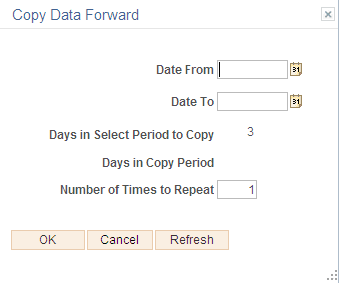

Use the Copy button to copy data forward. This example shows the Copy Data Forward fields:
This example illustrates the fields and controls on the Copy Data Forward page.

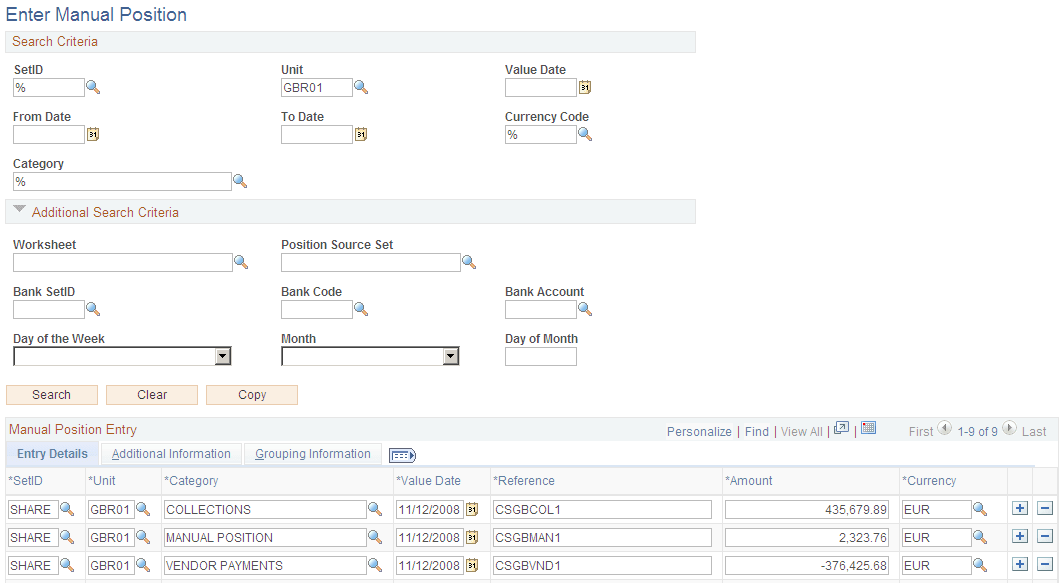

Use the Enter Manual Position page (MANUAL_POSN_ENTRY) to capture data that can then be added to a cash position or associated with a specific worksheet.
Navigation:
This example illustrates the fields and controls on the Enter Manual Position page. You can find definitions for the fields and controls later on this page.

Search Criteria
Enter search criteria, as your business needs require, for retrieving data.
Field or Control |
Description |
SetID |
Enter a SetID. |
Unit |
Enter a business unit. |
Value Date |
Enter a payment value date. |
From Date and To Date |
Enter a date range, including a starting date and an ending date. |
Currency Code |
Enter a currency code. |
Category |
Enter a category for grouping position source data that you defined as a worksheet line item. |
Additional Search Criteria
Enter additional criteria, as your business needs require, for retrieving data.
Field or Control |
Description |
Worksheet |
Enter a Worksheet associated with the SetID. |
Position Source Set |
Enter a Position Source Set associated with the Worksheet. |
Bank SetID |
Enter a SetID to identify bank information. |
Bank Code |
Enter a Bank Code associated with the Bank SetID. |
Bank Account |
Enter a Bank Account associated with the Bank Code. |
Day of the Week |
Enter a calendar day. |
Month |
Enter a calendar month. |
Day of Month |
Manual Position Entry Grids
Search results for the criteria you specified appear in the grids. You can manually add or delete rows or edit data that appear in the fields.
Field or Control |
Description |
SetID |
Enter a SetID. |
Unit |
Category |
Value Date |
Reference |
Enter reference that will be used when reference is mapped on the Position Source Mappings grid on the Position Source page. |
Amount |
Enter the amount that should be used by the Cash Forecast Calculations Application Engine (TR_CSH_FCST) process to calculate cash forecast amounts. |
Currency |
Enter a currency code. Note: All lines that are added to the Manual Position Entry grid must be of a currency for which an exchange rate is established; otherwise, the lines will not be included in the generation of the worksheet. Exchange rates are set on the Market Rates page. |

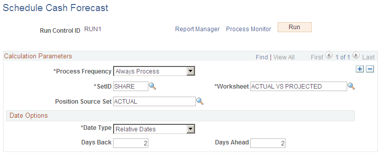

Use the Schedule Cash Forecast page (CSH_FCST_REQ) to run the Cash Forecast Calculations Application Engine (TR_CSH_FCST) process.
Navigation:
This example illustrates the fields and controls on the Schedule Cash Forecast page. You can find definitions for the fields and controls later on this page.
Calculation Parameters
Field or Control |
Description |
Process Frequency |
Specify the frequency with which the process or job is to be run. Choose from Always, Once, or Never. |
SetID |
Enter a SetID. |
Worksheet |
Enter the worksheet definition for which you would like to calculate the cash forecast (Worksheet Definition page). |
Enter a position source set that is delivered with your system or one that you defined on the Position Source Set page. |
Date Options
Field or Control |
Description |
Date Type |
Choose from these options:
