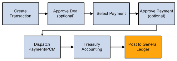

These diagrams illustrate the inbound and outbound transaction processes.
Inbound process from importing a transaction to Treasury Accounting to posting to General Ledger
Outbound process from creating transaction through payment dispatch and Treasury Accounting to posting to General Ledger

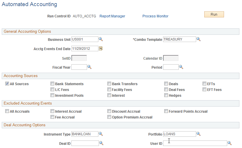

Use the Automated Accounting page (TRA_ACCTG_REQ) to run the Automated Accounting process, which creates accounting entries and prepares them for the Journal Generator (FSPGJGEN) process.
Navigation:
This example illustrates the fields and controls on the Automated Accounting page. You can find definitions for the fields and controls later on this page.
Field or Control |
Description |
Business Unit |
Enter a value to process automated accounting for a specific business unit. You can also leave the Business Unit field blank to set up automated accounting for multiple business units. If you enter a business unit defined with a calendar ID on the Treasury Options page, the calendar ID appears on the page. Note: Your system administrator can set up the option to issue a warning instead of an error message (13550, 70) for processing a single business unit using an Accounting Events End Date when the selected Business Unit is defined with a Calendar ID. This table provides an overview of the selections a user can make on the run control page and the accounting entries that the Automated Accounting Engine processes. |

Combo Template |
Enter a template ID for the combination of business unit and general ledger. |
Acctg Events End Date |
Enter an accounting events end date. The system processes all associated accounting events on or before the specified date. If a business unit has a calendar associated with it, you must leave this field blank and enter Fiscal Year and Period values. |
SetID |
Displays the SetID value associated with the Calendar ID that controls the Fiscal Year and Period. |
Calendar ID |
Displays the Calendar ID value that controls the Fiscal Year and Period. If you enter a business unit associated with a calendar ID on the Treasury Options page, that calendar ID will appear here. If the business unit has a calendar associated with it, you must enter Fiscal Year and Period values and leave the Acctg Events End Date field blank. |
Fiscal Year and Period |
Enter the Fiscal Year and Period values that will be used to determine the accounting events to be processed by Automated Accounting process. |
