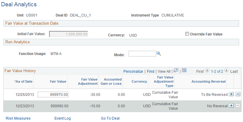

Use the Deal Analytics page (MTM_DEALVAL_PNL) to set up analytics for the deal.
Navigation:
This example illustrates the fields and controls on the Deal Analytics page, using an instrument type to calculate cumulative MTM.
Analytic functions based on the instrument type can also be set on a specific deal to track the effects of various types of market risk against the deal's fair value.

Fair Value History
Note: When you manually add a row to the Fair Value History grid, you should always click the Add button for the maximum As of Date row.
Field or Control |
Description |
As of Date |
Enter a date for the fair value. |
Fair Value |
Enter the market value as of the indicated date. |
Fair Value Adjustment |
Displays the system-calculated fair value adjustment. |
Accounted Gain or Loss |
Displays the accounted value that has been updated by the Treasury Accounting process. |
Currency |
Displays the currency used in the deal. |
Fair Value Adjustment Type |
Displays the fair value adjustment type associated with the deal, as defined on the Instrument Analytics page. |
Accounting Reversal |
Displays the status of the accounting reversal. |
Click the Delete Row icon to delete a mark to market adjustment only for the maximum dated row. If an accounting entry has already been created for that row, then the system schedules a reversal of the accounting entry at the end upon saving. You can delete only one row at a time. |

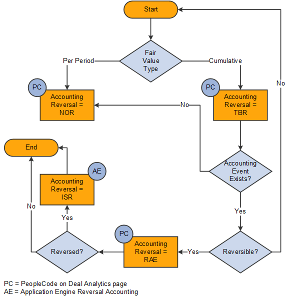

The diagram here illustrates the Mark to Market (MTM) Accounting process on the Deal Analytics page.
This diagram shows how the system updates the accounting reversal flag for mark to market adjustments.
The system populates the Accounting Reversal field programmatically through code associated with the Deal Analytics component and the Reversal Accounting process. The following values in the Accounting Reversal field identify fair value adjustment rows that should be reversed or not:
No Reversal: The system uses NOR to identify all fair value adjustment rows that do not require reversal or no accounting event.
To Be Reversed: The system uses TBR to identify all cumulative fair value adjustment rows that will be reversed in future.
Reverse Accounting Entry: The system uses RAE to identify all cumulative fair value adjustment rows that have to be reversed in the next Reversal cycle.
Is Reversed: The system uses ISR to identify all cumulative fair value adjustment rows that have already been reversed.
