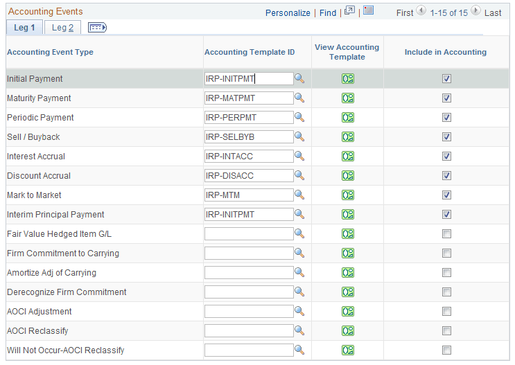

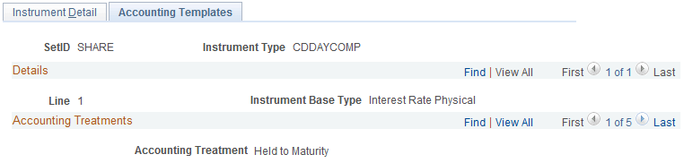

This example illustrates the fields and controls on the Accounting Templates page (1 of 2). You can find definitions for the fields and controls later on this page.
This example illustrates the fields and controls on the Accounting Templates page (2 of 2). You can find definitions for the fields and controls later on this page.
Note: The following accounting event types apply to all instrument base types: Mark-to-Market, Sell/Buyback, Deal Booking, and Deal Maturity. These event types are attached to instrument line 1 on the Accounting Entries page.
Field or Control |
Description |
Accounting Event Type |
Displays the accounting event type and associated accounting template ID default values. These vary depending on the instrument base type that you selected on the Instrument Detail page. |
Leg 1 and Leg 2 |
Specify different accounting templates for the accounting event types on each leg, if the instrument has multiple legs. |
Accounting Template ID |
Override the template ID that appears and enter another template. |
Include in Accounting |
Select the check box to identify the defined instrument and template relationship as eligible for automated accounting builds for the accounting event type that you specified. During processing, the system identifies the event as an error if you have not specified an accounting template ID. In this case, use the Accounting Events page to assign an accounting template ID and retry the automated accounting. You can alternatively process manual accounting for this event. If you do not select this check box, the instrument and template relationship is not eligible for automated accounting builds. |
Click the icon in the View Accounting Template column to open the Template page (TRA_TMPL_DETL), where you can review detailed information for a specific accounting template. Templates used for straight-discount deals should be different from the ones for interest-bearing deals. The Deal Amount must be one of the lines in the initial payment templates for straight-discount deals. Interest-bearing deals use Price. |
