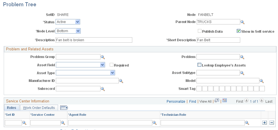

Use the Problem Tree page (WM_PROBLEM_TREE) to define each problem category and show the relationship between the problem category levels.
Navigation:
Set Up Financials/Supply Chain, Product Related, Maintenance Management, Problem Cause Resolution Setup, Problem Tree.
This example illustrates the fields and controls on the Problem Tree page. You can find definitions for the fields and controls later on this page.
Field or Control |
Description |
Status |
Select a status of either Active or Inactive for this node and node level. |
Parent Node |
Displays the name of the parent node, if applicable. Note: Normally you add child categories by selecting the Add Child Node button, which is only available from a parent node. Selecting the Add Child Node button copies the node value into the parent node of the new child record. This creates the link for you. However, you can change the parent node value of an existing record which effectively moves the child and all of the child's children to the new parent. |
Node Level |
Defines the level in the tree in which the problem category resides.
Top level categories display in the first Request Type page of the Service Request Wizard component and in the first Request Type field in the Request Detail group box of the single page Service Request page. Middle-level categories display in the subsequent Request Type pages of the wizard and in the subsequent Request Type field of the single page Service Request page. Bottom-level categories display in the last Request Type page of the wizard and in the last Request Type field of the single page Service Request page. You cannot change the node level for a middle node unless you delete all of its children first. You cannot change the node level for a top node level. Note: You can have as many levels as you want in a problem tree; however, Oracle recommends 3 to 5 levels. |
Show in Self-Service Component |
Select this check box to display the problem category in the Service Request Wizard and the single Service Request page. |
Publish Data |
Select this check box when you want to publish this problem tree branch as a message using Integration Broker to third-party help desk products. Note: This check box should only be available for selection for a top-level node. See documentation PeopleTools: Integration Broker |
