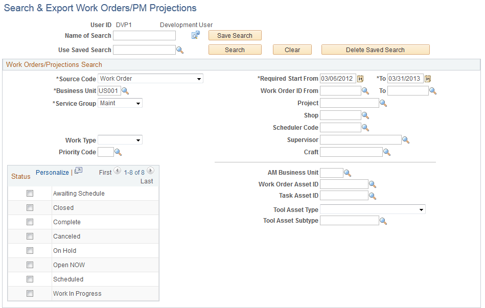

Search & Export Work Orders/PM Projections Page |
WM_MSP |
Integrate preventive maintenance projections and work orders into Microsoft Project for analysis. |

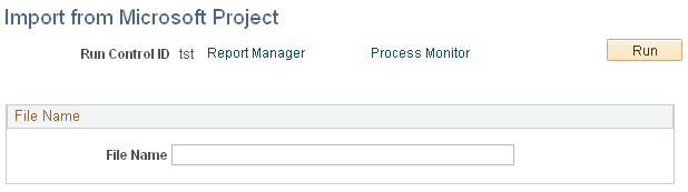

Using Preventive Maintenance Projections with Microsoft Project
If you want to analyze the projections using Microsoft Project, you can access the Microsoft Project Integration component and set up the search criteria to export data for either projection, work order, or both into Microsoft Project. If you export projections, you must enter the process instance ID for the particular projection run in the search criteria. After you enter the search criteria, you can save them and reuse them. Click the Search button, and a list of projections, work orders, or both appears. You can select the projection and work order data that you want to export to Microsoft Project, assign a name to the export file, and let the software insert key data for projection, work order, or both into the WM_MSP_AET_DAT using the WM_MSP_AE process for access by Microsoft Project.
Note: You cannot import projection data from Microsoft Project to PeopleSoft Maintenance Management. However, you can import other work order data such as some work order header and task data.

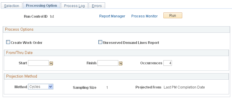

Use the Run Projection - Processing Options page (WM_PM_RUN_OPT) to define the processing options for preventive maintenance projections, which include creating a work order, the projection start and end dates, and selection of the projection method.
Navigation:
This example illustrates the fields and controls on the Run Projection - Processing Options page. You can find definitions for the fields and controls later on this page.
The Run Projection - Selection page is identical to the Run Preventive Maintenance - Selection page except for the Show Override Options only check box on the Run Preventive Maintenance - Selection page.
See Running the Preventive Maintenance Process.
Field or Control |
Description |
Create Work Order |
Select to create work orders that are identical to the previously generated and analyzed projections. Note: Typically, most users want to run the Preventive Maintenance Projection process first without selecting this check box. After analyzing the projections that are generated, they can select this check box and create work orders based on the same run control and criteria that were used to generate the projections. |
Unreserved Demand Lines Report |
Select this check box to enable a report showing the reservation exceptions to run. If you do not select this check box, the report will not run. |
Start |
Enter the date for the Preventive Maintenance Projection process from which to start generating the projections. If this field is populated, the Occurrences field is left blank. |
Finish |
Enter the date for the Preventive Maintenance Projection process from which to finish scheduling preventive maintenance. If this field is completed, the Occurrences field is left blank. Note: The generated projections fall between these start and finish dates. |
Occurrences |
Enter a number between 1 and 999. If you do not enter start and finish dates, then you enter the number of maintenance due dates that you want to include in the projections. The maximum number of projection occurrences is 999. If you complete this field, the Start and Finish fields are left blank. |
Method |
Select one of the following values:
Note: If you select a schedule on the Selection page, which uses Sampling as the Estimate Meter Usage method, then you can select one of these method values to override the one or more methods that you specified in the PM Schedule. The Preventive Maintenance Projection process uses the method that is selected here. You can also leave this field blank if you want to use the method that is selected for Sampling in the PM Schedule. |
Sampling Size |
If you selected Cycles, a 1 appears in this field. Cycles does not use a sampling size. For Days and Readings, enter the number of days that you want to include in the sampling size or the number of readings that you want to include in the sampling size. |
Projected From |
Note: If a primary schedule is included in the selection list and is linked to one or more secondary schedules, any associated secondary schedules are automatically selected for processing. |

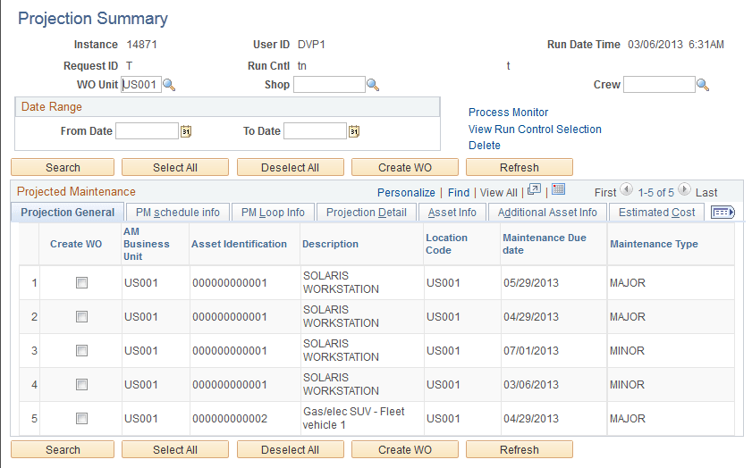

Use the Projection Summary page (WM_PM_PJC) to review a list of each of the preventive maintenance projections and their associated preventive maintenance schedules, and provides a link to the detail information for each projection.
Navigation:
This example illustrates the fields and controls on the View Projection Summary - Projection Summary page. You can find definitions for the fields and controls later on this page.
Field or Control |
Description |
Business Unit, Shop, and Crew |
Select the work order business unit, shop, and crew to narrow your search to work order projections to which a crew will be assigned. |
From Date and To Date |
Enter the date range for the projections that you want listed. |
Search |
Click the search button to list the projections based on your search criteria. You can enter both crew and date range criteria, if you want. |
View Run Control Selection |
Click to view the details of the run control options that were used when this process instance was generated using the Run Projection process. |
Process Monitor |
Click to view the Process List and Process Servers that are associated with the selected process instance. |
Create WO (create work order) |
Select the projections in the list for which you want the system to create work orders, and click the Create WO button. The new preventive maintenance work orders appear in the Work Order Search Results. When you click the Refresh button, the projections that are selected to create the work orders are removed from the grid. |
Projection General
Displays the AM business unit, asset identification, description, location code, maintenance due date, and maintenance type for each projection.
PM Schedule Info
Select the PM Schedule Info tab to view the information in the Projection General grid along with the work order business unit and the PM schedule ID for each projection.
PM Loop Info
Select the PM Loop Info tab to view the information in the Projection General grid along with the SetID that is associated with the Maintenance Loop and the maintenance loop ID for each projection. (This information appears only for projections that used the PM Loop Schedule.)
Projection Detail
Select the Projection Detail tab to view the information in the Projection General grid along with the projection ID and a View link to the View Projection Detail inquiry for the specific projection ID. You click the LINKED link to access the Preventive Maintenance Linking page and review the secondary schedules linked to the primary schedule for a selected projection ID.
Asset Info
Select the Asset Info tab to view the information in the Projection General grid along with the asset type and subtype for each projection.
Additional Asset Info
Select the Additional Asset Info tab to view the information in the Projection General grid along with manufacturer ID and model for each projection.

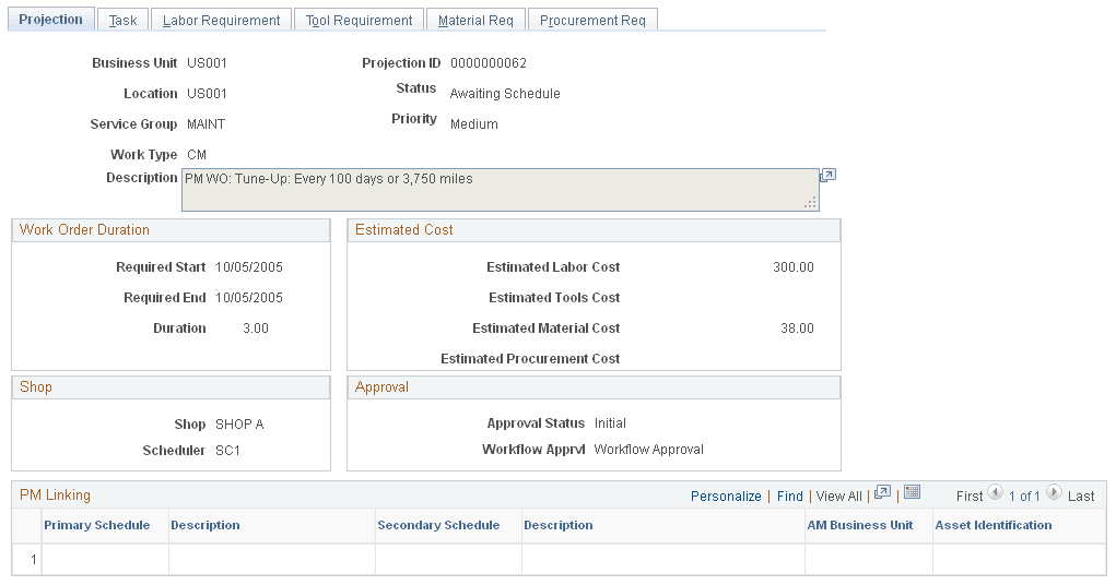

Use the Projection page (WM_PM_PJC_HDR) to review projection header information, including duration, estimated costs, shop, and approval statuses.
Navigation:
This example illustrates the fields and controls on the View Projection Detail - Projection page. You can find definitions for the fields and controls later on this page.
Projection
The Projection page presents a summary of the projection and the information that will appear in the work order's header.
This page also lists all of the linked PM schedules and their descriptions.
Task
Select the Task tab to view a list of projected work order tasks based on the job template that is associated with the PM Schedule that is used for the projection.
Select the General tab in the Project Tasks grid to review the task number, the duration, any task dependency, the overlap percentage, a crew ID if a crew was scheduled, and whether to calculate chargeback costs to another organization.
Select the Estimated Cost tab to review the projected estimated tools, material, and labor costs for each task in the projection.
Select the Asset Info tab to review the Asset Management business unit, asset ID, asset location, area ID, and whether the asset is functioning or offline for repair.
Labor Requirement
Select the Labor Requirement tab to review the labor requirements for each separate task, including a description of the task.
Select the General tab in the Requirements grid to review each line (row) within the task, which includes the craft, the quantity of labor needed, and the unit of measure that is used to calculate the estimated cost of labor.
Select the Estimated Cost tab in the Requirements grid to review each line's labor cost rate and bill rate (default value derived from the shop that is identified in the PM Schedule) and the calculated estimated labor cost and estimated billing amount for each line.
Note: Click the arrow in the right-hand corner of the Project Tasks group box to review the lines for the next task (if the projection included more than one task.)
Tool Requirement
Select the Tool Requirement tab to review the tool requirements for each separate task, including a description of the task.
Select the General tab in the Requirements grid to review each line (row) within the task, the asset type, subtype, manufacturer, and model characteristics of the tool along with the amount of tool usage.
Select the Estimated Cost tab in the Requirements grid to review each line's quantity of tools needed and the unit of measure, along with the tool cost rate and bill rate (default value from the asset type and subtype or from the shop that is identified in the PM Schedule) and the estimated tool usage cost and estimated tool usage billing amount, which are calculated for each line.
Material Requirement
Select the Material Requirement tab to review the inventory requirements for each separate task, including a description of the task.
Select the General tab in the Requirements grid to review each line (row) within the task that includes the Inventory business unit, the item, the quantity required, and the unit of measure.
Select the Estimated Cost tab in the Requirements grid to review each item's unit cost rate (default value specified in the item ID and derived from the work order task template that is associated with the job template in the PM Schedule) and the calculated estimated cost for each line.
Procurement Requirement
Select the Procurement Requirement tab to review the labor, non-inventory material, and tool requirements that must be procured for each separate task, including a description of the task.
Select the General tab in the Requirements grid to review each line (row) within the task that includes the resource type (labor, material, tools), the Inventory business unit, the item number, the quantity required, and the unit of measure.
Select the Estimated Cost tab in the Requirements grid to review the estimated cost, which is based on calculating the estimated unit cost based on the resource type times the quantity required.
Use the Search and Export Work Orders/PM Projections page (WM_MSP) to integrate preventive maintenance projections and work orders into Microsoft Project for analysis.
Navigation:
This example illustrates the fields and controls on the Search and Export Work Orders/PM Projections page. You can find definitions for the fields and controls later on this page.
Field or Control |
Description |
Name of Search |
Enter a name to identify a search to use to filter data for the work order, preventive maintenance projects, or both. You can enter the search criteria in the Work Order/ Projections Search group box before you enter a name to identify the search for future use. |
Save Search |
Click to save the identified search after you enter the search criteria to enable you to reuse the search criteria again without having to reconfigure the search criteria. |
Use Saved Search |
Select a previously saved search name and click the Search button to display the search results based on the criteria that are specified in the Work Order Projections Search group box. |
Work Orders/Projections Search
Enter the search criteria to list the projections, work orders, or both that you want to export to Microsoft Project.
Field or Control |
Description |
Source Code |
Select one of these values:
This is a required field. |
Business Unit |
Enter a work order business unit. This is a required field. |
Required Start From, To |
Enter a Required Start From and To dates. This is a required field. |
Service Group |
Select a service group that is associated with the work order or projections. This is a required field. |
Process Instance |
Enter the specific process instance in this field for the projections, which has a default value of 1. If this search is just for work orders, then the process instance default value of 1 is read-only. |
Status |
Select the status of the work order, projection, or both if you want. Statuses are user-defined values, which are based on required system-defined values. |
Work Order/PM Projections List
When you click the Search button after entering the Search criteria, a list of work orders, projections, or work orders and projections appears. You can select the items from the list that you want to export into Microsoft Project.
Field or Control |
Description |
File Name |
Enter a name for the file containing the selected projection, work order, or projection and work order data that you want to export into Microsoft Project. |
Export |
Click to insert the designated list of work orders and projections into the key fields of the WM_MSP_AEP_DATA table. An application engine process, WM_MSP_AE, exports the data into Microsoft Project. |
Process Monitor |
Click to monitor the WM_MSP_AE process. |
Use the Import Microsoft Project File page (WM_MSP_IMPORT) to import projection and work order data from Microsoft Project to Maintenance Management.
Navigation:
Maintenance Management, Work Order Management, Import From Microsoft Project
This example illustrates the fields and controls on the Import Microsoft Project File. You can find definitions for the fields and controls later on this page.
Field or Control |
Description |
File Name |
Enter the name of the Microsoft Project File that you want to import into Maintenance Management. You can only import selected work order data that you exported. You cannot import projections that you exported. |
