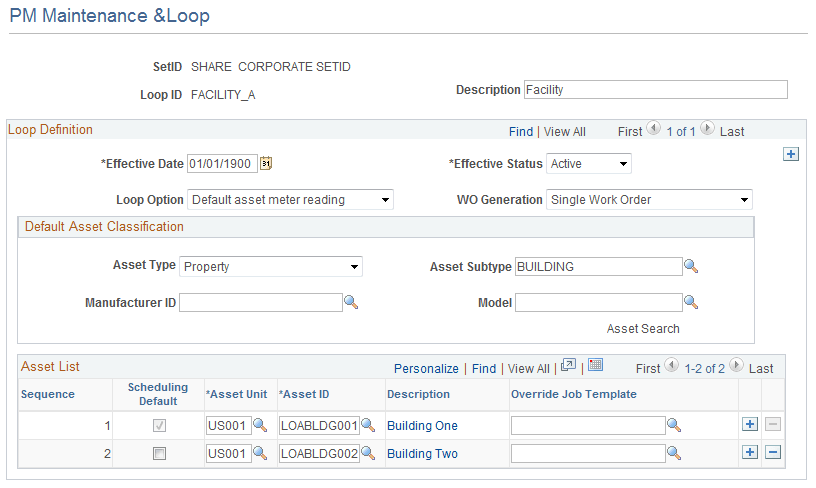

Use the PM Loop page (WM_PM_MAINT_LOOP) to create a preventive maintenance loop to perform routine maintenance tasks on groups of homogeneous assets or groups of heterogeneous assets.
Navigation:
PM Loop page
Loop Definition
Field or Control |
Description |
Effective Date |
Enter the date to create a preventive maintenance loop. |
Effective Status |
Select the status for the loop definition. It can be either Active or Inactive. |
Loop Option |
Select one of the two given options:
WO Generation |
Default Asset Classification
Field or Control |
Description |
Asset Type, Asset Subtype, Manufacturer ID, and Model |
Specify the asset classification values that are common to the homogeneous (similar) assets within the loop, such as Fleet and Auto. You must also select asset IDs for each asset that is listed in the Asset List grid for both homogeneous and heterogeneous (dissimilar) assets. The asset IDs that you select must either fall within these selected default asset characteristics, or be associated with an override template. If you select only heterogeneous asset IDs in the Asset List grid, and you select an override template for each asset ID, then you do not have to select any asset characteristics (asset type, asset subtype). Note: For homogeneous assets, you must, at a minimum, specify both asset type and asset subtype. If you also choose to identify a model, you must also identify the manufacturer ID. You cannot skip over a member in the asset category hierarchy. |
Asset Search |
Click to access the Asset Search page. Note: You must specify an asset type and asset subtype at a minimum to perform the search. |
Asset List
The Asset List grid lists the homogeneous (similar) assets that you copied from the Asset Search page. You can also select individual (heterogeneous) assets and their associated business units directly in the grid.
Field or Control |
Description |
Scheduling Default |
Select to indicate which asset's actual meter reading controls the scheduling of all of the assets in the Asset List. For example, if you have three different odometer readings for three cars, you must select one for the Preventive Maintenance Process to use to perform the calculations that are necessary to determine whether to create a work order. Note: The first asset in the list is selected by default. However, you can override this default and select the check box for another asset. You can identify only one asset as the scheduling default. |
Description |
Click to access the Asset Information page that contains details about the selected asset in the row. |
Override Job Template |
Select a work order job template to associate with each heterogeneous asset in the grid. This association with a work order job template is required for all heterogeneous assets in the Asset List grid. You must specify a job template in this field for any asset that has classification parameters that are different from the classification parameters that are specified on the loop header for homogeneous assets. You may optionally select a work order job template to associate with each homogeneous asset that is listed in this Asset List grid. If you specify a template here for a homogeneous asset, it overrides any template that is set up in the Loop Schedule. If this field is left blank for homogeneous assets, then the template that is specified in the Loop Schedule for this loop ID is used when the work order is created. |
