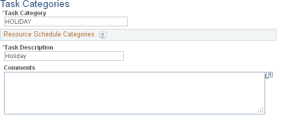

Use the Task Categories page (RS_TASK_TYPE) to distinguish between different types of tasks on a resource's schedule, for both informational purposes and in the Resource Matching Availability factor fit score calculation.
Navigation:
This example illustrates the fields and controls on the Task Categories page. You can find definitions for the fields and controls later on this page.
Field or Control |
Description |
Task Category |
Enter a category to apply to a resource's schedule such as Paid Time Off (PTO), Company Holiday, Corporate Event, Meeting, Training, and Appointment. You can add these to a resource's monthly calendar. Important! You do not set up work order tasks here. They are set up and assigned when you create a work order. |
Task Description and Comments |
Enter a description of this category and comments relevant to this task. |

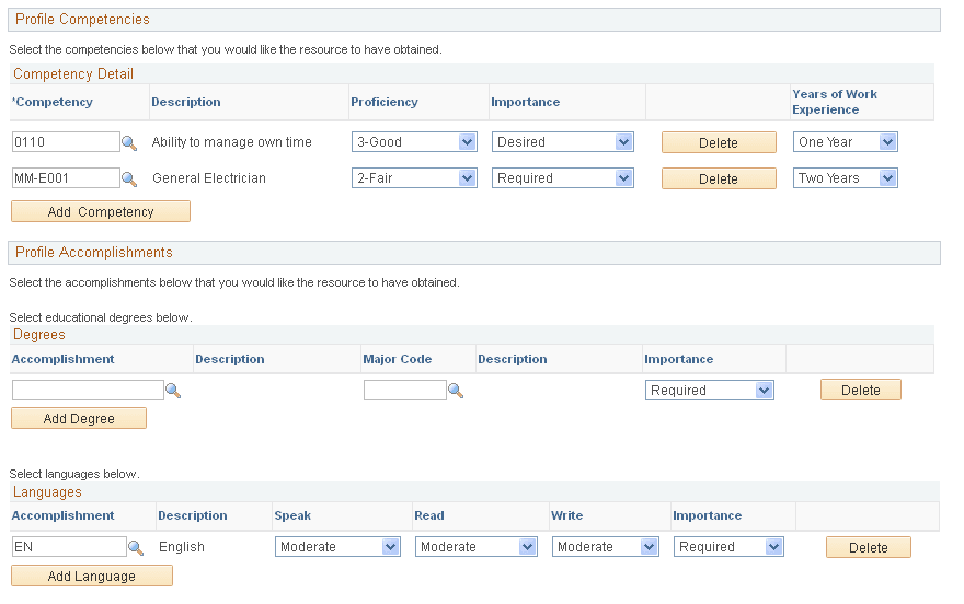

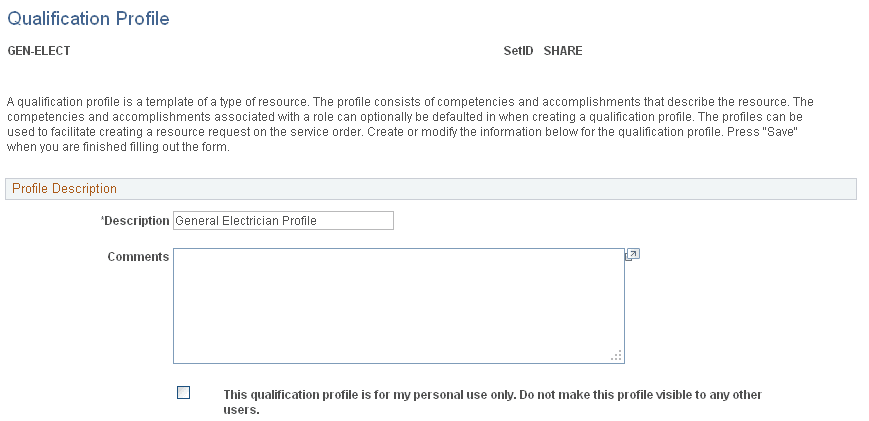

Use the Qualification Profile page (RS_RESRC_TEMPLT) to define generic competencies and qualifications in a template that may be accessed at the work order task level or may be associated with a craft which is identified at the work order task level.
Navigation:
This example illustrates the fields and controls on the Qualification Profile (1 of 3) page. You can find definitions for the fields and controls later on this page.
This example illustrates the fields and controls on the Qualification Profile (2 of 3) page. You can find definitions for the fields and controls later on this page.
This example illustrates the fields and controls on the Qualification Profile (3 of 3) page. You can find definitions for the fields and controls later on this page.
Enter a name for the qualification profile, such as a craft name like MECHANIC, ELECTRICIAN, or PLUMBER. Enter a description and any other comments relevant to the profile you are creating.
Field or Control |
Description |
This qualification profile is for my personal use only. Do not make this profile visible to any other users. |
Select the check box if you want to use this profile for personal use and not allow anyone else to see it. |
Profile Competencies
This grid enables you to select and add competencies to the profile. You can change the number of years of work experience required for each competency.
Degrees
Click the Add button to add a row to the Degrees grid. You can select and modify values for the Accomplishment, Major Code, and Importance fields.
Languages
Click the Add button to add a row to the Languages grid. You can select and modify values for the Accomplishment, Speak, Read, Write, and Importance fields.

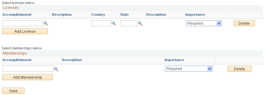

Licenses
Click the Add button to add a row to the Licenses grid. You can select and modify values for the Accomplishment, Country, State, Country, and Importance fields.
Memberships
Click the Add button to add a row to the Memberships grid. You can select and modify values for the Accomplishment and Importance fields.

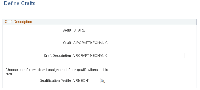

Use the Define Crafts page (RS_CFTSETUP_PG) to describe each type of craft and any qualifications associated with the craft to enable users to associate it with resources identified in the shop and in the work order.
Navigation:
This example illustrates the fields and controls on the Define Crafts page. You can find definitions for the fields and controls later on this page.
Field or Control |
Description |
Craft |
Enter type of craft to use to complete work orders such as electricians, mechanics, plumbers. |
Qualification Profile |
Select the qualification profile that describes qualifications that an employee needs to perform this craft. Note: When a craft is added to a work order task, then the competencies, accomplishments, and qualifications associated with the qualification profile selected here for the craft are copied to the work order task labor qualification requirements for that task. |

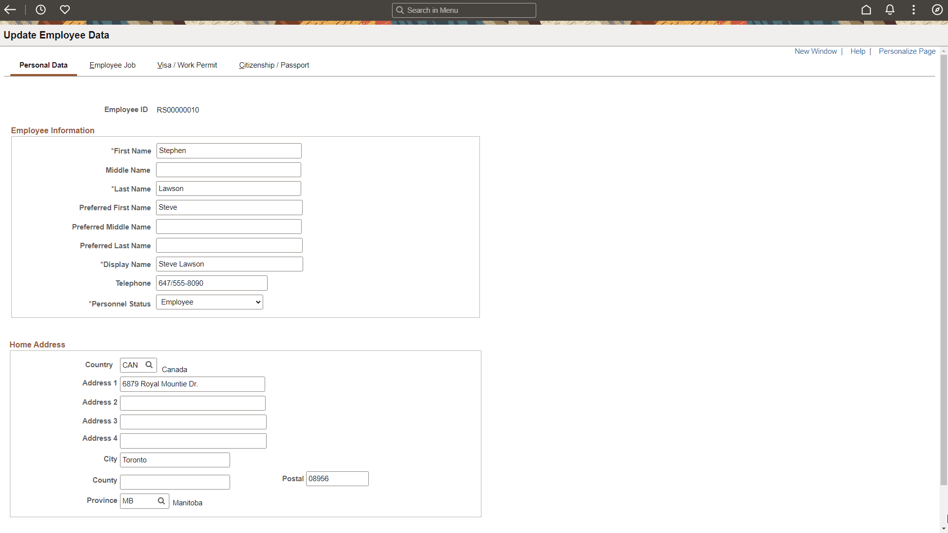

Use the Update Employee Data - Personal Data page (RS_CM_PERSONL_DATA) to add and update an employee's personal data such as address and phone number.
Navigation:
This example illustrates the fields and controls on the Updated Employee Data - Personal Data page. You can find definitions for the fields and controls later on this page.
Enter the employee's name, telephone number, and address information.
Note: If the page is display-only, then the information is sourced from the Update Employee Data: Personal Data Page in Resource Management.

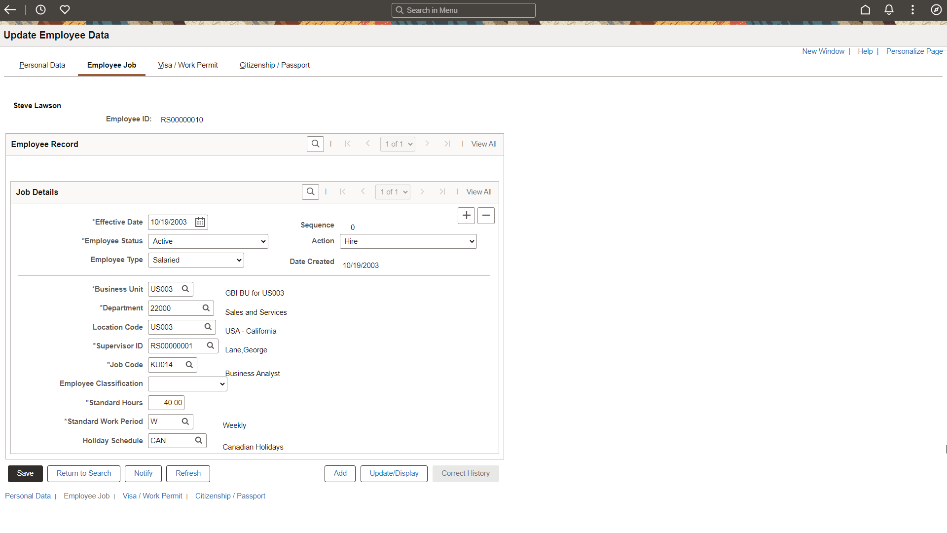

Use the Employee Job page (RS_CM_EMPL_JOB) to add and update an employee's job-related data such as supervisor and work phone.
Navigation:
This example illustrates the fields and controls on the Employee Job page. You can find definitions for the fields and controls later on this page.
Field or Control |
Description |
Effective Date |
Select the date that this data becomes effective in the system. You can add more than one job data record consisting of different data selected as job details for this employee. Effective Date, Employee Status, Business Unit, Department, Supervisor ID, Job Code, Standard Hours, and Standard Work Period are required fields. The asterisk (*) by a field means that it is required and that you must select or enter a value in the field. |
Important! You must refresh the Eligible Resource Cache table (RS_ELGBL_WRKR) when routine changes are made to a resource's job-related information.

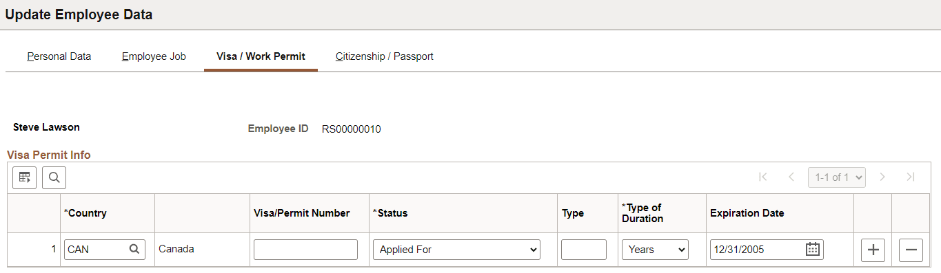

Use the Visa/Work Permit page (RM_CM_VISA_PRMT) to add and update any work permit and visa information for an employee.
Navigation:
This example illustrates the fields and controls on the Visa/Work Permit page. You can find definitions for the fields and controls later on this page.
Add as many rows as necessary of visa and work permit information for this employee.

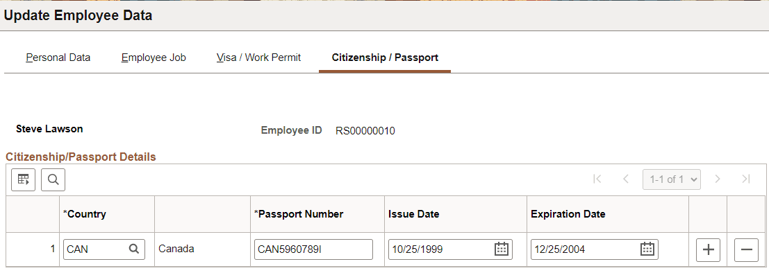

Use the Citizenship/Passport page (RS_CM_CITI_PASS) to add and update the citizenship and passport information for the employee.
Navigation:
This example illustrates the fields and controls on the Citizenship/Passport page. You can find definitions for the fields and controls later on this page.
Add as many rows as necessary of citizenship and passport information for this employee.
