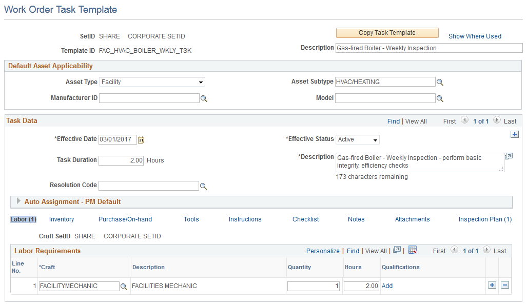

Use the Work Order Task Template page (WM_WO_TASK_TMPLT) to predefines work order data at the task (line) level for reuse in creating new work orders with equivalent work requirements.
Navigation:
This example illustrates the fields and controls on the Work Order Task Template Page. You can find definitions for the fields and controls later on this page.
Default Asset Applicability
Field or Control |
Description |
Asset Type, Asset Subtype, Manufacturer ID, and Model |
Select these classification parameters to indicate that this template is applied to Asset instances matching this specified category combination only. Asset Type and Subtype must be specified together. Also, if you specify Manufacturer ID or Model, then you must enter of all of the higher-level categories. |
Note: These fields are optional. If parameters are not selected, the template is considered to be non-asset related.
Task Data
Field or Control |
Description |
Effective Date and Effective Status |
Enter the date from which this template is either Active or Inactive. The selected effective date and status also apply to each of the requirements grids (Labor, Inventory, Purchase/On-Hand, and Tools), as well as instructions, checklists, notes, and attachments. When you copy a task template's data to a work order task, the system checks this effective date and status against the work order task's required start date. If the work order task does not have a required start date, then the current system date is used. Important! If the effective date on the work order job template does not coincide with the effective date on a work order task template that is added as a job step to the job template, the system will not copy this task to the work order. |
Duration (Hrs) (hours) |
Enter the overall duration of this task activity in hours and parts of an hour up to two decimal places. The unit of measure (hours) used here is hard-coded to match the unit of measure for the duration of a task in a work order. Note: You can override this field in the work order task. |
Description |
Enter a complete description of the task. This is a required field. |
Resolution Code |
Associate this task with a resolution code that most aptly applies to this task. This code is used for PCR tracking purposes and as a search value that is used to find an appropriate Task Template to copy to a work order. Note: You can override this value in the work order task. |
